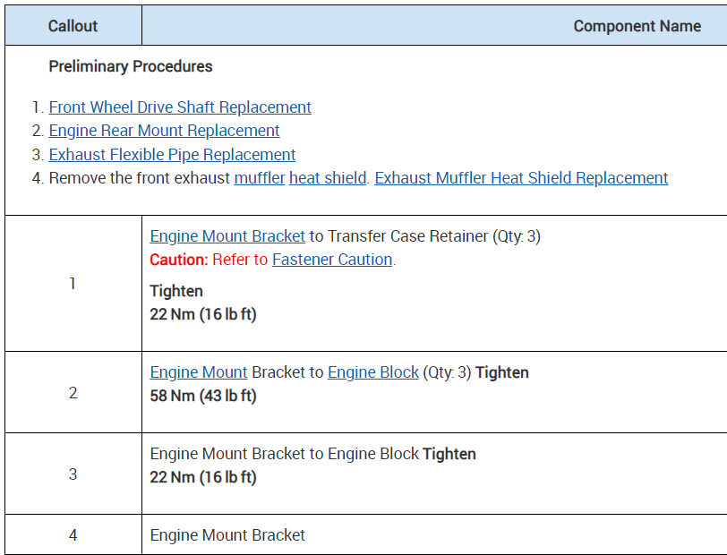

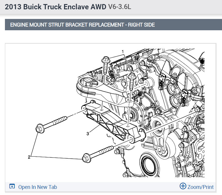

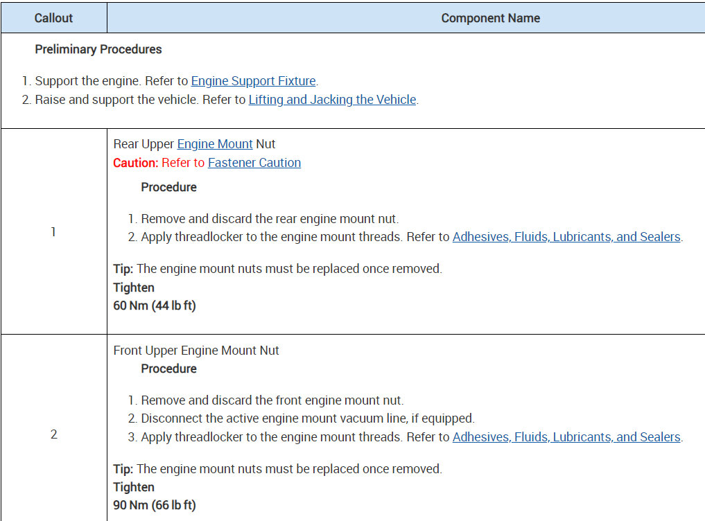

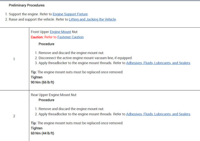

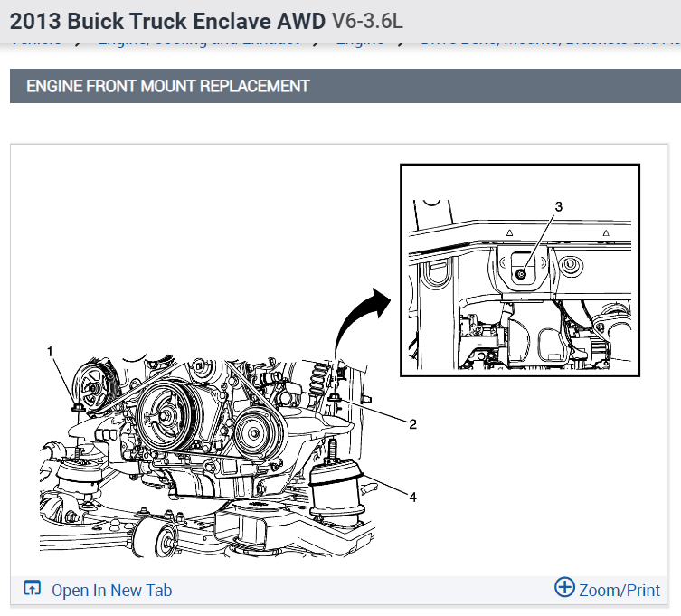

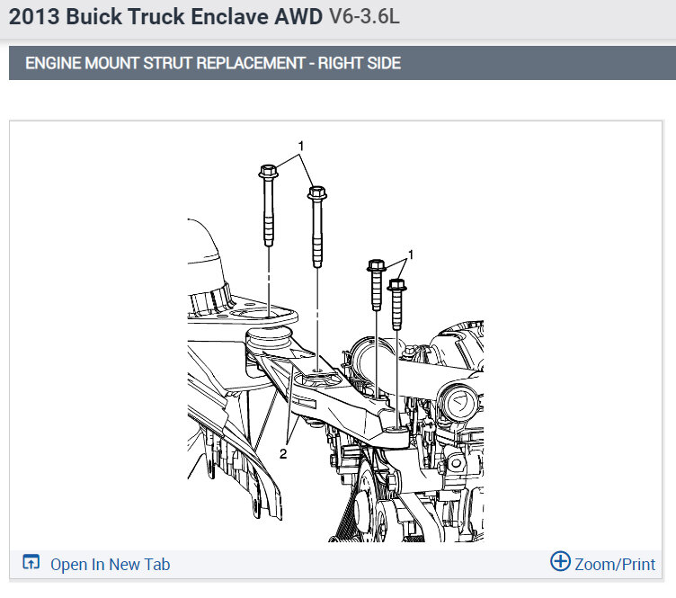

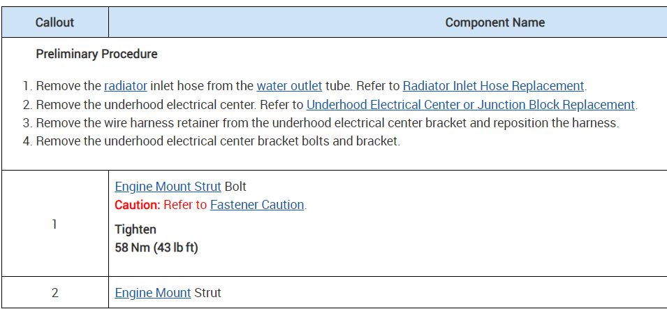

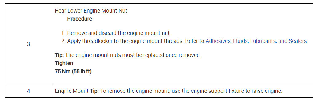

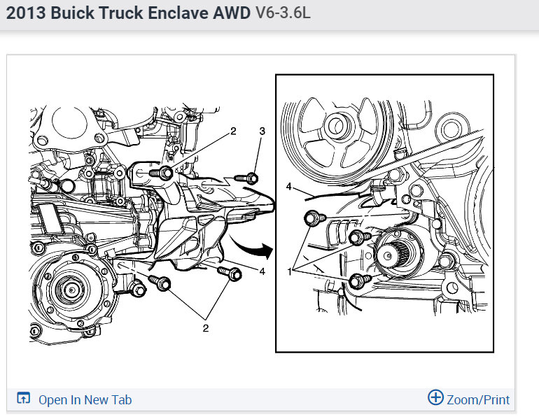

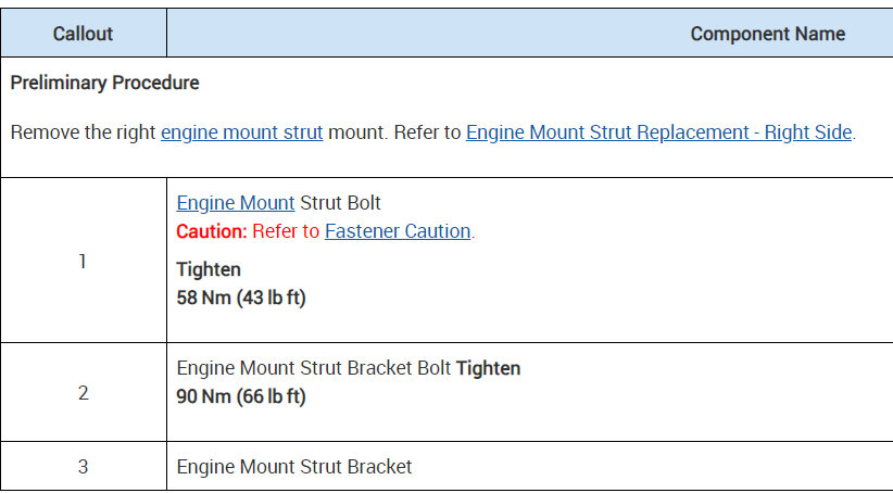

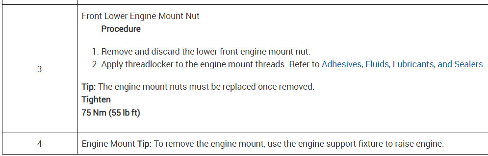

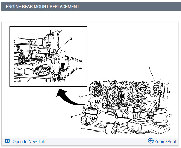

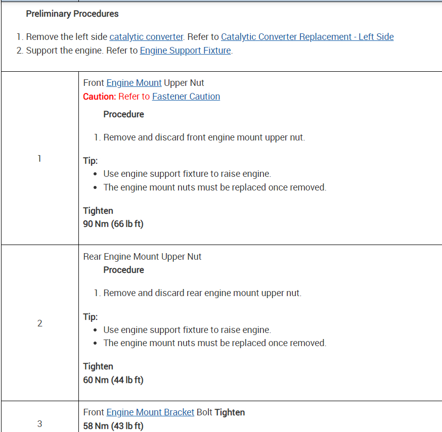

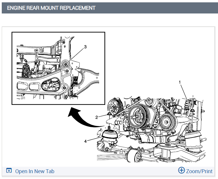

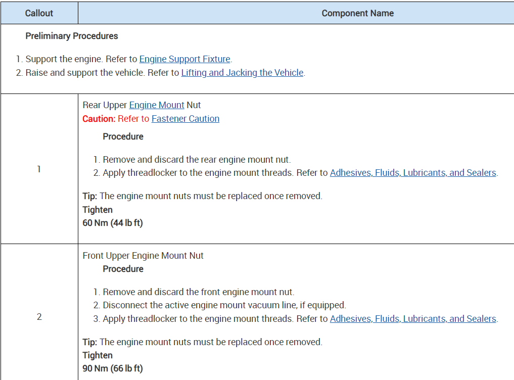

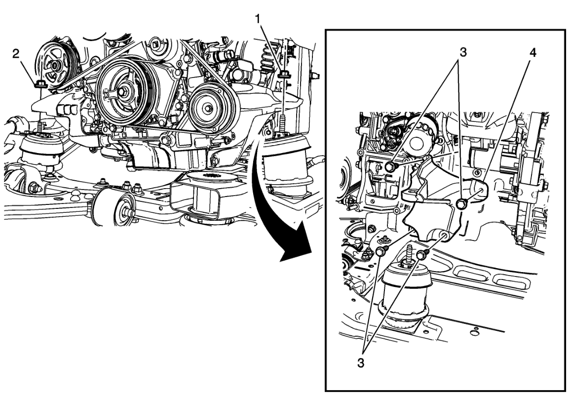

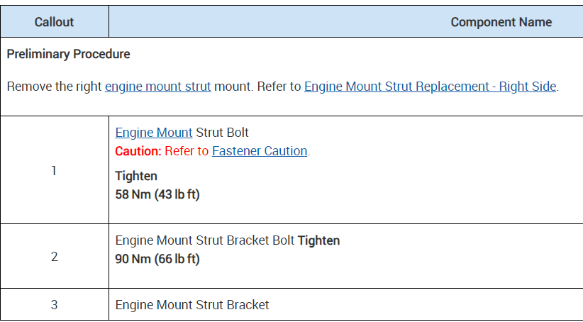

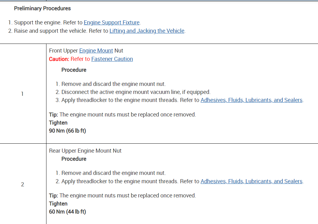

Just did a 15 Acadia FWD engine/transmission mounts. Is it the same for a 13 Enclave that is AWD?
Jan 8, 2024 at 9:29 AM
  • 55,710 POSTS
They are not exactly the same but very similar. Here are the instructions for the engine and transmission mounts with torque specs. Check out the images (below). Let us know if you need anything else. Make sure they support the engine with a floor jack while doing the mounts. Check out the images (below). Let us know if you need anything else.
