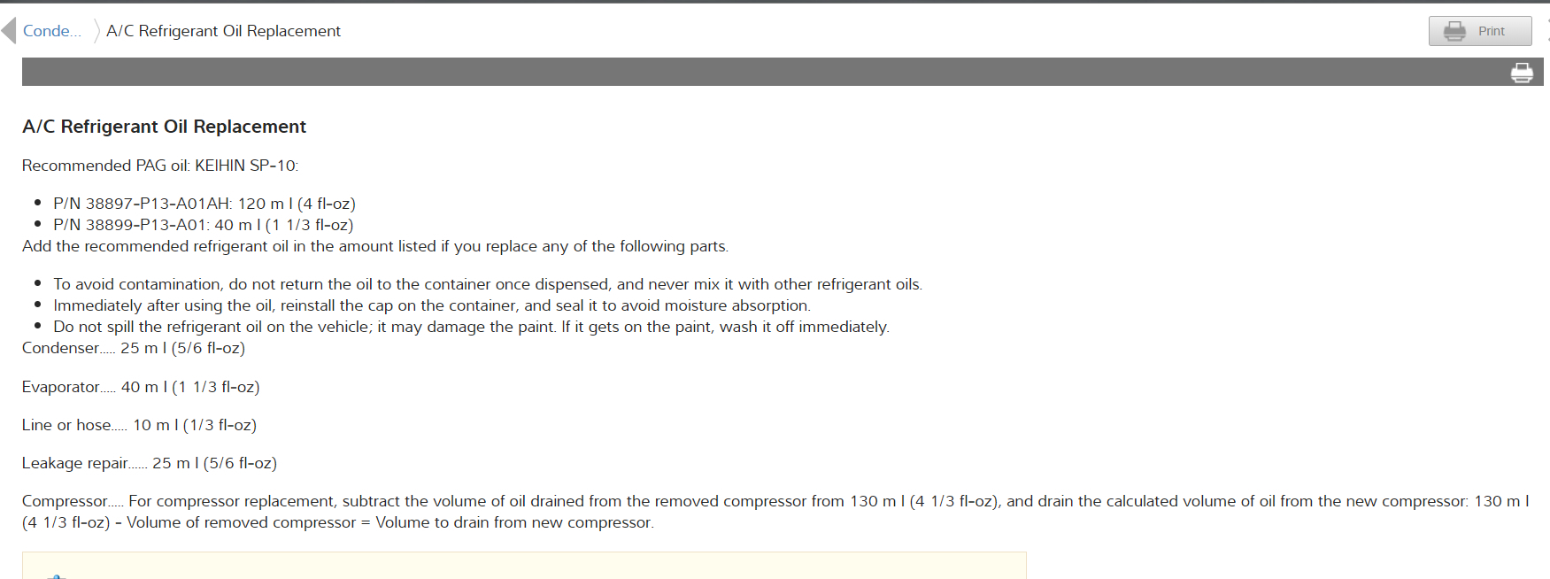

Changing desiccant bag on condenser
2004 HONDA CRV
220,000 MILES • 2.4L • 4 CYL • 4WD • AUTOMATIC
JSAMP51
Should I blow out the lines when I take it out?
Jul 18, 2018 at 2:22 PM
ROL*S.
  • 61 POSTS
Hi JS, are you changing desiccant bag because your car sat around with an open/damaged A/C system? If so, then yes, definitely blow out lines. But if not, you do not have to. And if you are also replacing condenser, you should add oil. There is an image added with recommended oil amount with part replacement. I also added an article that covers different subjects in A/C. https://www.2carpros.com/articles/how-a-car-air-conditioner-works
