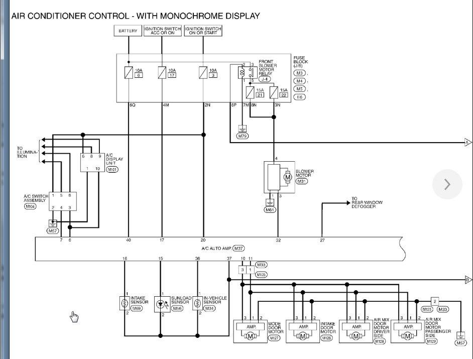

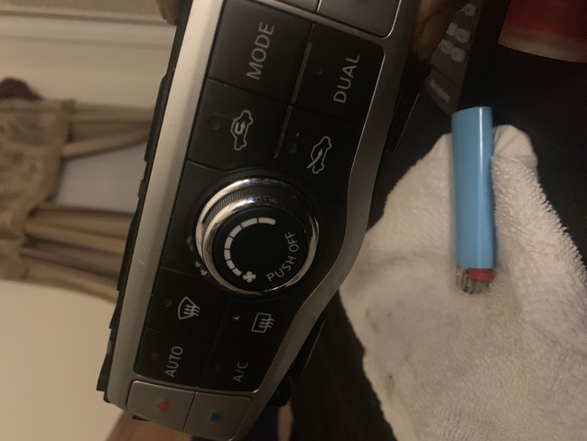

Wha wires I can reconnect to so I can have control of the air. Because of its different connector then my original one. I have the climate control on the radio panel want to change it so it could be under the amber sceen

27500 9n01a is the one I want to install. 2011 Nissan Maxima sv. No tech or navigation.
Oct 16, 2019 at 7:09 PM

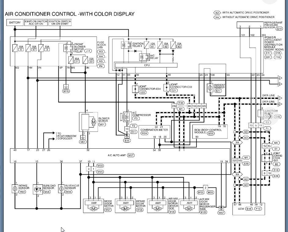

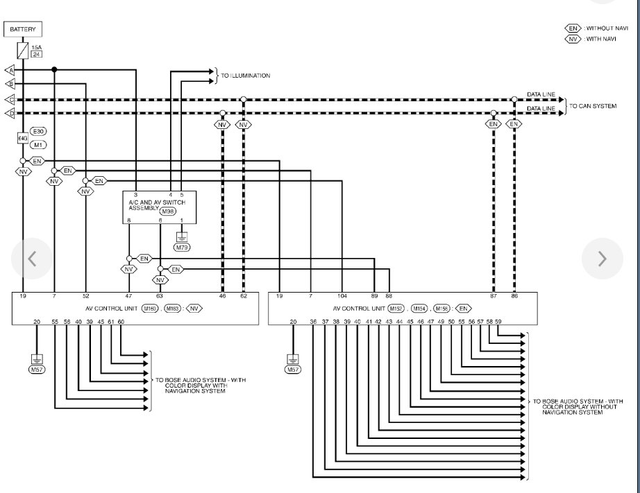

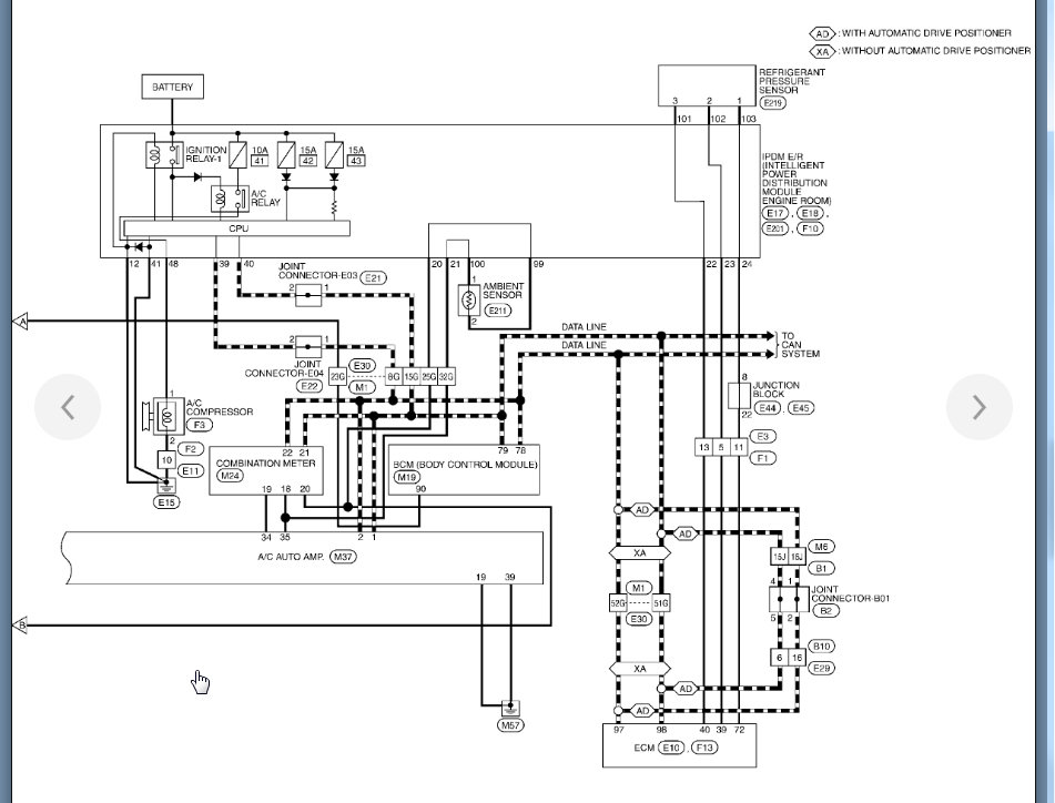

Okay. I understand now. Unfortunately this is not going to just plug in and work or even if you rewired it. You are more than likely going to have to change the wiring harness and have the sales codes changed by a dealer so that the other modules know that this is now different. I attached the wiring diagrams from each system. Clearly these are very different. The problem is your vehicle has what is called a CAN bus system. This means that each system shares its info with each other module so you will have to program the vehicle so that all other modules know what HVAC module is in the vehicle.
Sorry I don't have a better answer but I see this as being a large undertaking.
