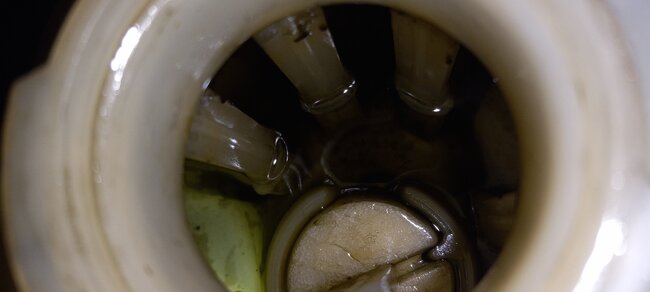

I need to replace brake fluid on this car. It seems pretty straight forward. Empty lines, master cylinder, refill new brake fluid, bleed brakes, top off cylinder. Is there anything else I need to be aware of or watch out for?

Absolutely. Do not empty the lines or let the reservoir run empty, especially if the car has anti-lock brakes. If air gets into the hydraulic controller, it can pool in two chambers, then require a helper and a scanner that can tell the computer to open two valves to allow the air to escape and be bled out. The procedure takes just a few seconds, but can be nearly impossible without the scanner, on most models.
Also be careful to not allow the slightest hint of a petroleum product to get into the fluid or touch any rubber parts that contact brake fluid. That can result in an extremely expensive repair that could exceed the value of the car. This includes engine oil, transmission fluid, power steering fluid, axle grease, and penetrating oil. Professionals even wash their hands with soap and water before handling brake parts that will contact brake fluid, to avoid getting fingerprint grease on them. If you have to poke the rubber bladder seal back into the reservoir cap, use a clean knuckle, or be sure there's no film of grease on your fingertip.
All manufacturers have a recommended service interval when they want the brake fluid to be replaced, but most people ignore that because the systems are so trouble-free. Over time, moisture works its way in. That promotes corrosion of metal parts from the inside, and it lowers the boiling point from well over 400 degrees Fahrenheit to closer to 212 degrees. Under normal braking, the brakes can get hotter than 212 degrees. That heat will migrate into the brake fluid where the moisture will boil and vaporize, leading to one form of brake fade.
The best procedure is to use a clean turkey baster to suck out as much old brake fluid as possible from the reservoir, then refill it with fresh, clean fluid from a sealed container. Open one bleeder screw at a time and let that circuit gravity-bleed. If you start with the left front brake, you'll get new fluid coming out before the reservoir runs empty. Close that bleeder screw, refill the reservoir, then go to the next wheel. During the bleeding, leave the reservoir cap slightly loose so no vacuum builds up that would impede the free flow of fluid.
If it should get away from you and the reservoir runs empty, don't panic, and don't try to run that air down to the wheels. Rather, just fill the reservoir again, then stroke the brake pedal just an inch or two a few times. That will push fluid down the lines and let the air bubbles float back up. As you release the pedal, air bubbles will wash up into the reservoir.
Also, during any brake work, be careful to never push the brake pedal more that halfway to the floor. Crud and corrosion build up in the lower halves of the bores in the master cylinder where the pistons don't normally travel. Pushing the pedal to the floor, as even many experienced mechanics do, runs the rubber lip seals over that crud and can rip them. That causes a slowly sinking brake pedal, and it commonly takes two or three days to show up. This doesn't apply to a new or rebuilt master cylinder that's less than about a year old.
When you're done, fill the reservoir to the same level it was at when you started. Don't fill it to the "full" mark unless the brake pads are fairly new. As disc brake pads wear, the pistons move out of the calipers to self-adjust. Brake fluid fills in behind those pistons, so the level in the reservoir will go down. Lately, calipers seem to not need to be rebuilt during a routine brake job, so we just push the pistons back in to make room for the new, thicker pads. Doing that pushes the brake fluid back up into the reservoir. If someone topped off the brake fluid before that, it is going to overflow, making a mess. Brake fluid eats paint too, so wash it off right away with water.
For the last step, I like to wash out the closed bleeder screws to get the brake fluid out of them. If you removed rubber caps from the screws, put those back on after the Brake Parts Cleaner has evaporated. When bleeder screws get rusted tight, it is not from water getting into the threads. It is from water going down the center hole, then forming rust through the small hole. Brake fluid left in the screw causes that rust to develop much faster.
Let me know if that answers your questions. Keep me updated on your progress.

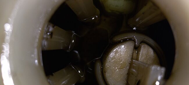

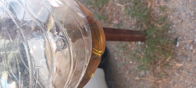

Forgot to mention, brake fluid gets dark from being hot, so color alone isn't something to worry about.

There is hard reddish chunks in the bottom of my fluid catch. So this could lead to the dragging feeling?

There shouldn't be chunks in the old fluid. I don't know where those could come from.

Bubbles in the reservoir mean the air is working its way out of the main bore and lines. That is far more desirable than having to push those bubbles all the way down to a wheel.
If you can grab a piece of that debris and rub it between your fingers, then it dissolves into nothing, it is residue that has built up over time and is breaking off now.
