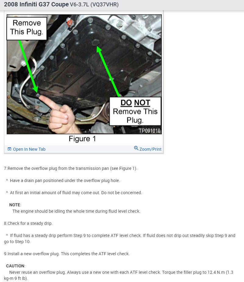

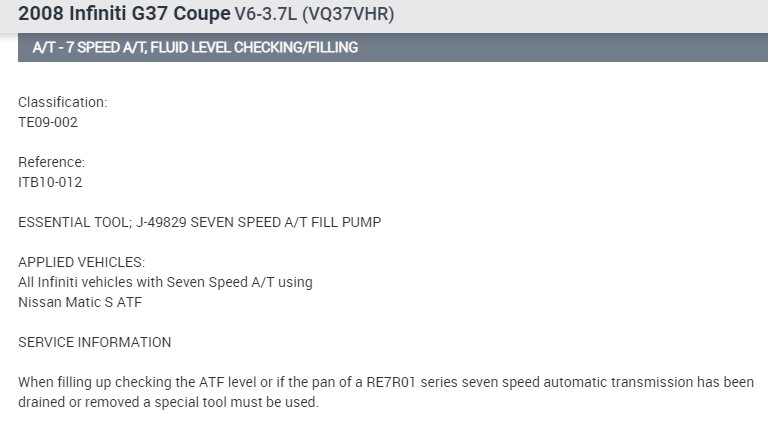

Can you please help with instructions and the type of fluid needed?
Jan 12, 2022 at 12:14 AM
SQM
  • 6,383 POSTS

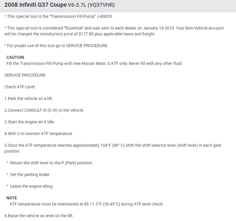

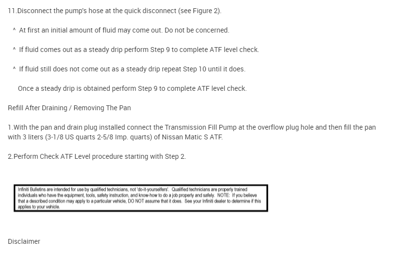

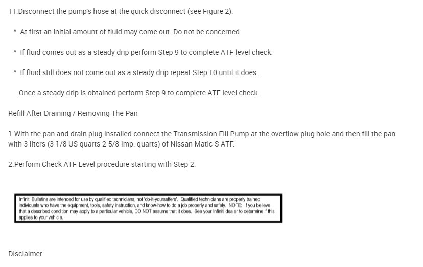

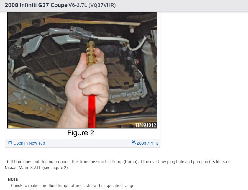

I have attached the procedure below.

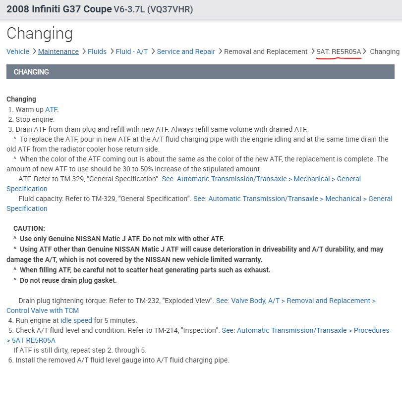

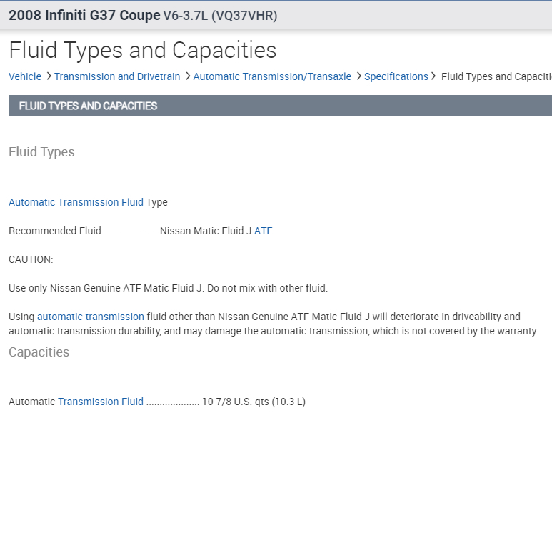

This should use 10.75 quart of fluid as the total capacity.
The fluid is Nissan Matic Fluid J.
Is this a 5 or 7 speed automatic?

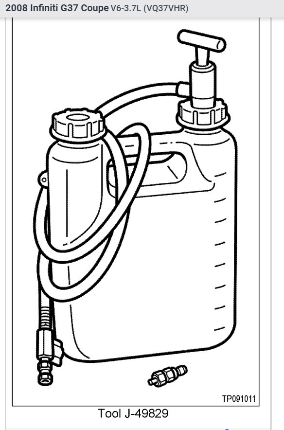

You might need a fluid pump to do the change on the 7 speed.
Let me know of any questions.

If it has the manual selector lever, see what is the highest gear it allows you to engage. Typically, there is a display showing the gear. You will have to drive it to go through the gears though.
Jan 12, 2022 at 12:49 AM
DIVIDES
  • 903 POSTS
It gies up to 5. Can i use the matic-s? Instead if j?
Jan 12, 2022 at 2:17 AM
SQM
  • 6,383 POSTS
Yes. On the 5 speed automatic it is the Nissan Matic S.
