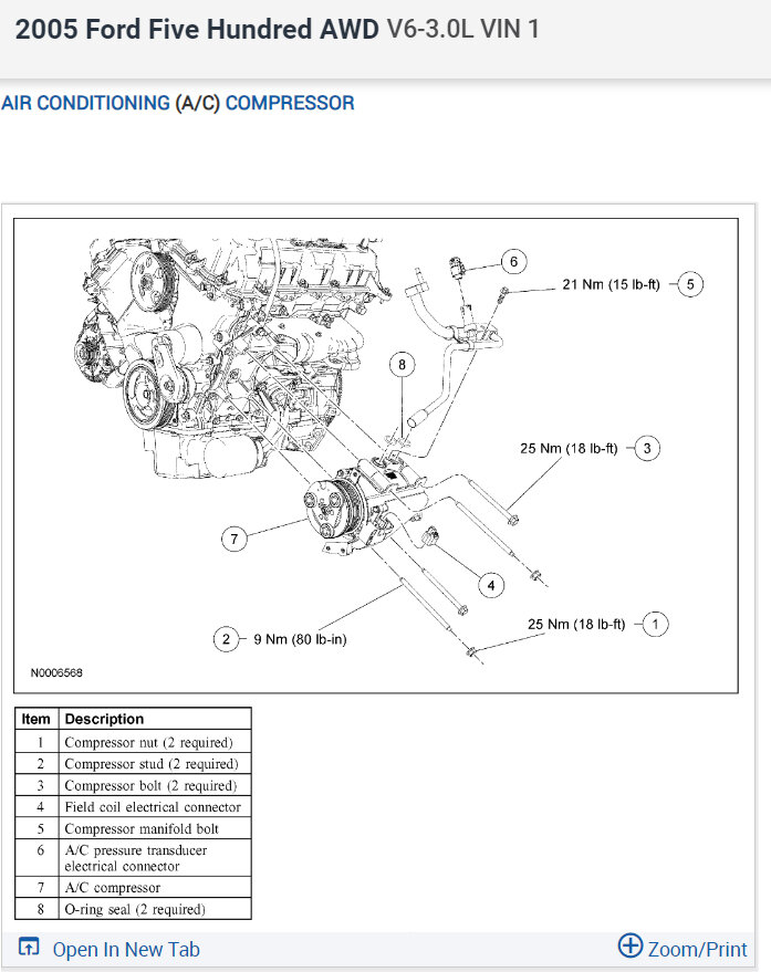

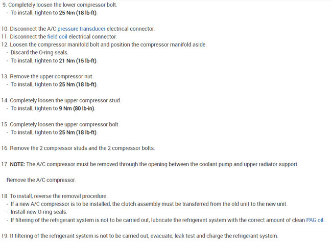

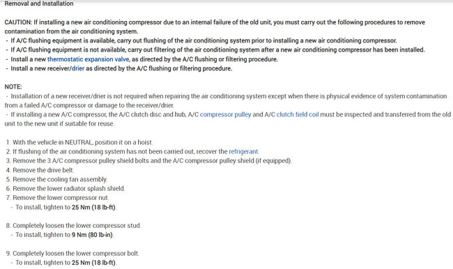

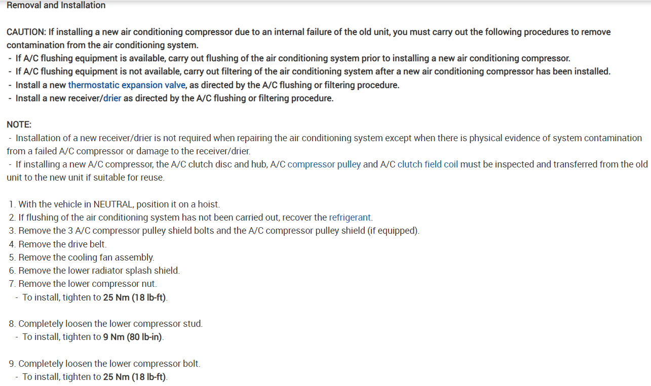

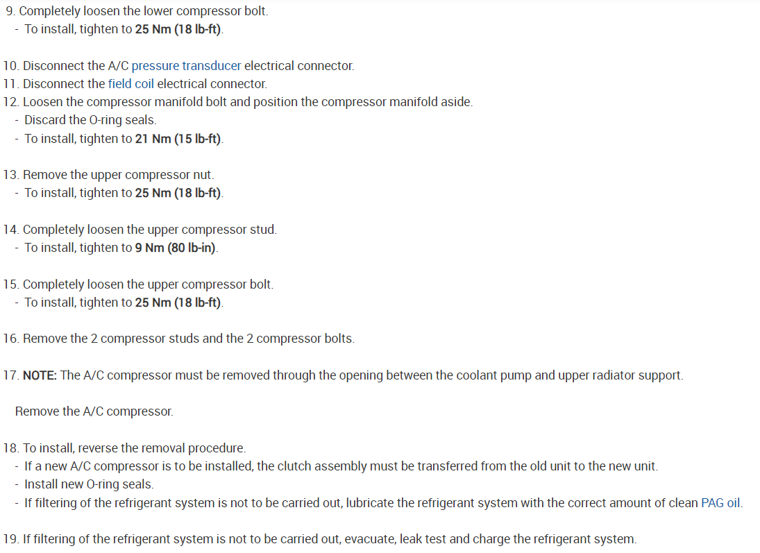

I need to change my A/C compressor on my car listed above. It is out of freon so that's not an issue. Is there anything else I need to be aware of? Also, any links that might be helpful thanks.
Oct 16, 2024 at 7:10 AM
  • 55,433 POSTS
Yep, we can help, here is a generic guide to help you step by step with instructions in the diagrams below to show you how on your car. Also, this is a great video on how to vacuum down and recharge the system:
https://www.2carpros.com/articles/replace-air-conditioner-compressor
Here is the video:
https://www.youtube.com/watch?v=4EqdrBVb0sY&t=55s
Here are the instructions for your car on how to change out the ac compressor. Check out the images (below). Please let us know what happens.

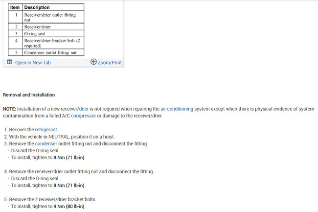

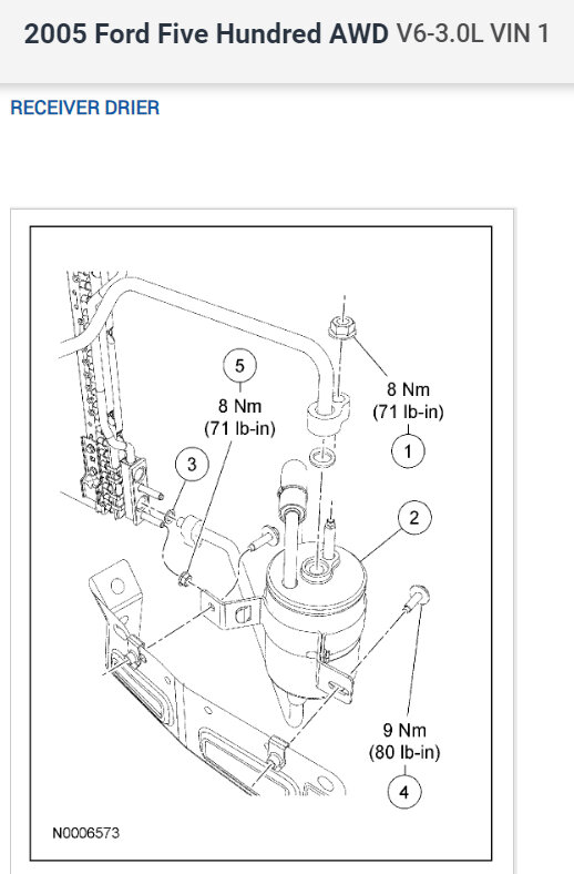

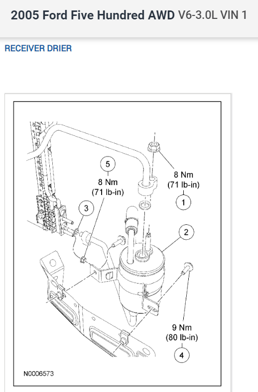

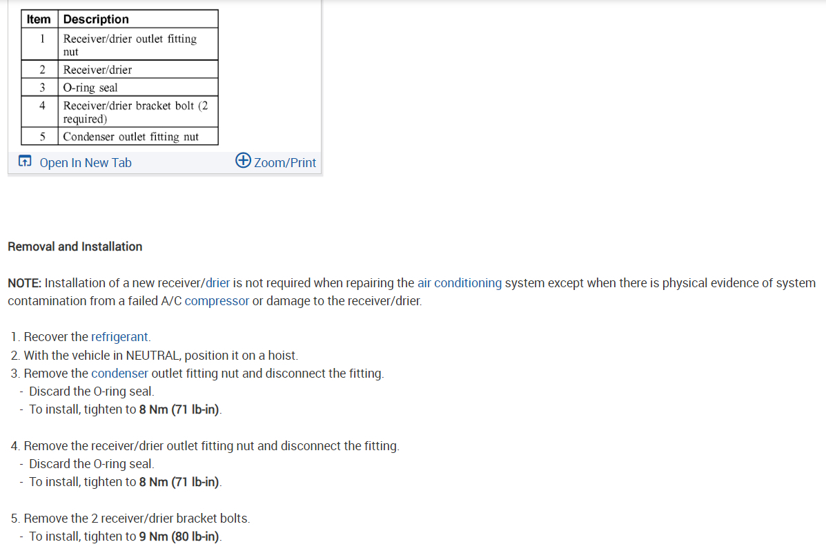

Hey, this is what I'm replacing with it's got the dryer and something else as well. Do the links cover those parts? Thanks
Oct 16, 2024 at 4:40 PM
  • 55,433 POSTS
No just the compressor, here is how to replace the dryer. Check out the images (below). Let us know how it goes.
