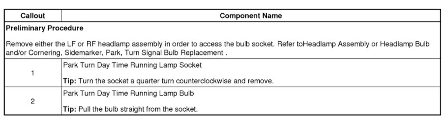

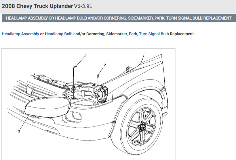

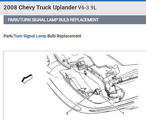

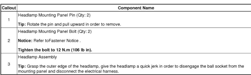

I can't figure out how to get to front turn signal bulb?
Nov 30, 2015 at 3:31 AM
DANNY L
Experienced Mechanic
5,648 POSTS
Hello, I'm Danny.
You will need to remove the headlamp assembly to gain access to the turn signal bulb. Here is a tutorial showing how to change a bulb:
https://www.2carpros.com/articles/turn-signal-bulb-replacement
I've attached picture steps below on how to remove and replace the headlamp assembly and turn signal bulb. Hope this helps and thanks for using 2CarPros.
