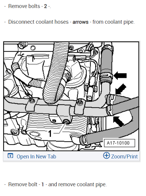

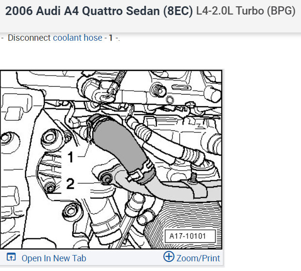

You should be able to change the hose yourself with basic mechanic's tools, I would drain the cooling system first and disconnect the battery to avoid accidentally short circuits. If you could unload an image of the hose i can walk you through the repair step by step. Here are images of the heater hoses please let me know which one is leaking. Check out the images (below). Please upload pictures or videos in your response of any problems so we can see what to help you with.

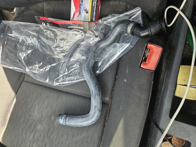

This is what the pipe mechanic gave me looks like. Because they don't have the time to replace it.
