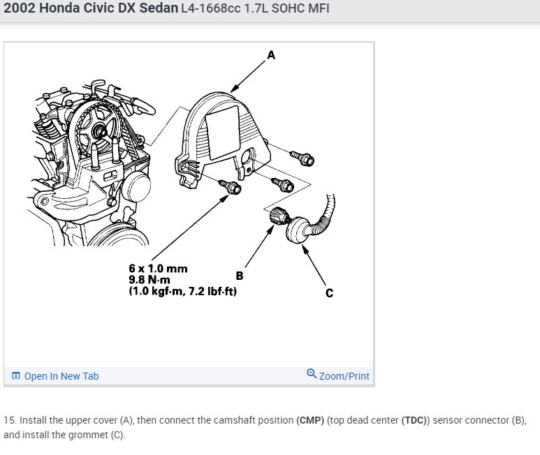

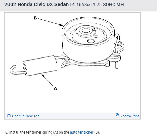

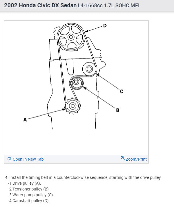

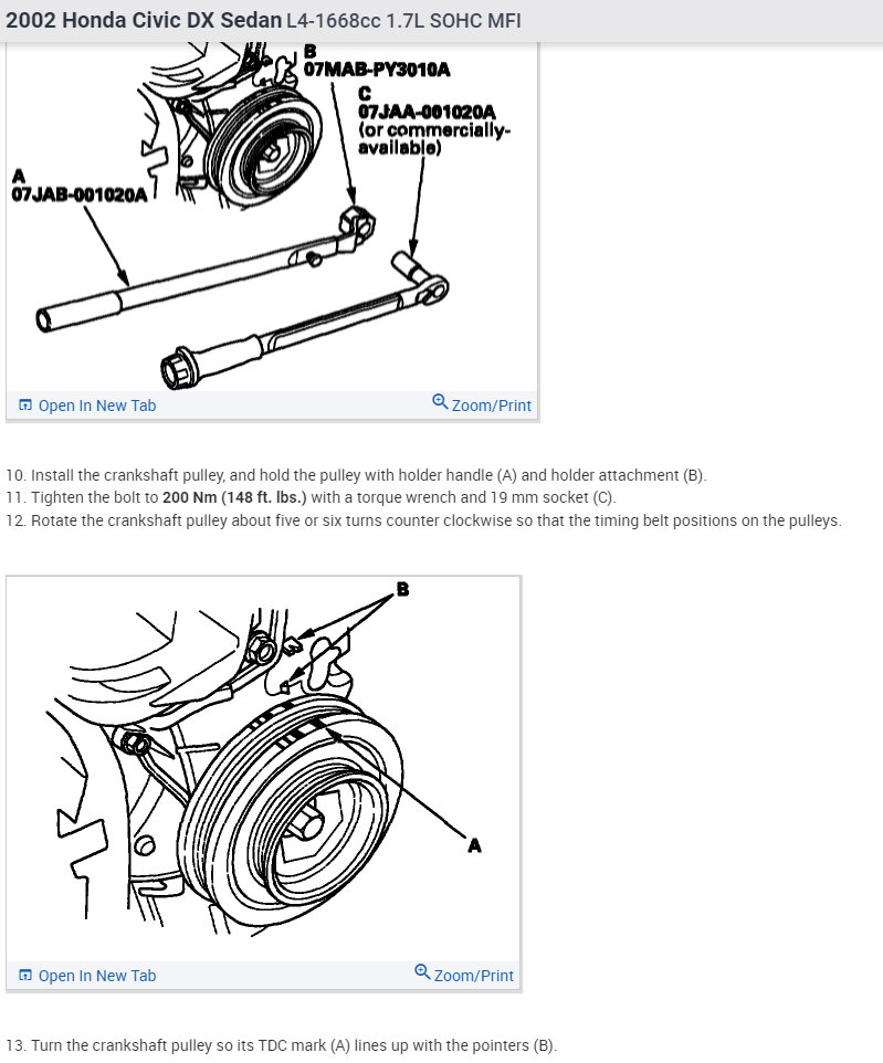

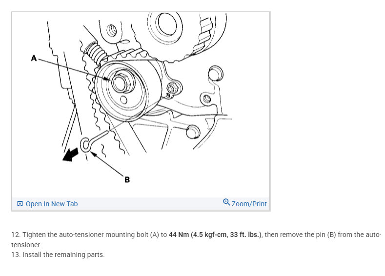

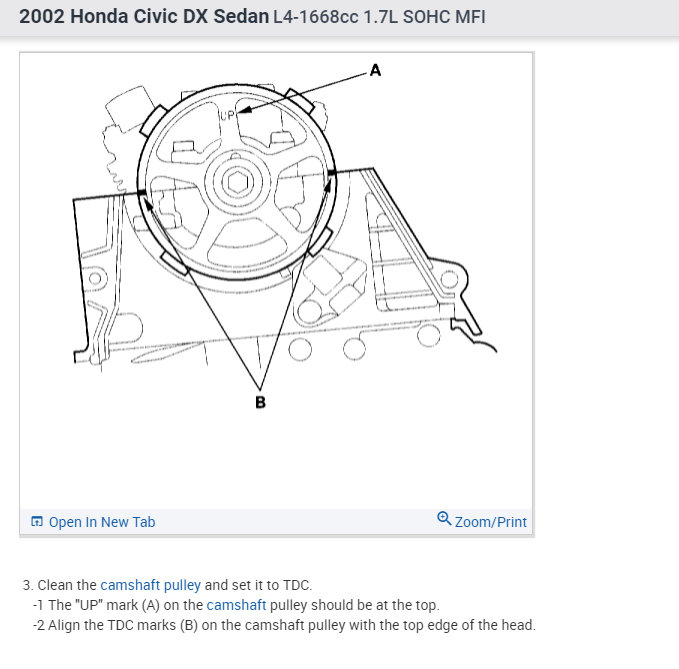

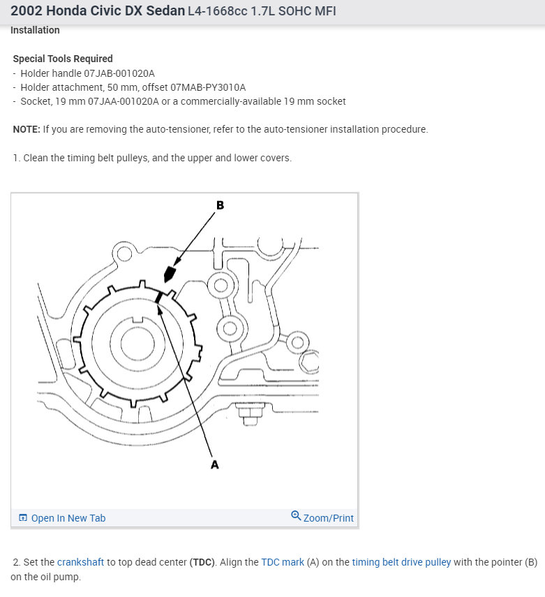

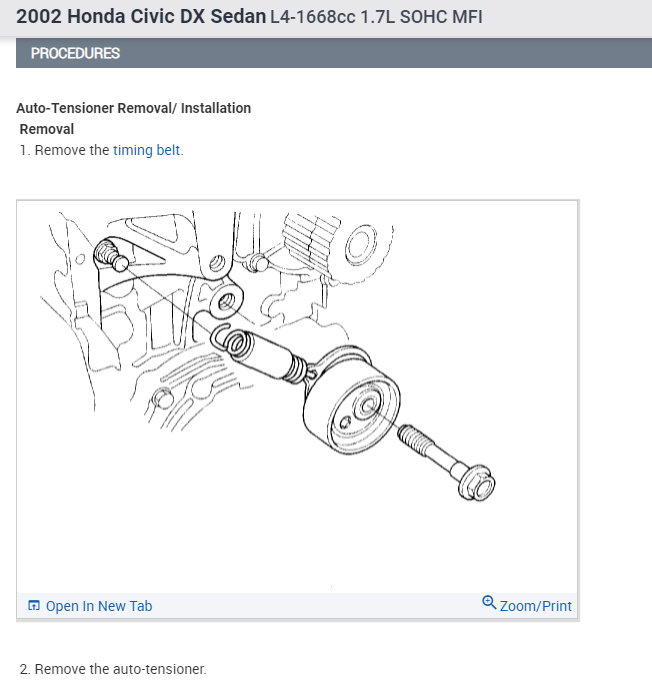

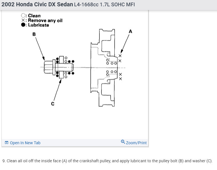

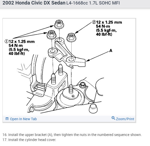

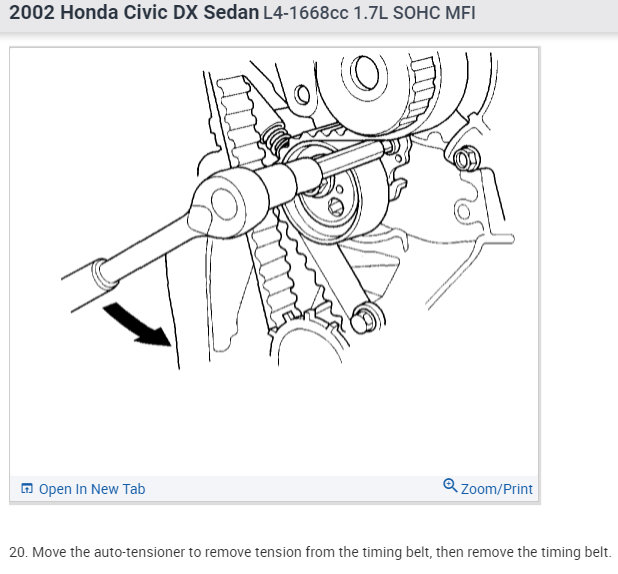

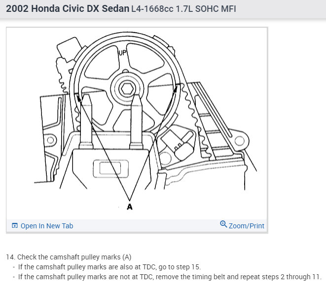

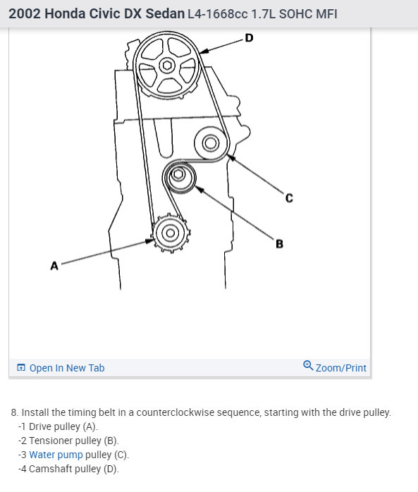

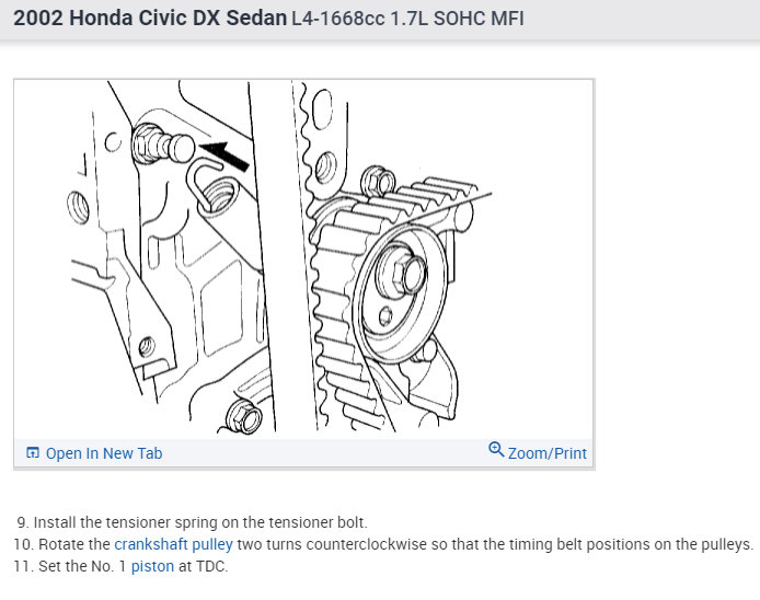

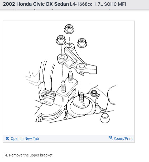

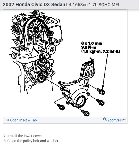

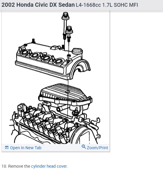

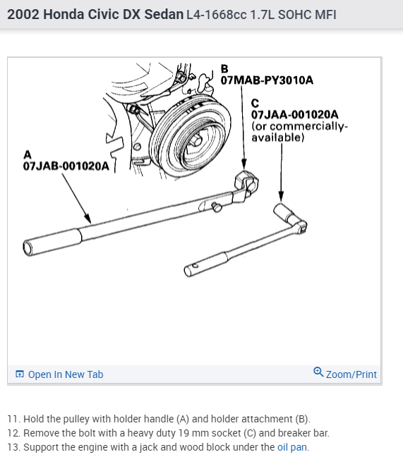

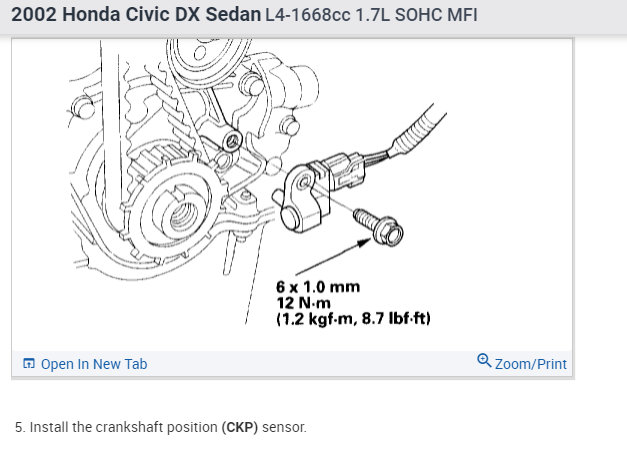

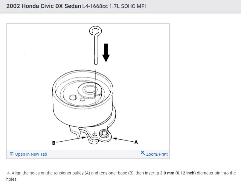

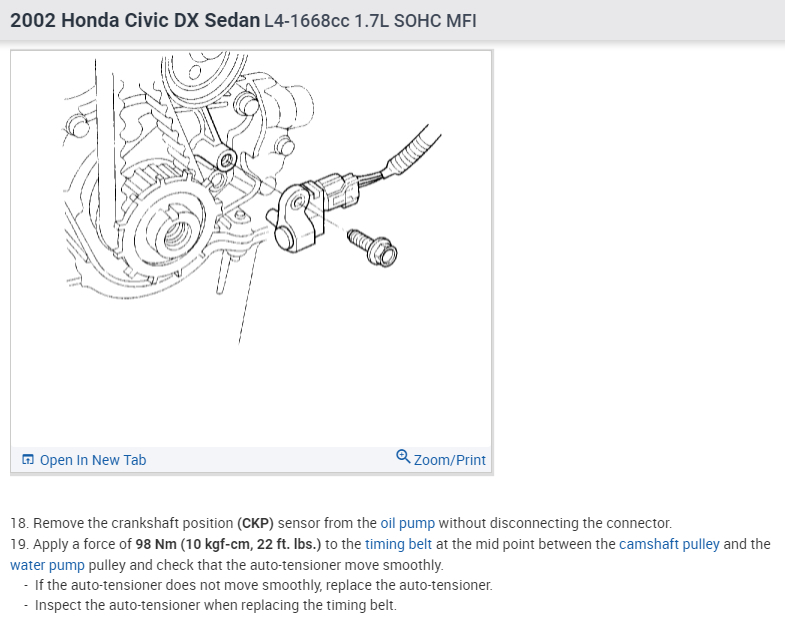

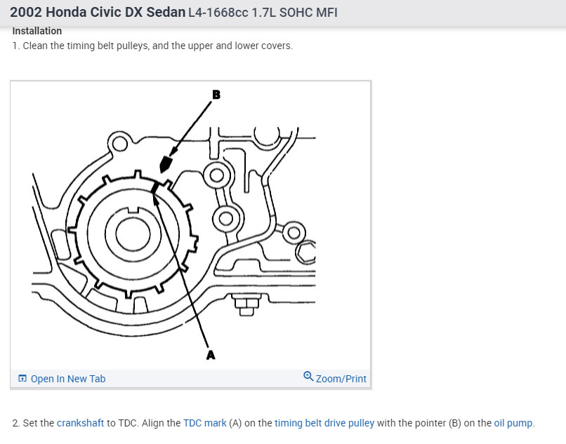

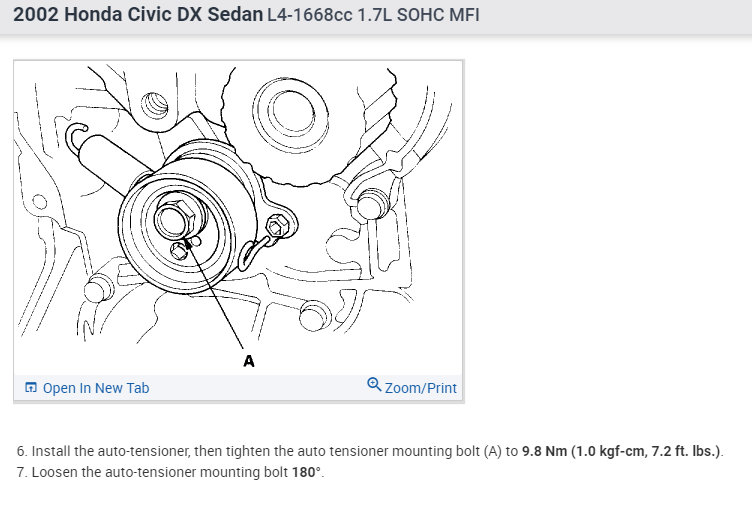

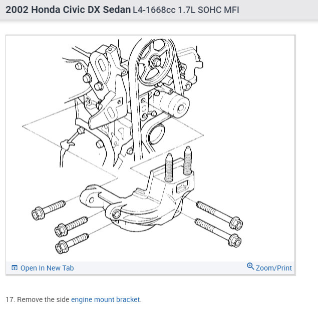

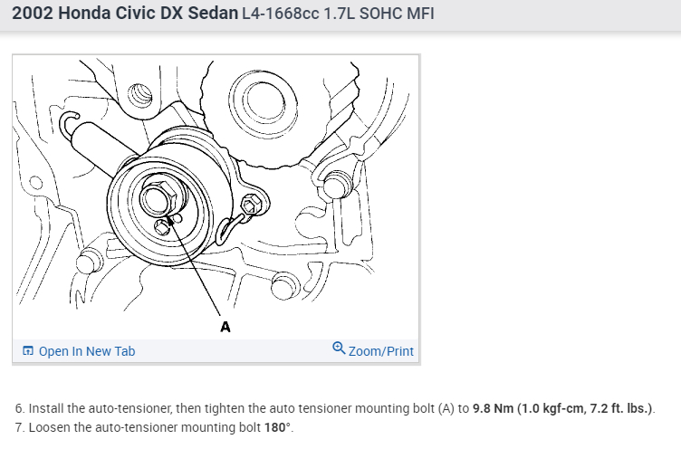

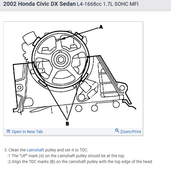

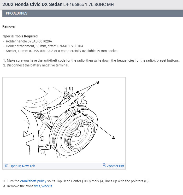

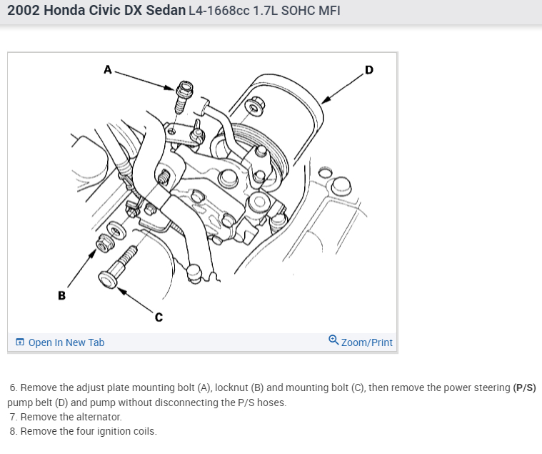

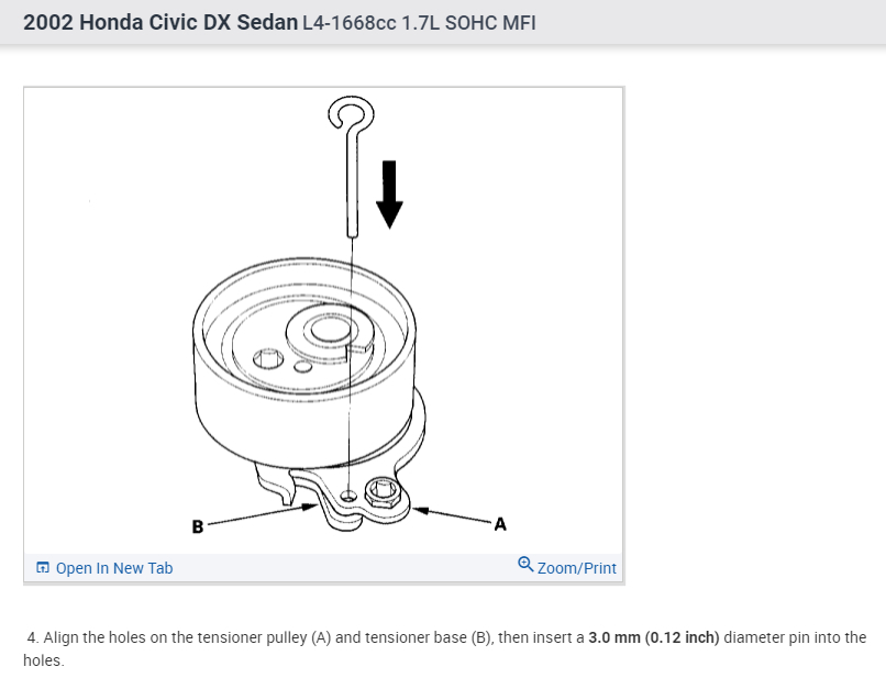

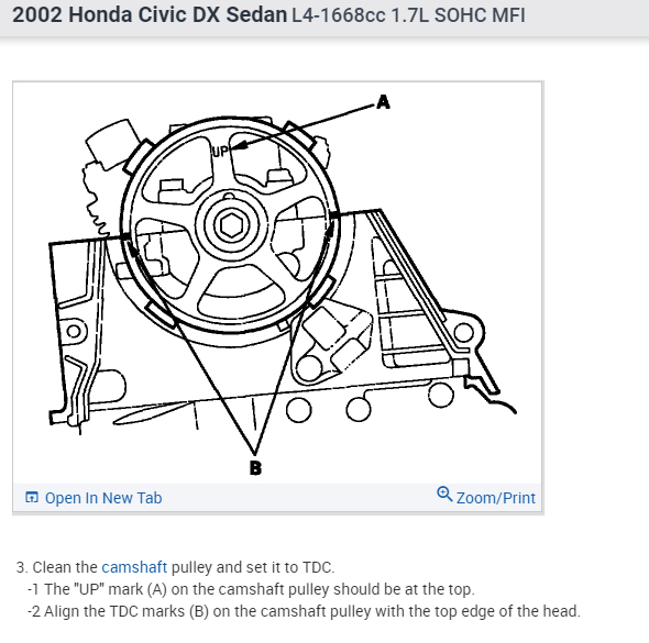

I did a head gasket and timing belt with water pump and tensioner. I started it and ran fine. shut off and started again but belt jumped two teeth on belt. Why did I do something wrong on the tensioner?
Jan 8, 2022 at 10:36 PM
SQM
  • 6,383 POSTS

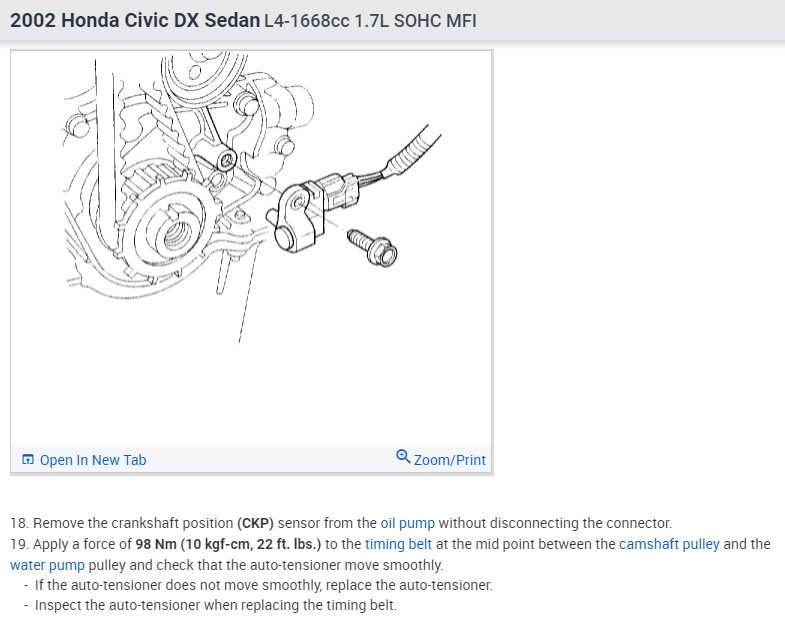

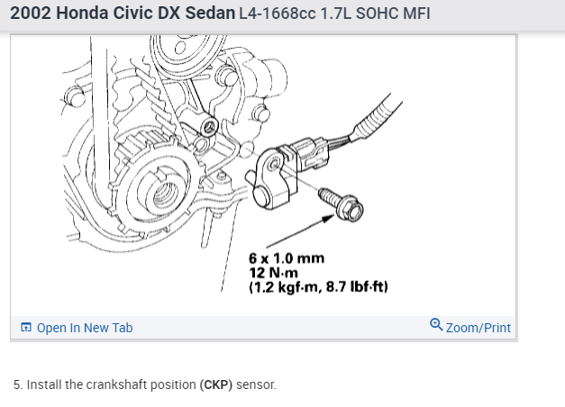

If it is not torqued or aligned properly or having a defective component can lead to a jumped tooth.
If the tension is not putting proper tension this can happen as well.

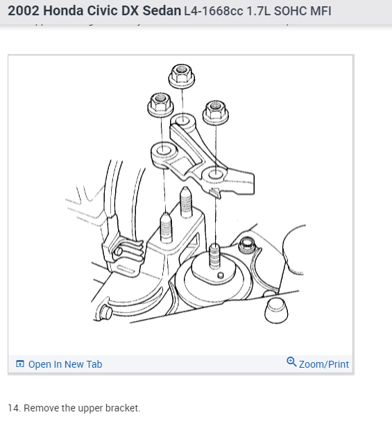

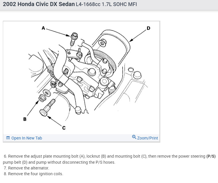

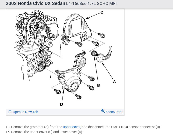

I have attached the complete replacement procedure for the timing belt as well as the tensioner below. Take a look and go through the steps to see if you might have overlooked something.
And always keep in mind that faulty components can many times play a critical part, rather than a procedure issue. But you first want to make sure all the steps are done properly.
Let me know if you have any questions.
