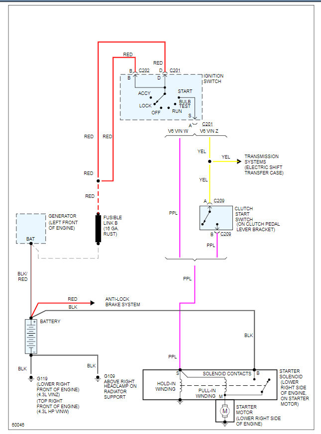

Nothing cranks, nothing turns, no fuel pump or lights
ASH2DUST
  • 1994 CHEVROLET BLAZER
  • 4.3L
  • 6 CYL
  • 2WD
  • 1,500,000 MILES
Everything is hooked up according to diagrams. Main power is live. Nothing cranks, nothing turns, no fuel pump or lights. Checked the basic fuses cannot find the short nor disconnect.
Sunday, March 15th, 2020 AT 12:12 PM
I attached the wiring diagram. Can you let me know what voltage you have on both red wires at the ignition switch and then what the voltage is on the wire coming out of the switch when in the on position?
If all we did was change the ignition switch then we have to be overlooking something so let's start at the beginning.
Let me know and we can go from there. Thanks
