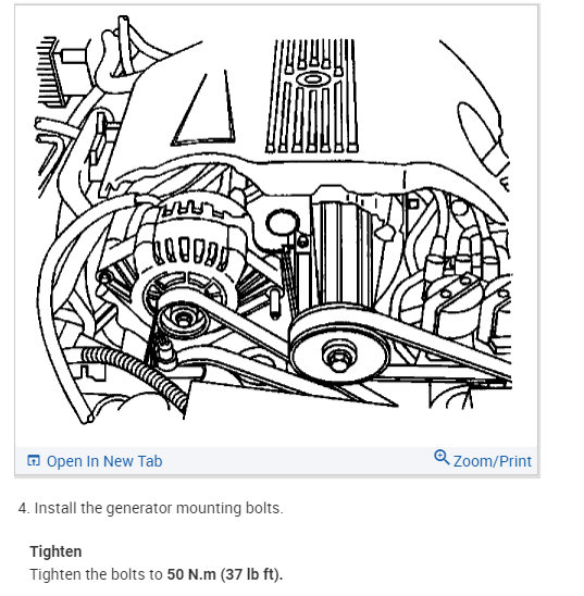

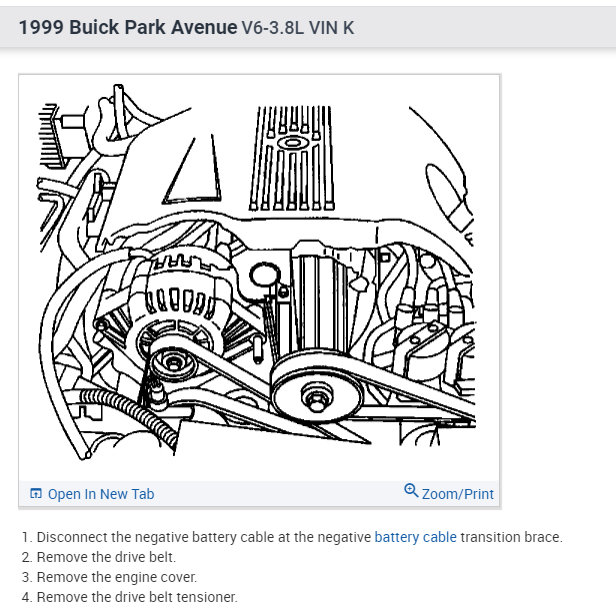

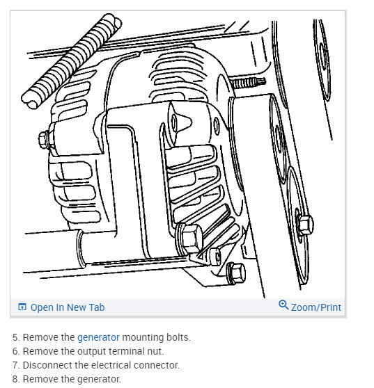

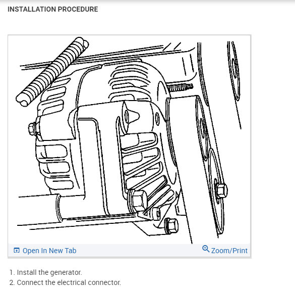

Today's vehicles are very reliant on voltage. If it gets low, it affects a lot of different things. As far as just replacing it, I would have them bench tested to confirm one or the other is bad. I wouldn't want you to spend money unnecessarily.
I attached the directions for replacing the alternator specific to this vehicle below. Make sure the battery is disconnected before you remove the alternator. Have them both bench tested to see if one or the other is bad.
Let me know what you find.
