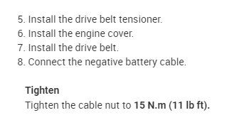

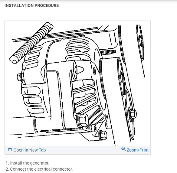

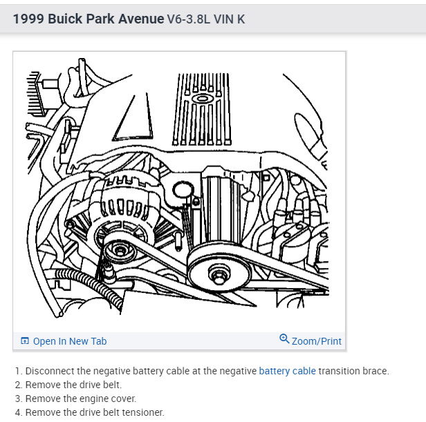

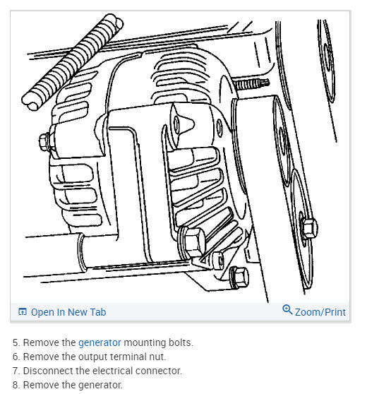

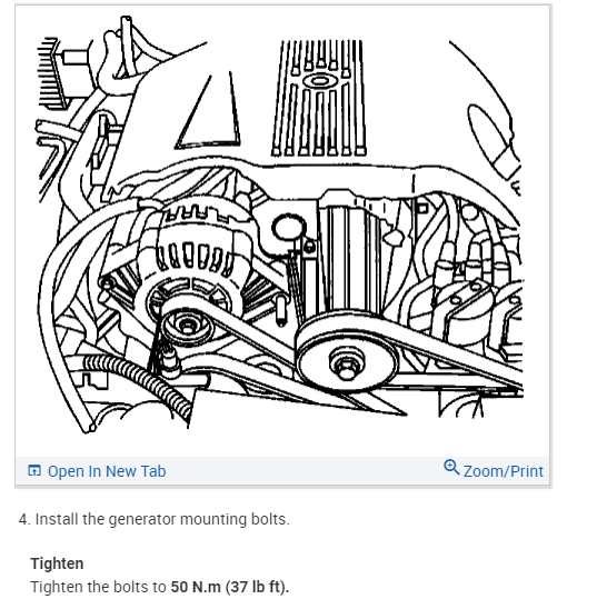

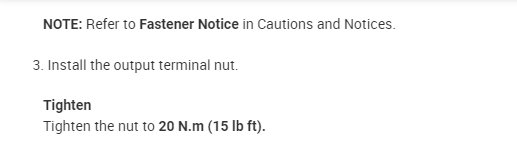

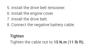

I attached the directions for replacing the alternator specific to this vehicle below. Make sure the battery is disconnected before you remove the alternator. Have them both bench tested to see if one or the other is bad.
Let me know what you find.
