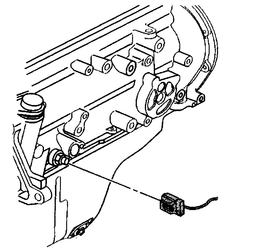

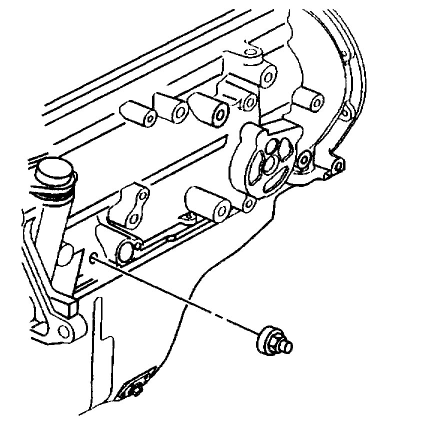

I changed the knock sensor since the machine gave to me the problem: PCM Knock sensor circuit, but after changed it the car doesn't start again.
What can I do?
What can I check?

The first thing I'm going to provide is a link the describes the most common causes for a crank no start condition. Take a look through it first.
Next are the directions for replacing the sensor. Take a look through them and confirm you did what is described. The attached pictures correlate with the directions.
_____________________________________________
2002 Pontiac Sunfire L4-2.2L VIN 4
Vehicle Powertrain Management Sensors and Switches - Powertrain Management Sensors and Switches - Computers and Control Systems Knock Sensor Service and Repair Procedures
REMOVAL PROCEDURE
pic 1
1. Remove the air cleaner outlet resonator.
2. Remove the knock sensor wiring harness connector from the knock sensor.
pic 2
3. Remove the knock sensor from the engine block.

If the directions were followed, then I need you to check for ignition spark. Here is a link that explains how that is done:
Here are a few links you may find helpful when testing for spark:
