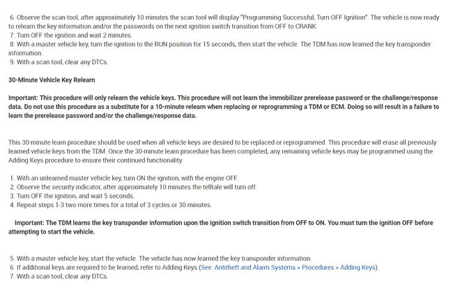

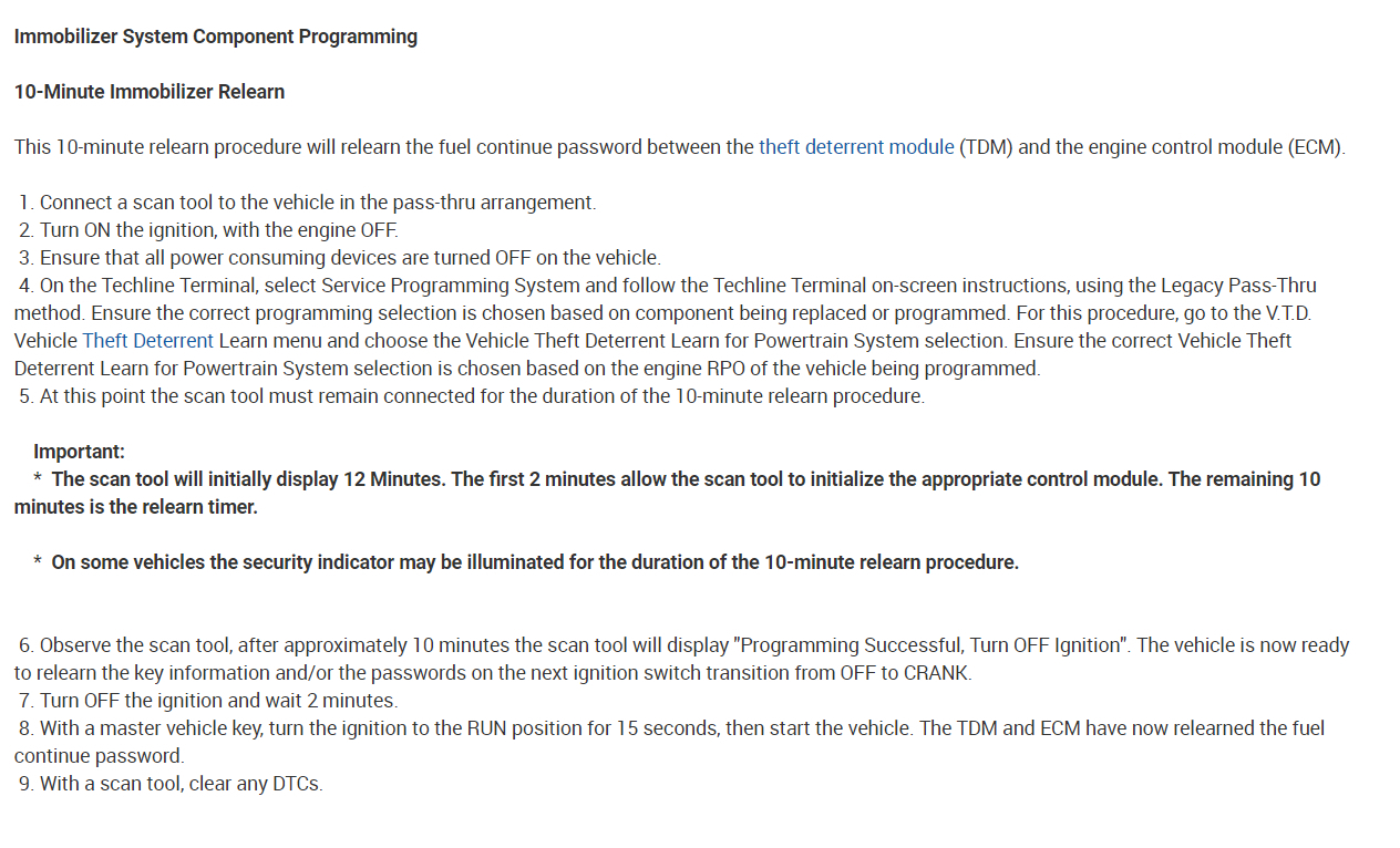

i have tried the 10 minutes on 30 seconds off programming service 15 times if not more. Since I had the new ignition put in my car listed above LT model i have reset my whole entire car with the hard reset with the terminals and also had called a lock smith to try and help me with his computer. I showed him the piece that fell out he said to go buy the module since the black box was no longer intact with the black circle piece with copper wires in it (not a clue). so I have that new piece but not sure what to do with it how it goes or even where it goes. on the other hand the locksmith guy also had mentioned that on his machine many codes came up but shouldn't be the issue. regardless my car still wont crank all the way over to start but will go half way. I think i'm going to try and wire a toggle switch to it today to see if that works. should I or no? The bad part of all this is i have spent $5,000.00 on my car buying it from a dealer ship then not long after since i have had it only like 5 months maybe 6 now this happens.

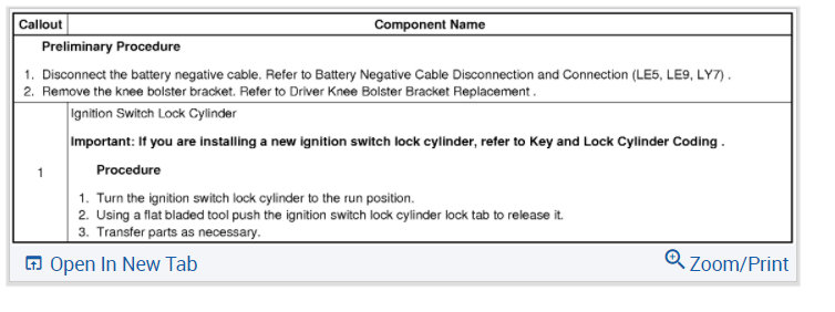

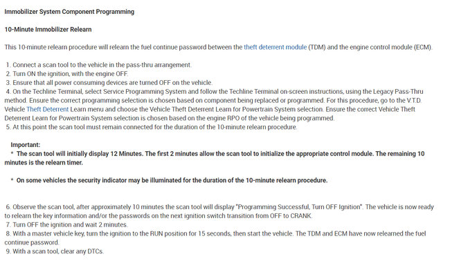

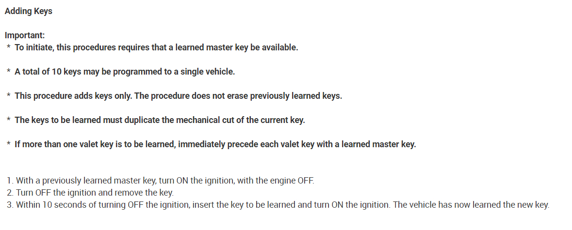

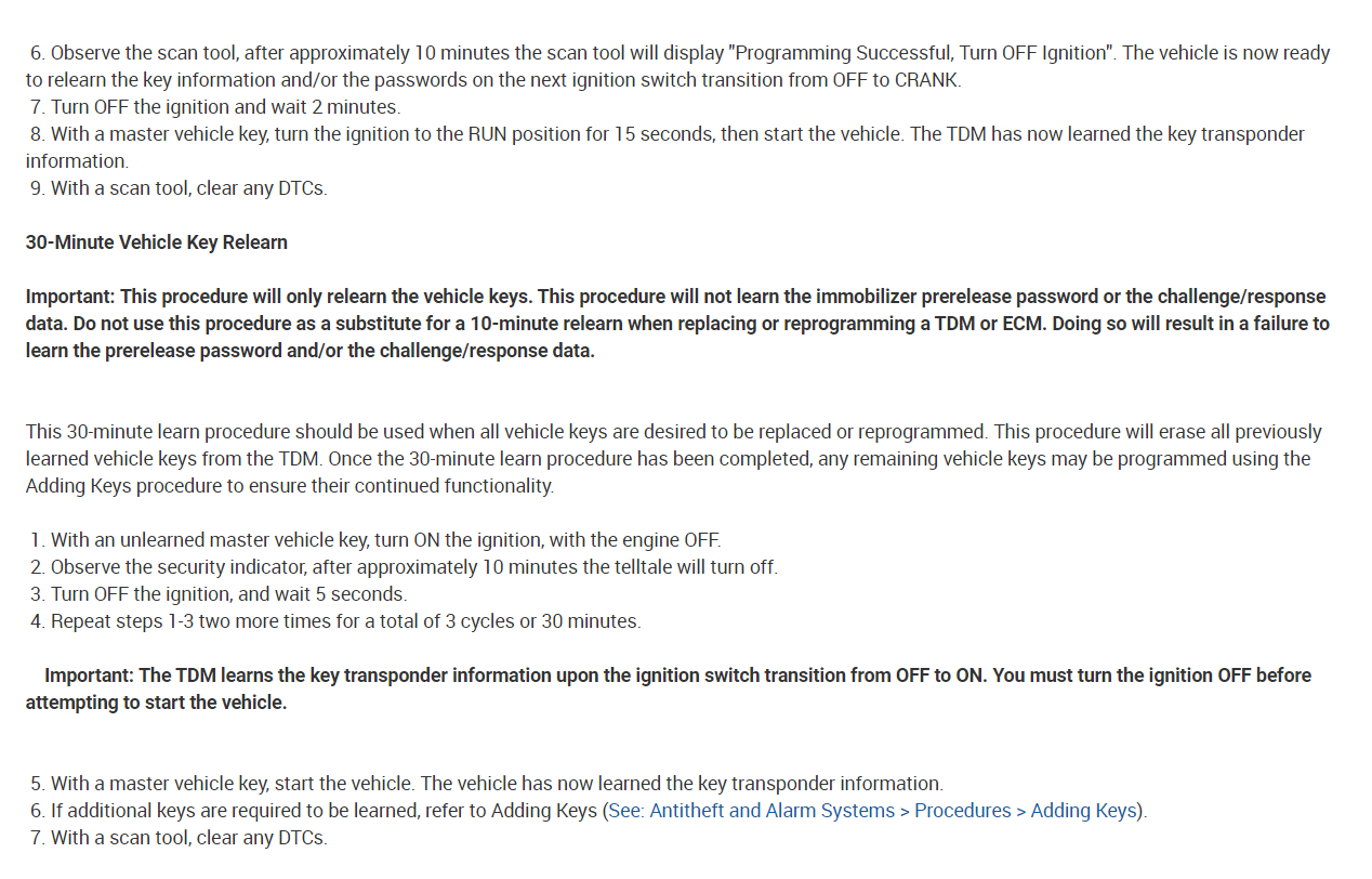

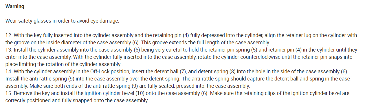

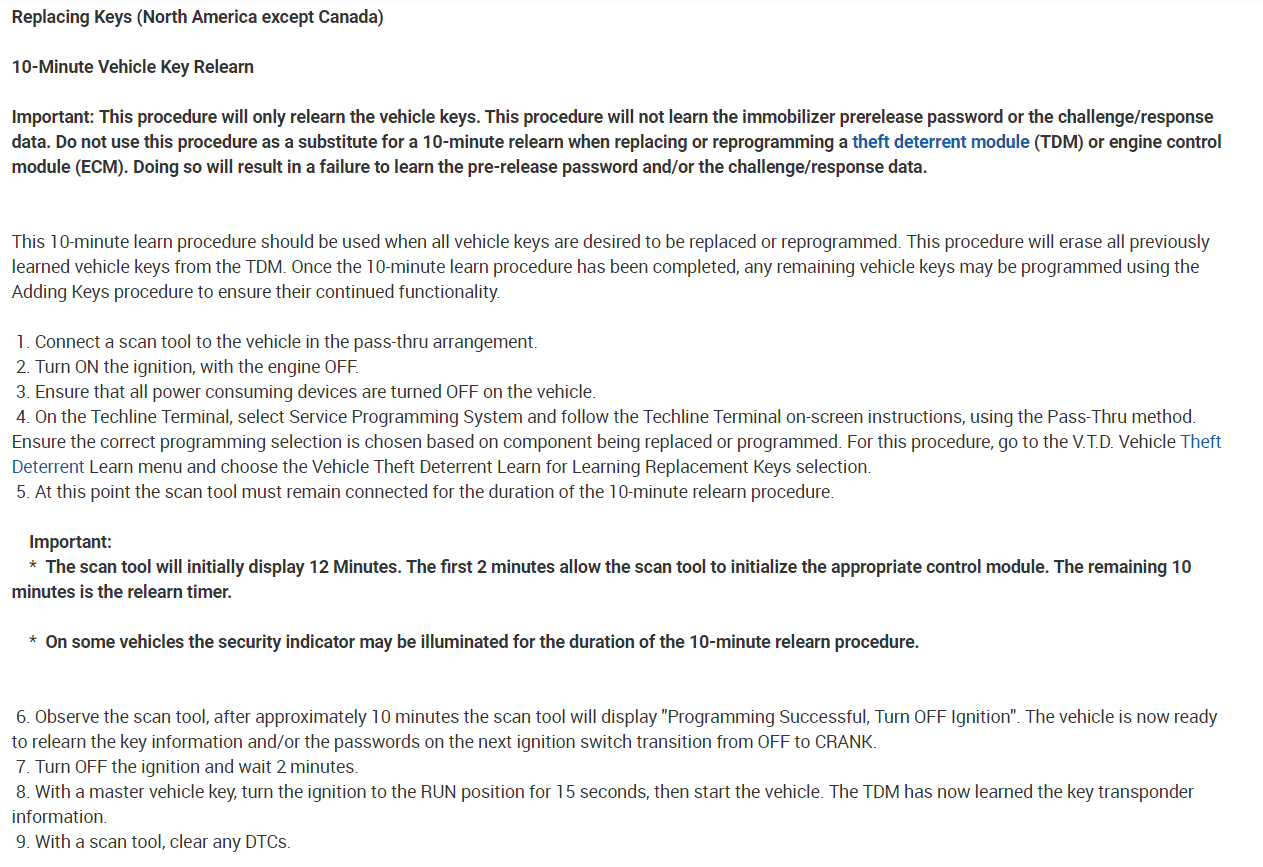

Yep, the black ring is part of the immobilizer so you need that. also if the Chevrolet dealer didn't code the key correctly it will not run. To be sure lets do a CAN scan which is the future of automotive repair. you can get a CAN scanner from Amazon for about $50.00. here is a video to show you how:
https://youtu.be/InIlnsjOVFA

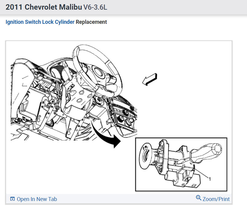

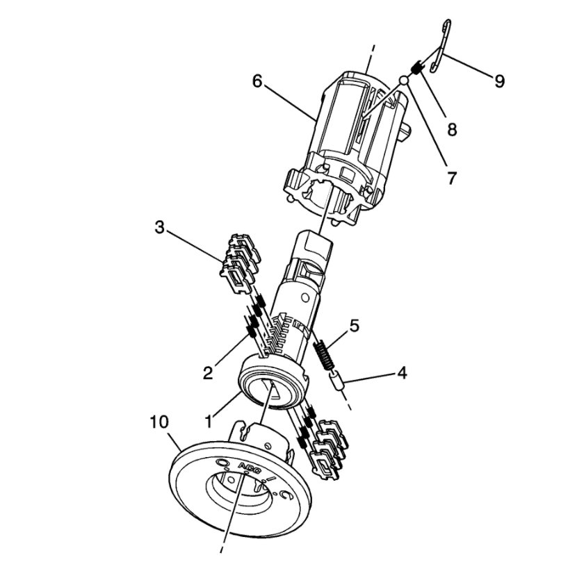

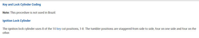

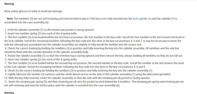

Also here is the instruction for the ignition key and tumbler to make sure they did their job correctly. Check out the diagrams (below). Let us know what happens and please upload pictures or videos of the problem.
