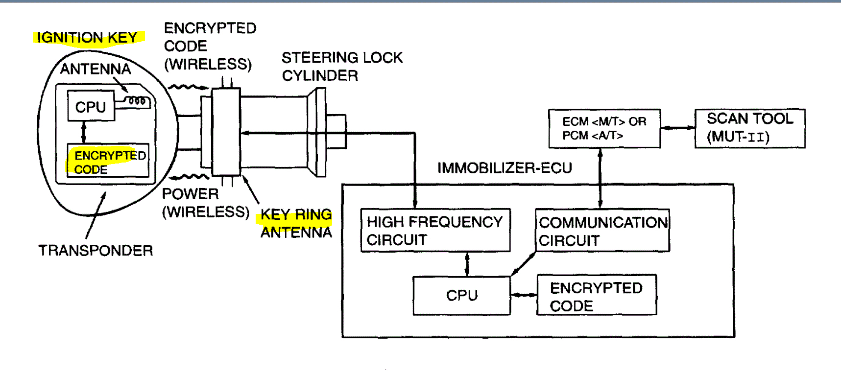

Lost the key and got a new ignition and key but car won't start. I'm guessing security problem.

It sounds like the immobilizer isn't recognizing the new key. What needs to be done is an encrypted key code registration. However, that does require a scan tool that can communicate with the ECU. All of the old codes will need to be deleted and the new one registered.
https://www.2carpros.com/articles/how-to-reset-a-security-system
Before we jump to that, tell me if the immobilizer light is staying on at all times. Also, let me know if you have a scan tool that can communicate with the ECU/PCM or if you have access to one.

Well, let me say this first. I found the old key but that ignition is not going to be put back in. It is trashed but is there a way to trick the system with old key somehow?

As far as the Mitsubishi, I attached a pic below for you to look at below. The ignition key has a built-in transponder. The keyring antenna is installed on the steering lock key cylinder. The antenna is part is on the ignition lock cylinder. At this point, the old key doesn't match. That is why it needs to be programmed.
Let me know if that makes sense. LOL
Take care and keep me updated or let me know if you have questions.
