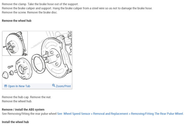

I'm trying to change the wheel bolt studs on the wheel but i can't access it from behind. Is it the ABS system blocking it? How do i remove it so i can hammer out the wheel bolt nuts and replace them with 4 new ones? This is the first time I'm working on my car.

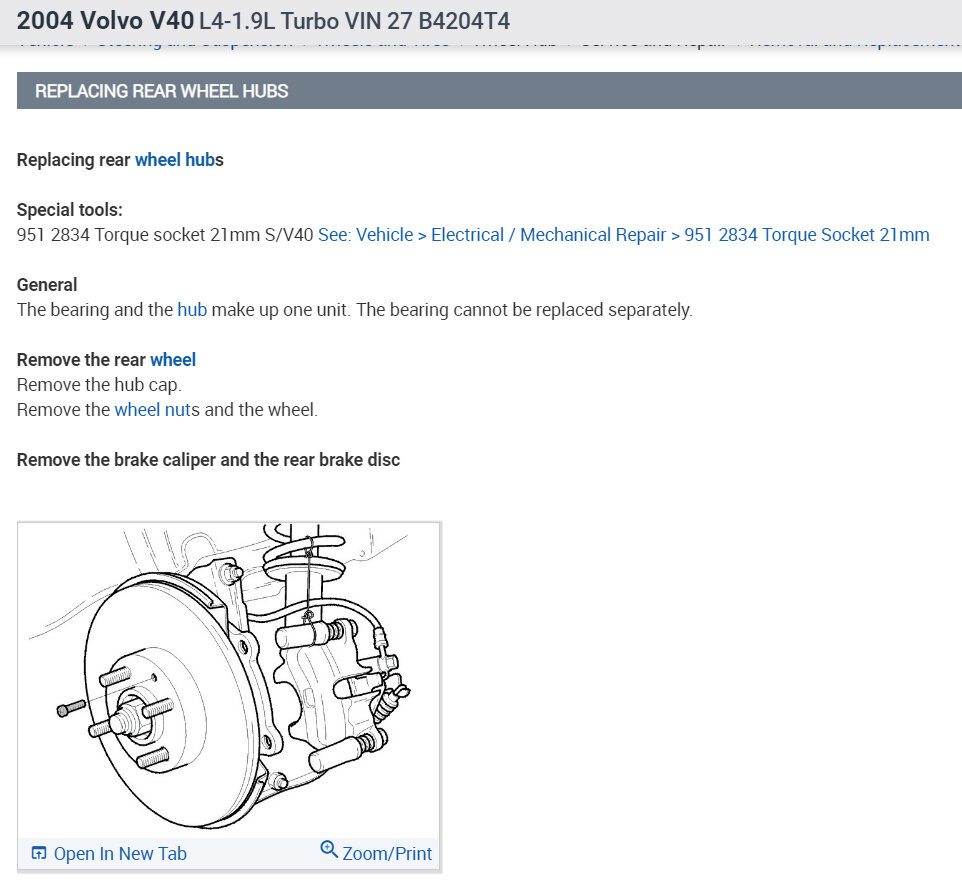

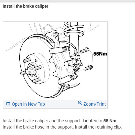

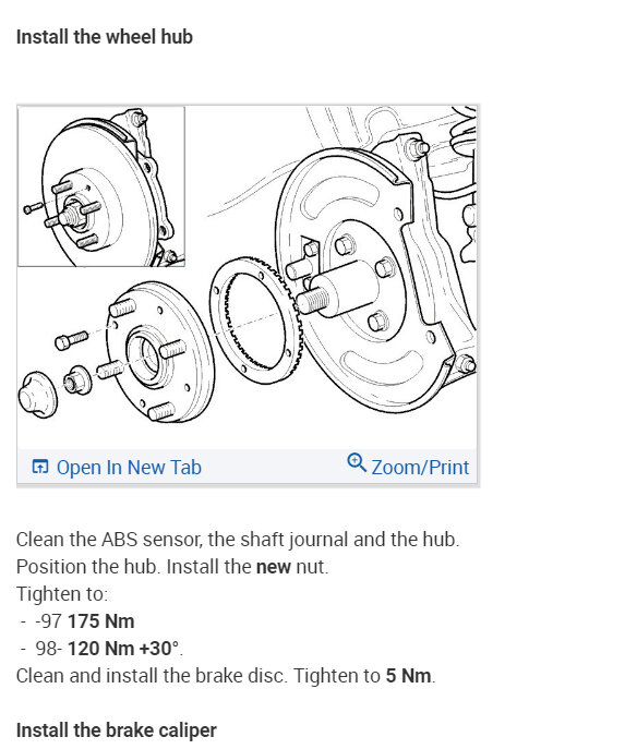

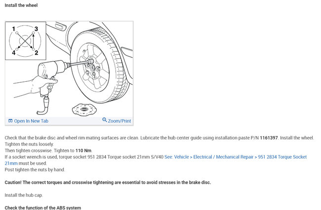

Welcome to working on your car where you can save money and do the job correctly, we are here to help you. It looks like you can just replace the wheel hub as well if needed. Please check out how to do the job in the images below. Please let us know if you need anything else to get the problem fixed.
