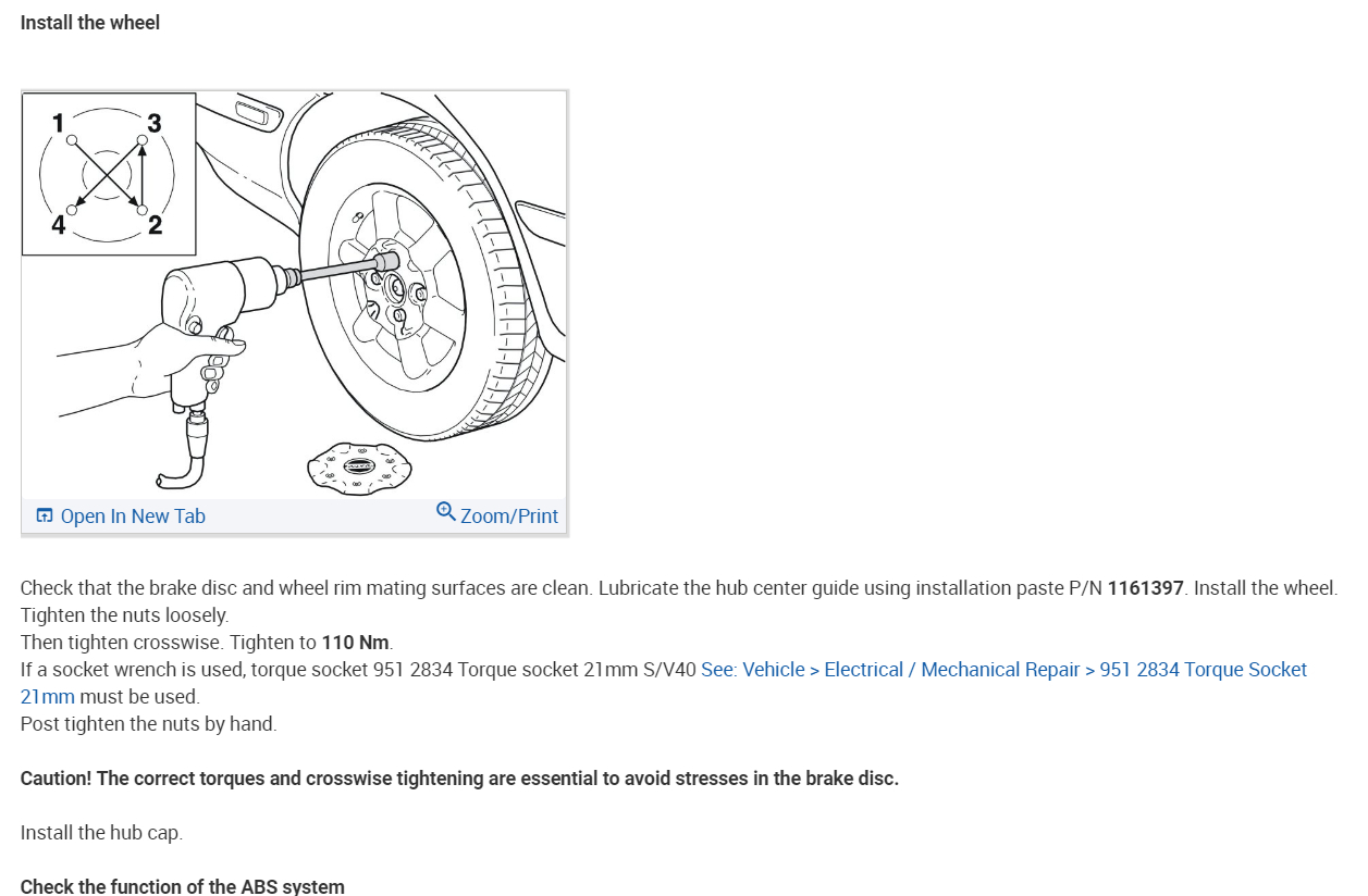

Change wheel bolt stud on left side back wheel, how to remove it?
30,000 MILES • 2.0L • TURBO • 2WD • MANUAL
STEVE94SE

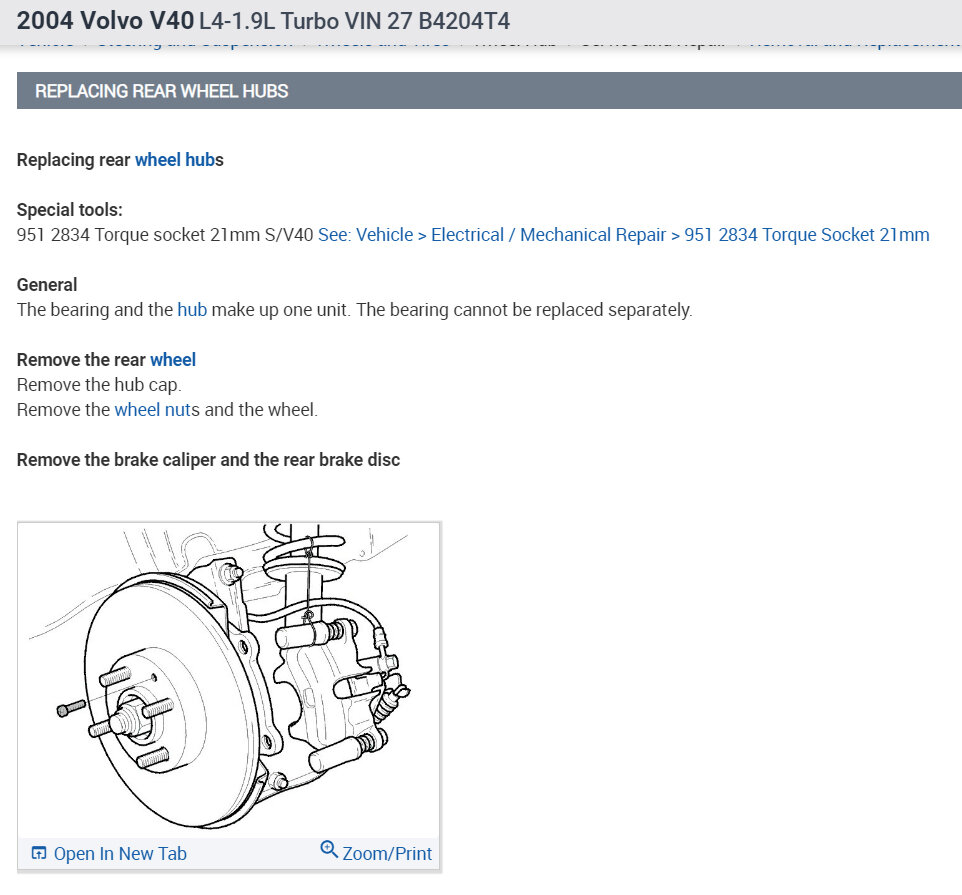

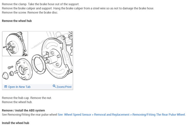

I'm trying to change the wheel bolt studs on the wheel but i can't access it from behind. Is it the ABS system blocking it? How do i remove it so i can hammer out the wheel bolt nuts and replace them with 4 new ones? This is the first time I'm working on my car.
Aug 11, 2023 at 7:28 AM
  • 55,721 POSTS

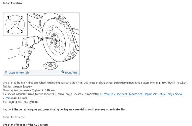

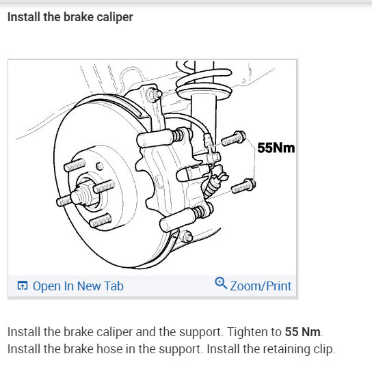

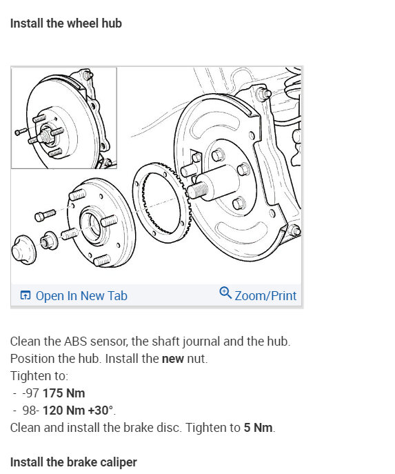

Welcome to working on your car where you can save money and do the job correctly, we are here to help you. It looks like you can just replace the wheel hub as well if needed. Please check out how to do the job in the images below. Please let us know if you need anything else to get the problem fixed.
