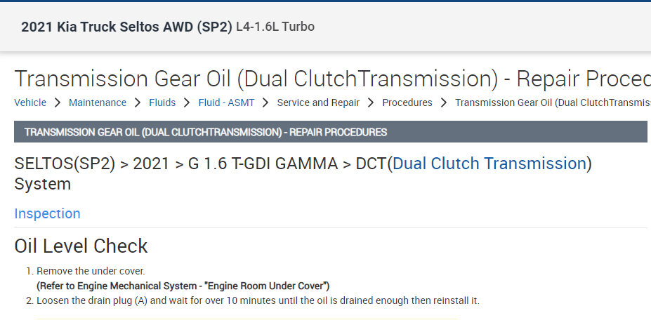

I want to know how to change the transmission oil, because I can't find a guide (nothing).
Aug 27, 2024 at 10:21 AM
  • 110,240 POSTS

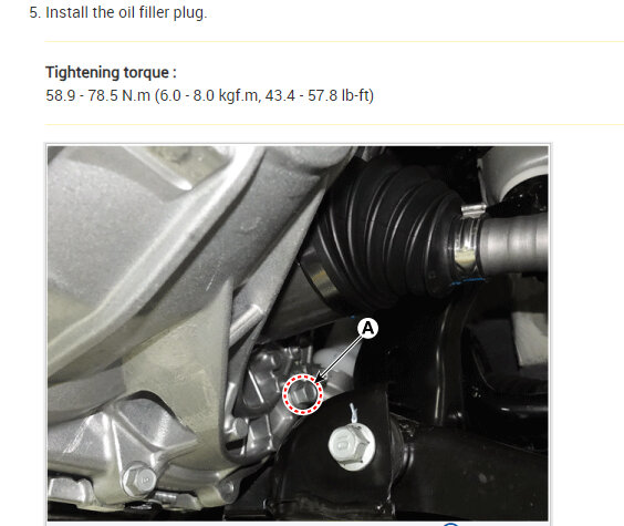

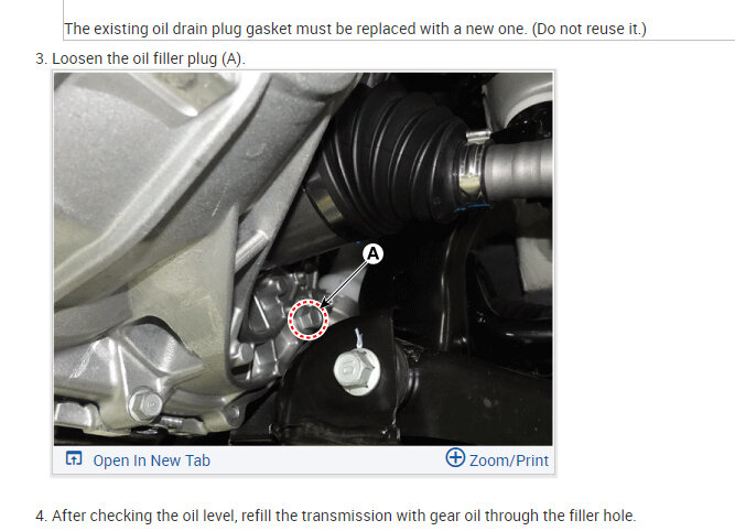

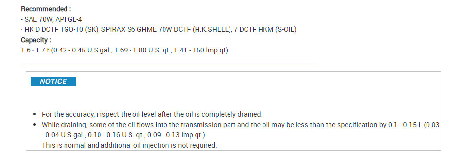

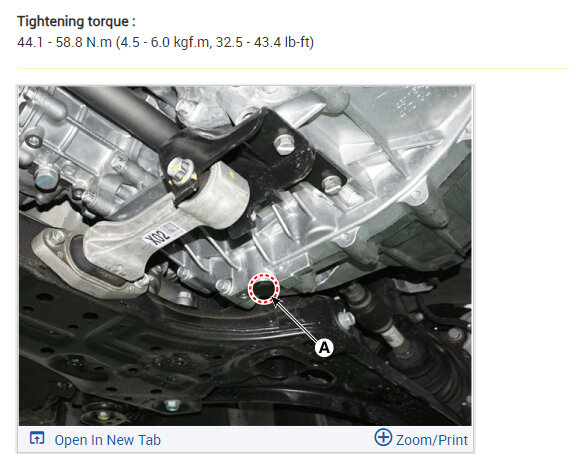

The only information I'm finding for this vehicle is or an automatically shifted manual transmission.
If that is what You have, I attached the directions below. Let me know if this helps or if you have other questions.
