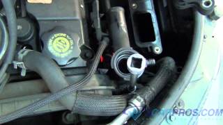

I need a diagram and written instructions on changing the thermostat and water outlet cover.
Jan 14, 2023 at 11:57 AM
  • 55,721 POSTS

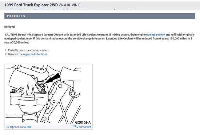

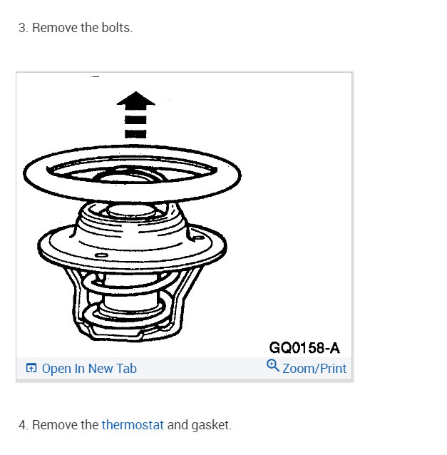

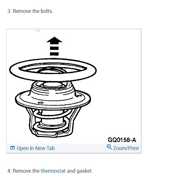

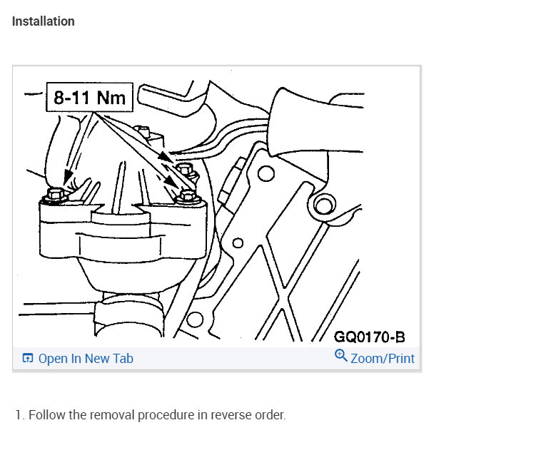

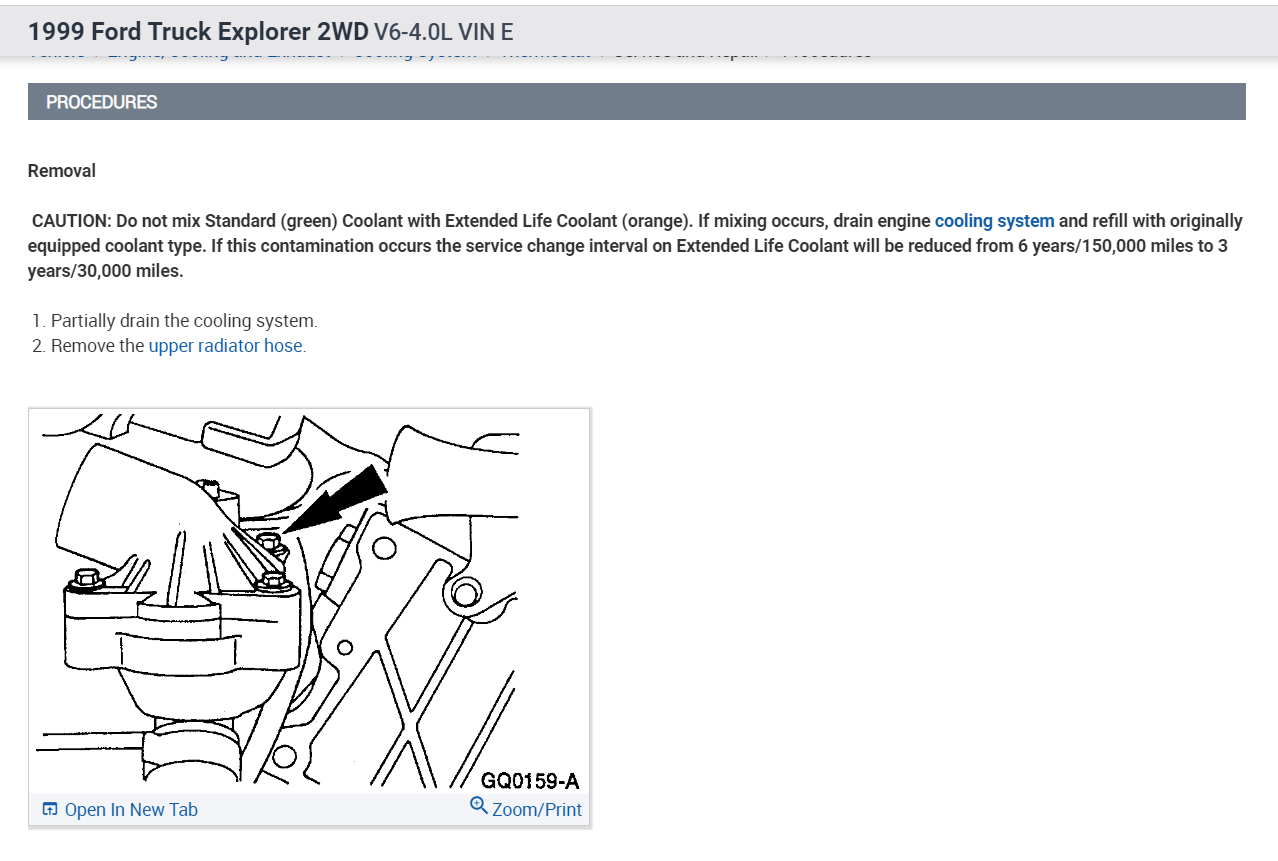

Sure, here is a generic guide to help walk you through the repair be sure to drain the coolant first. I have included the instructions for you in the images below.
Be sure to install the thermostat with the cone part sticking upward. Check out the images (below). Please let us know if you need anything else to get the problem fixed.
