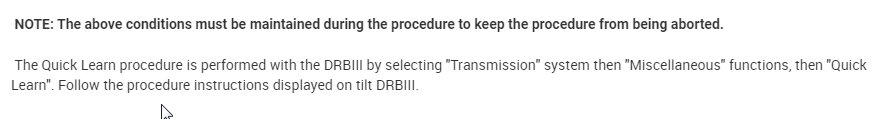

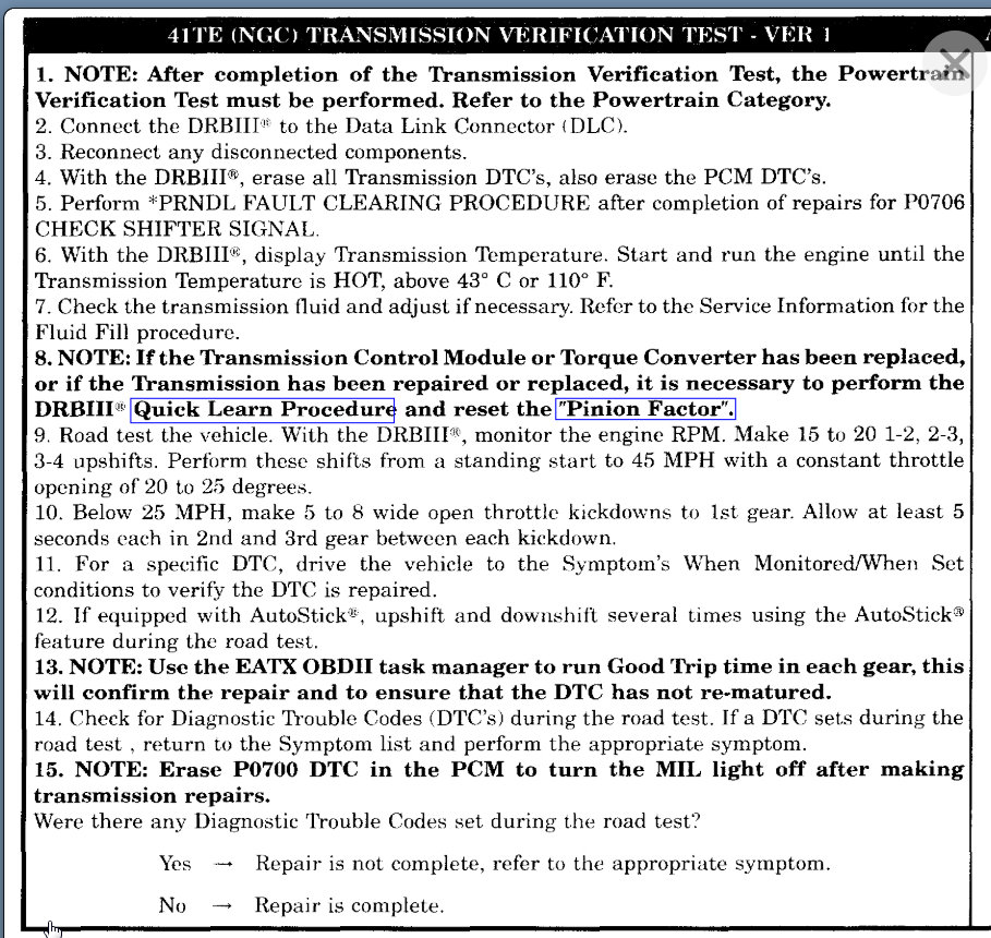

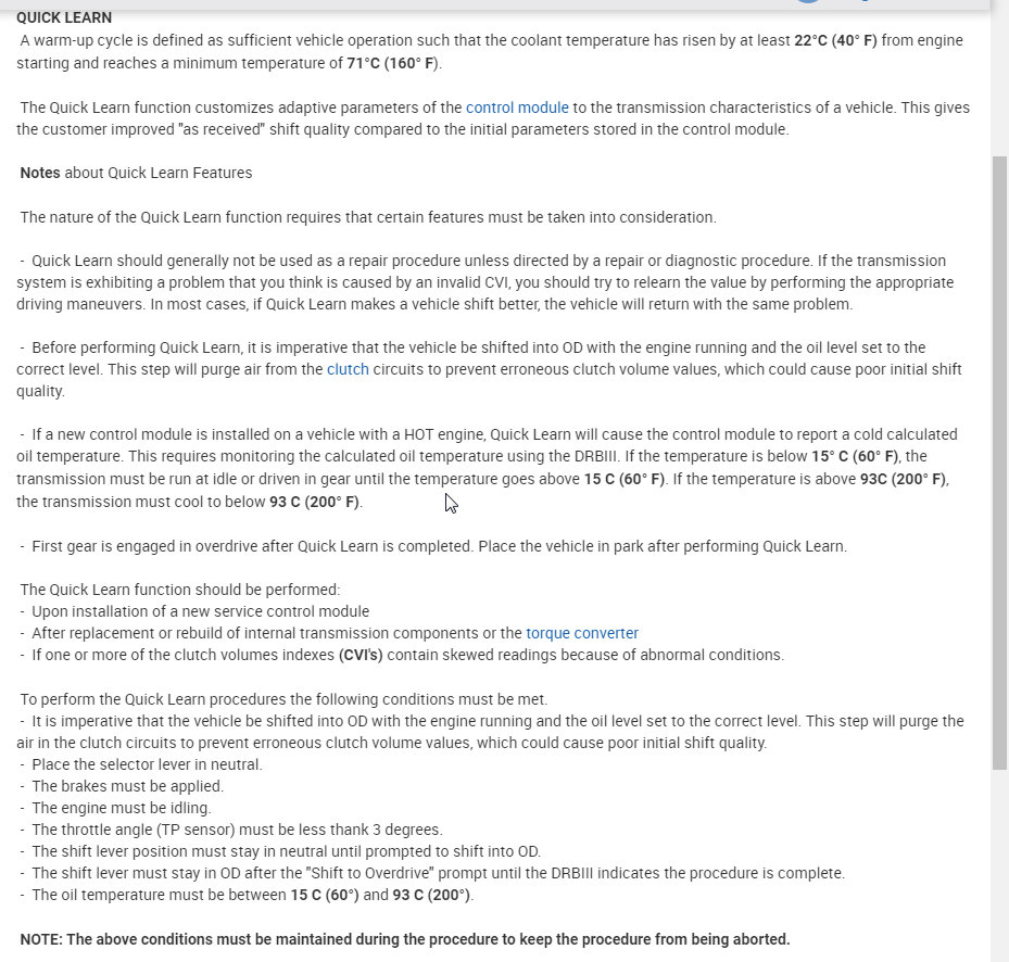

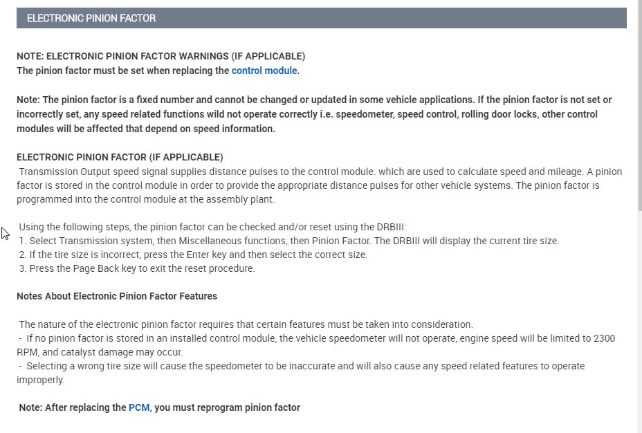

Change the transmission control module need to reprogram it.
Oct 19, 2019 at 11:50 PM
Do you have access to a scan tool that can perform these functions? Unfortunately, it is required. I attached the needed procedures. Let me know if you have questions.
