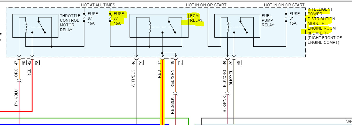

Change my spark plugs and not light and everything turns on but only cranks car won't turn on fully.

That is odd. When it cranks, does it give any indication it's trying to start? Also, keep in mind, most crank no-start conditions are usually a fuel-related issue or ignition spark. Since the plugs were just replaced, I need you to check if they are getting spark.
Here is a link that explains how it's done:
https://www.2carpros.com/articles/how-to-check-for-ignition-spark
Also, if you have a scan tool, check to see if there are diagnostic trouble codes stored. If there are, let me know what they are.
If there is no spark to the plugs, check fuse 77 in the intelligent power distribution module (IPDM) under the hood on the passenger side.
Jun 24, 2023 at 10:37 PM

It looks like it wants to turn on but it does not, and I don't think it's getting spark.

It's getting spark .... mm I just found out gas can go bad in over 3 months. My car has been sitting with a full tank for 5 months now. I believe that's the problem now. can I get advice before draining it? Or I'm I wrong?

Try this: First, see if it starts with starting fluid. If it does, then we can assume it is fuel related. However, five months isn't long enough for it to get bad enough to prevent it from starting. At least I've never experienced that as an issue.
If it does start and then stalls, we need to check a few things that are fuel related. Try that and let me know the results.
