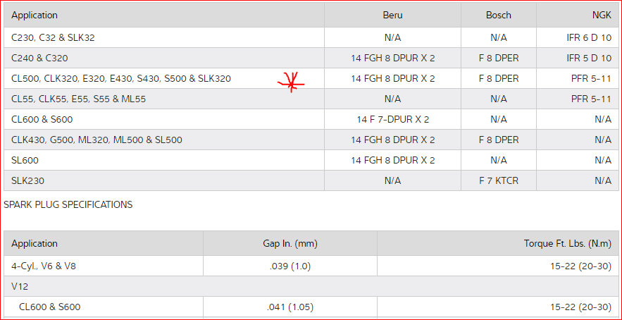

a friend of mine is asking me to change the spark plugs in the car listed above. I believe it is a V6 and looks like it has 12 plugs. I am preparing to do the job and I am looking for the procedures to do it and also any special tools/tricks to do this job and also a recommendation on what type of plugs to use.

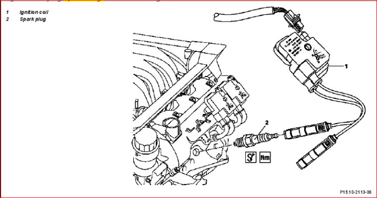

The only trick is to just be sure to use a spark plug socket when removing and replacing the Plugs. It prevents damage to the plugs. I have attached a picture showing what types of new spark plugs to use with an asterisk. I have also attached a tutorial showing what is involved. Hope this helps and feel free to ask questions if needed. Thanks for using 2CarPros.
