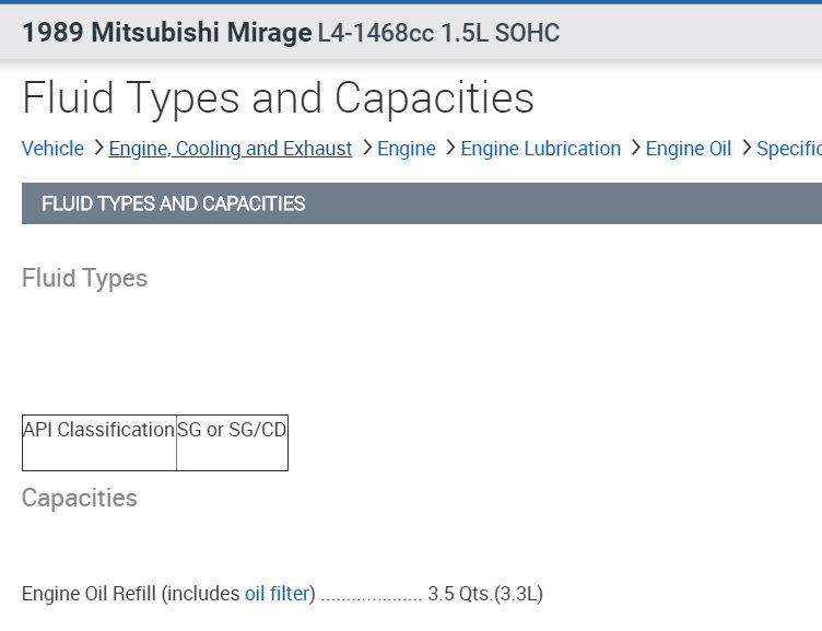

I don't have the car manual. I wanted to know what type of engine oil should i use to replace it and what oil filter should i use? Also how many Liters do I need to pour into the engine?

I have included the information that you requested in the diagrams down below. I have also included a couple of links down below for you to go to below:
https://www.2carpros.com/articles/how-to-change-engine-oil-and-filter
Please go through these guides and use the information provided and give your vehicle some TLC and get back to us with how it goes. And as always, if you have an automotive question, please do not hesitate to ask. It's what we are here for.
