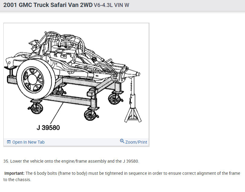

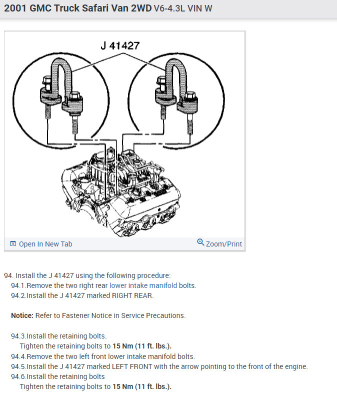

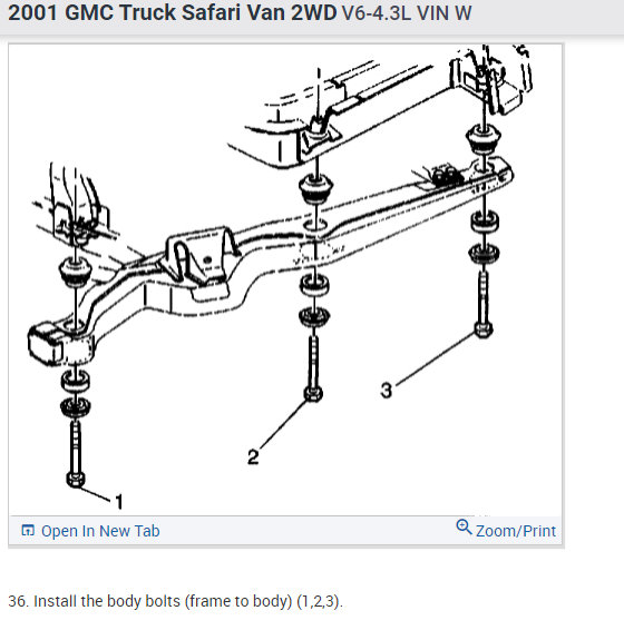

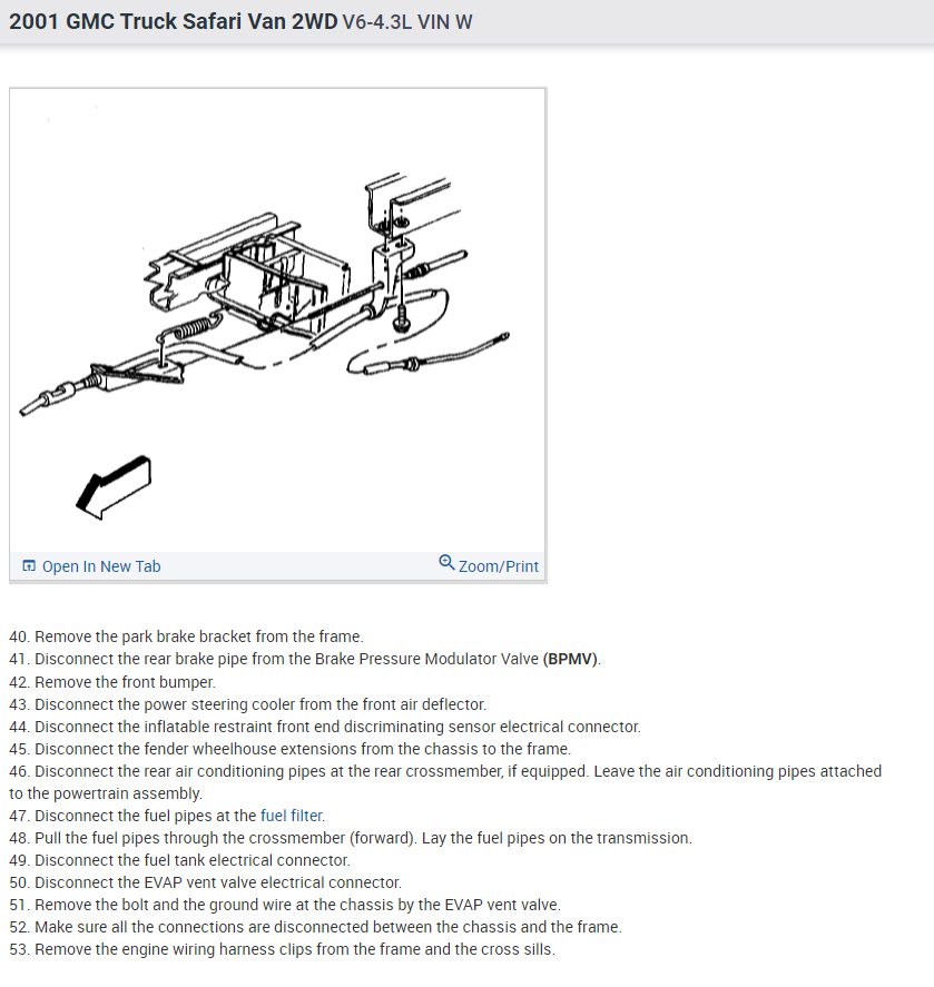

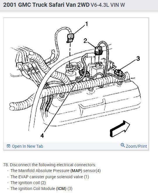

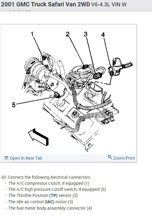

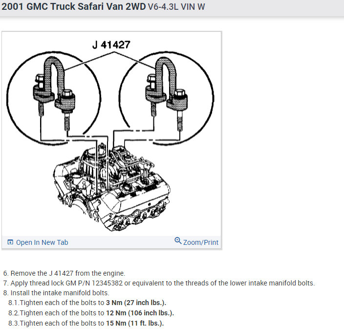

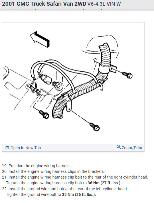

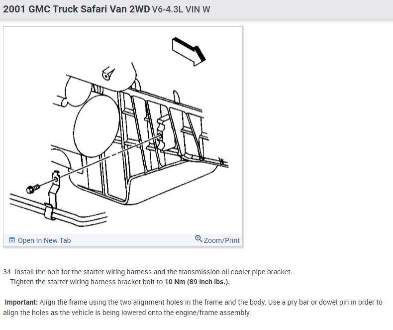

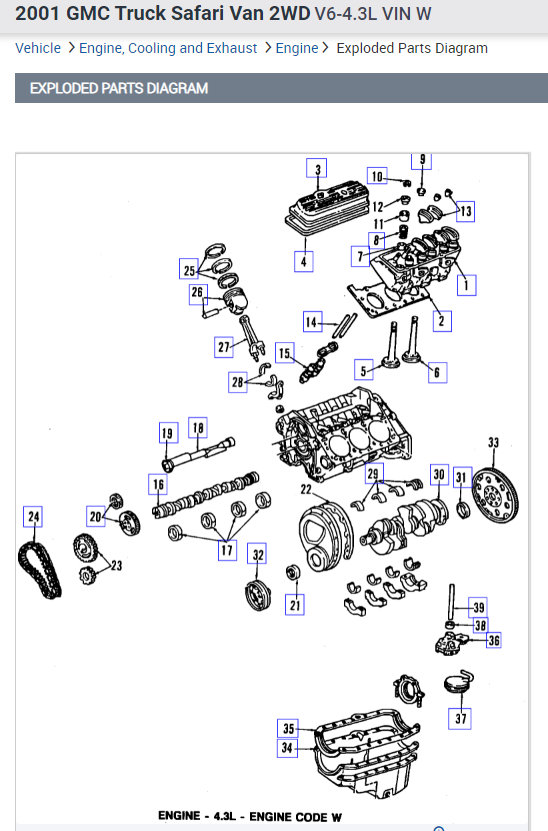

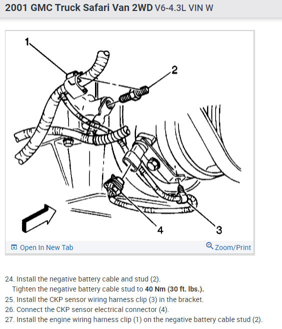

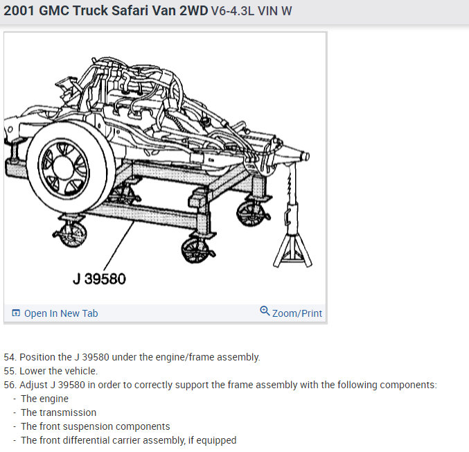

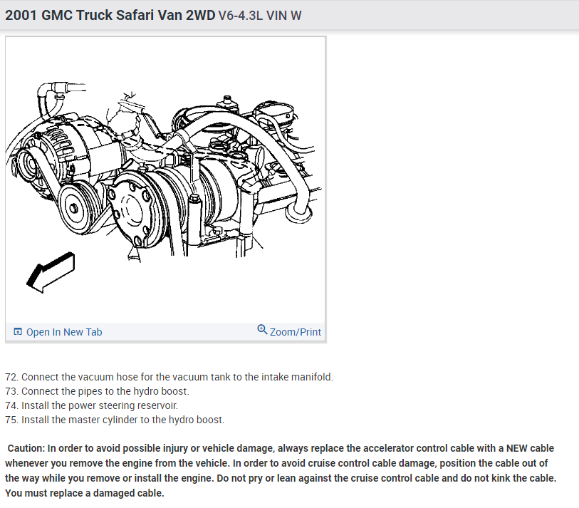

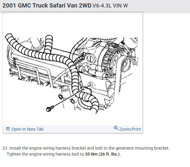

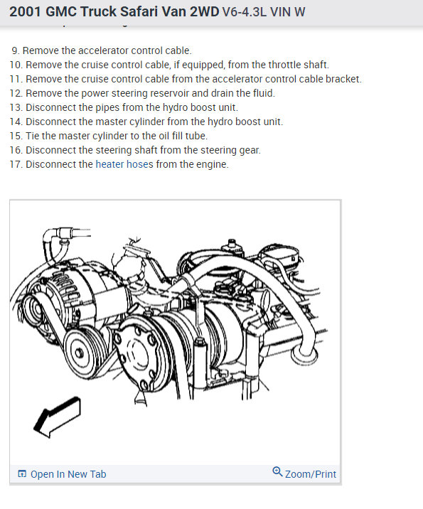

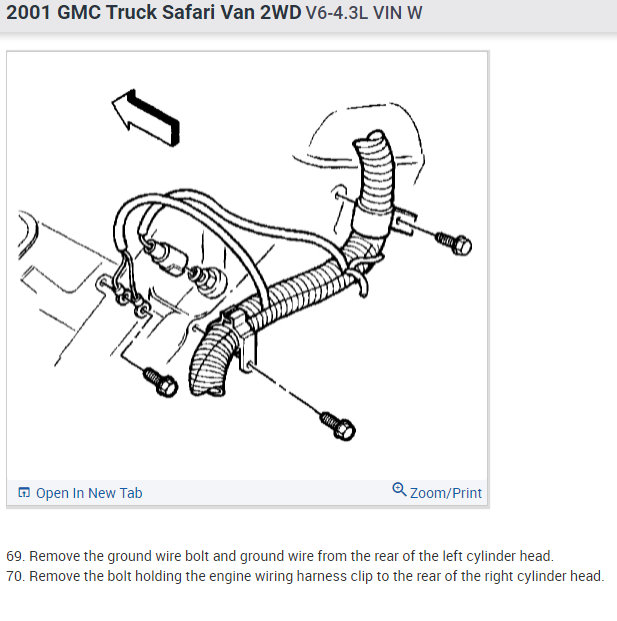

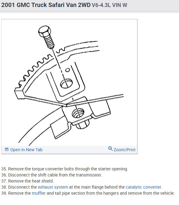

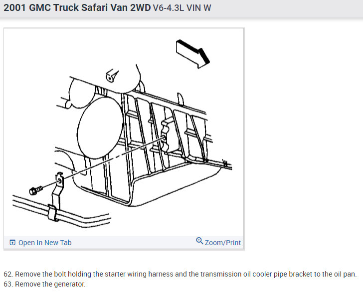

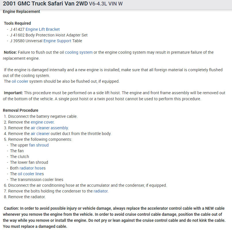

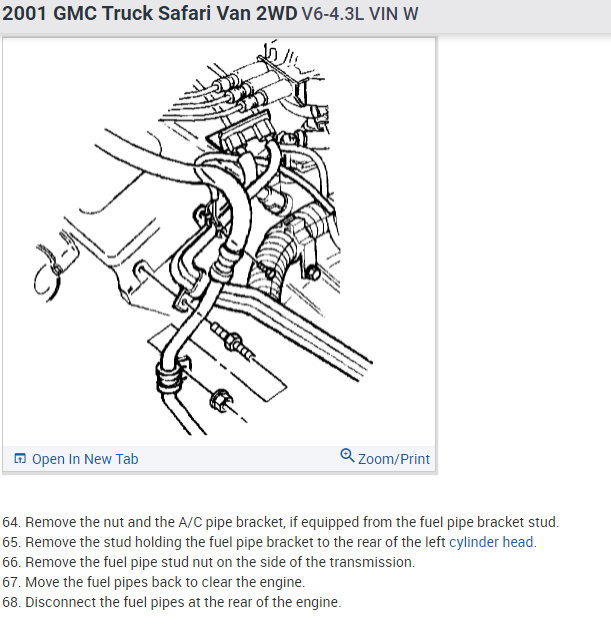

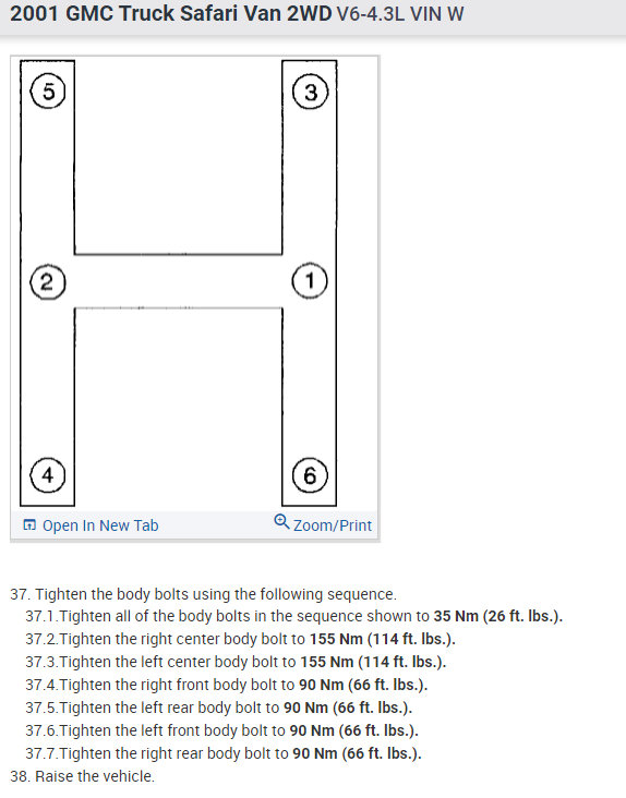

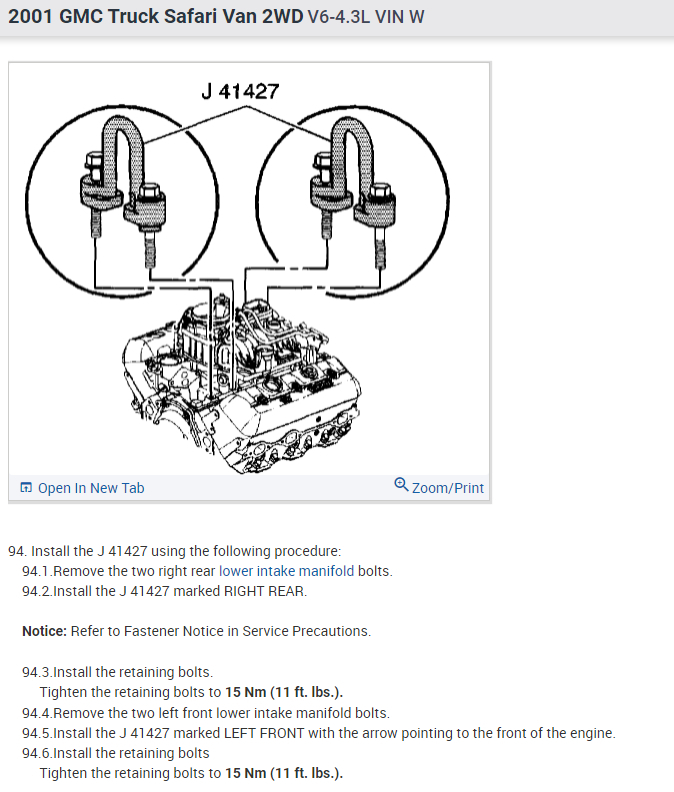

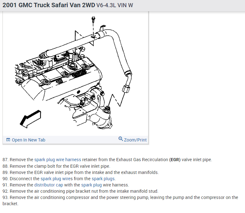

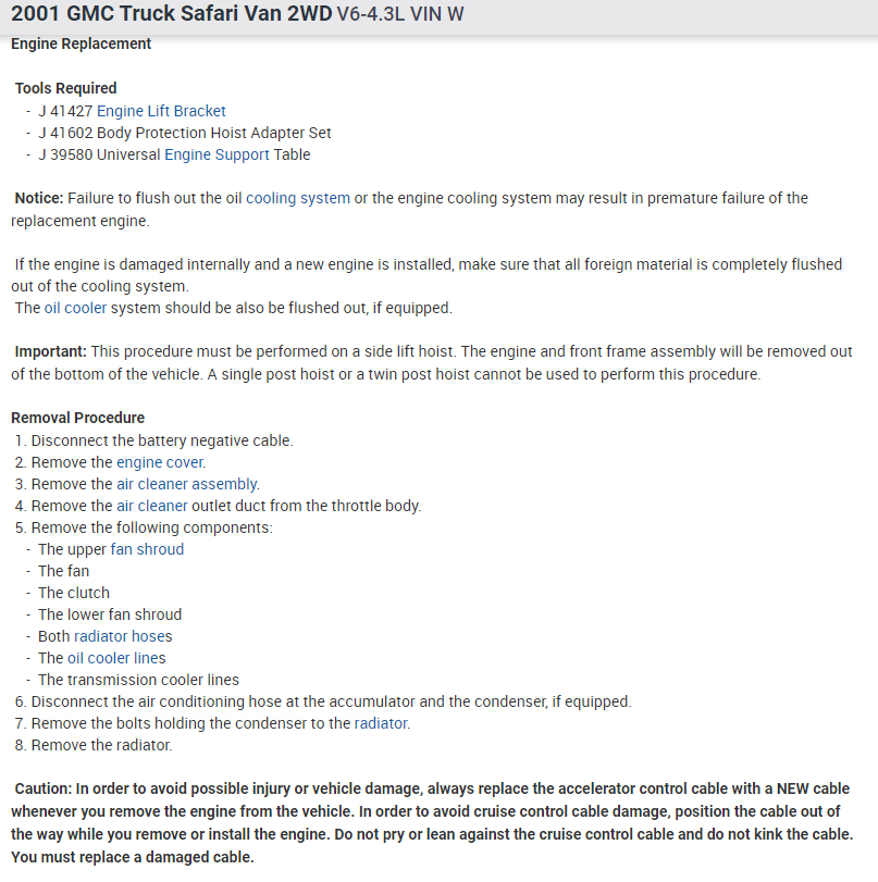

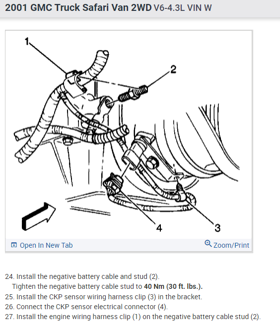

how to take front end off to change motor?
Aug 4, 2021 at 12:55 PM
SQM
Experienced Mechanic
6,383 POSTS

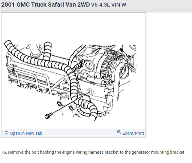

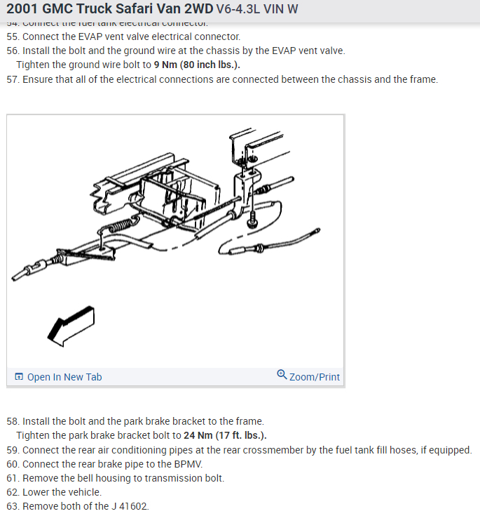

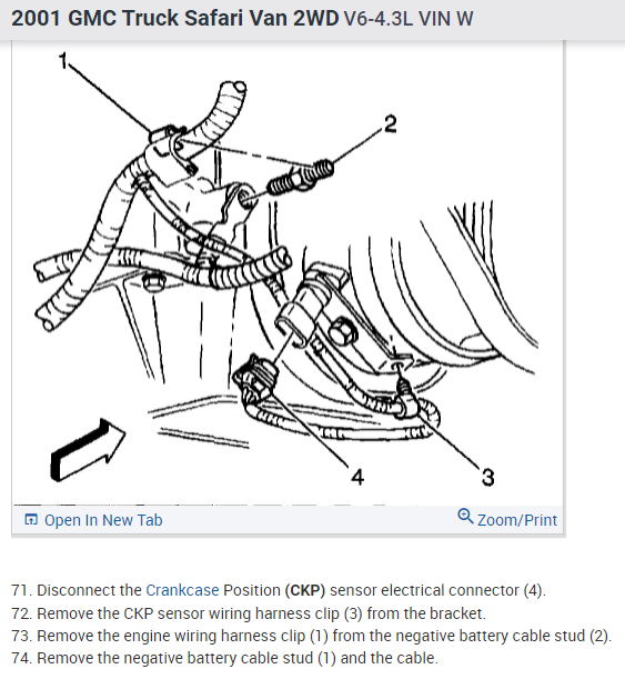

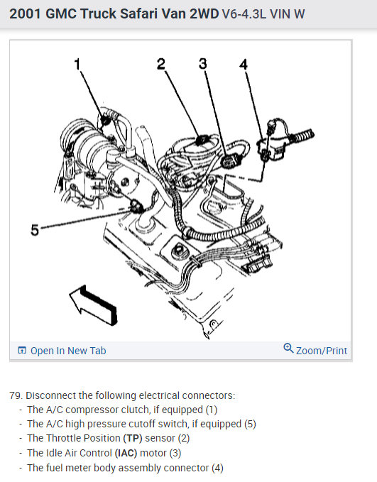

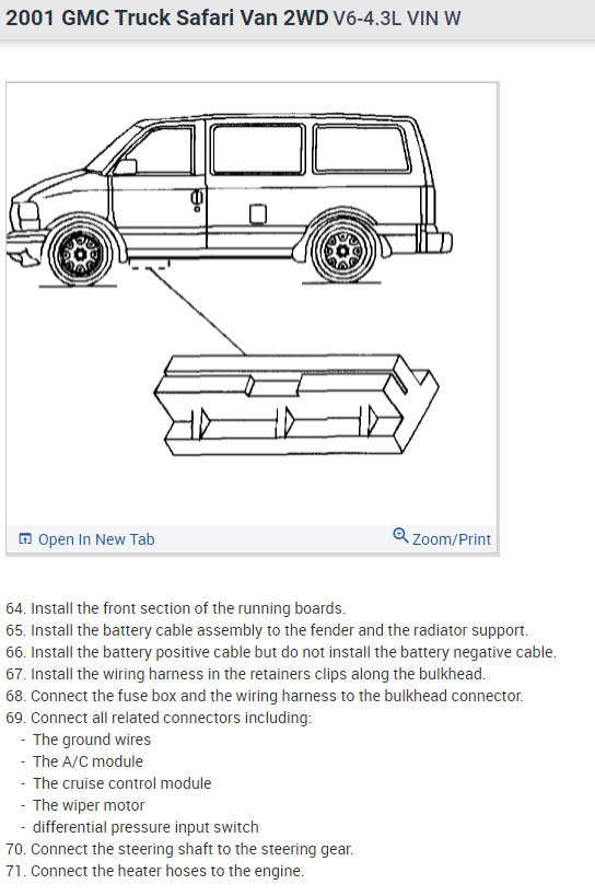

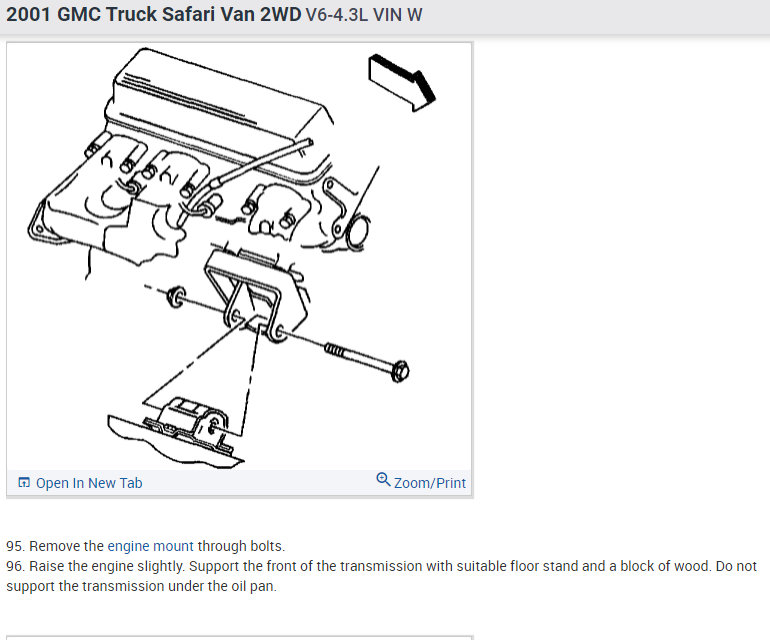

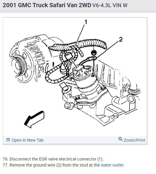

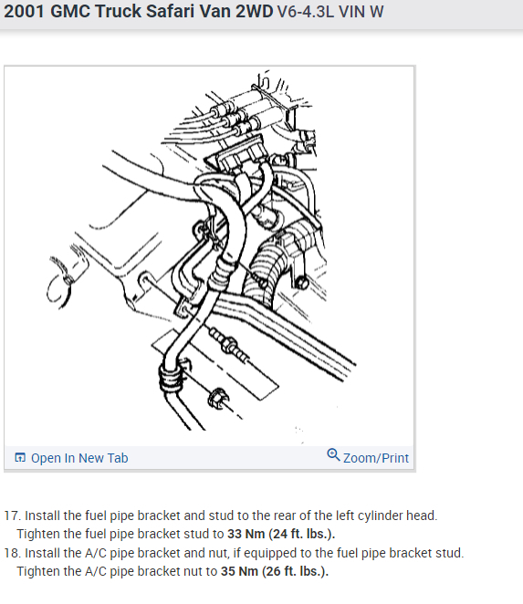

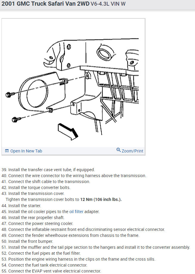

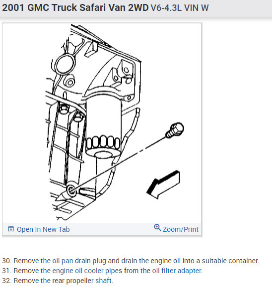

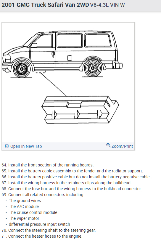

I have attached the complete engine replacement procedures for your vehicle (see below).
https://youtu.be/zy1CozLgWUQ
Please let me know if you need any other info.
