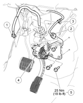

Change gas pedal sensor?
200,000 MILES • 5.0L • AUTOMATIC
MACDADDY2
"Service Advance Track" is the dashboard warning and your in no turn signals mode. Then you have to Stop the truck pull the floor mat from under the pedal and start it again letting the gas pedal sensor to connect properly. I hear if you get a new sensor this connecting problem goes away gas mileage improves because shifting gears is better.
Sep 24, 2026 at 12:56 PM
  • 55,684 POSTS
Yep, this is a common problem, but I would run the codes first, here is a video to help.
https://www.youtube.com/watch?v=LBCpCWEFnTg
Here is how to change out the accelerator pedal sensor. Let me know please.
Sep 25, 2026 at 6:11 PM
