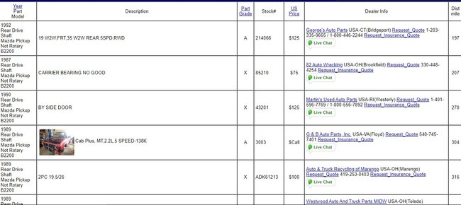

Change automatic to a manual transmission and the driveshaft is too short?
1990 MAZDA B2200
185,000 MILES • 2.2L • 4 CYL • 2WD • MANUAL
NYJIL
automatic drive shaft too short why? How to find the proper fix?
Jan 17, 2021 at 12:08 AM
Good afternoon,
The difference is the length of the transmission itself.
The manual transmission is shorter than the automatic. You will need the driveshaft for the manual transmission.
Go to www.car-part.com and enter your zip code and there will be a couple of pages of them for you. I attached a page for you.
