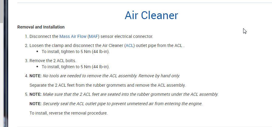

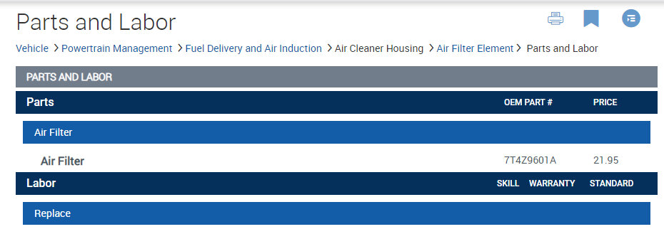

New air filter is right air for car but will not housing will not close.
Dec 13, 2020 at 7:43 AM
Can you get a video of you trying to put the housing back together? I suspect the housing is not fitting back together properly because of the clips or grommets. There are grommets that need to fit together properly for it to close and lock.
Seeing it will allow us to better direct you on how to get it back together. Some of these can be tricky so let's get the video and go from there. Thanks
