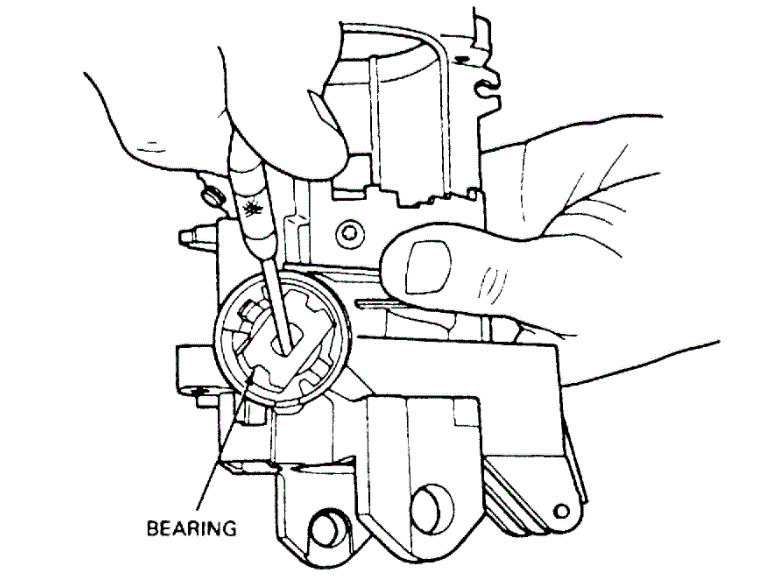

How do I replace a ignition switch if I don't have a key? This truck was a repo vehicle.

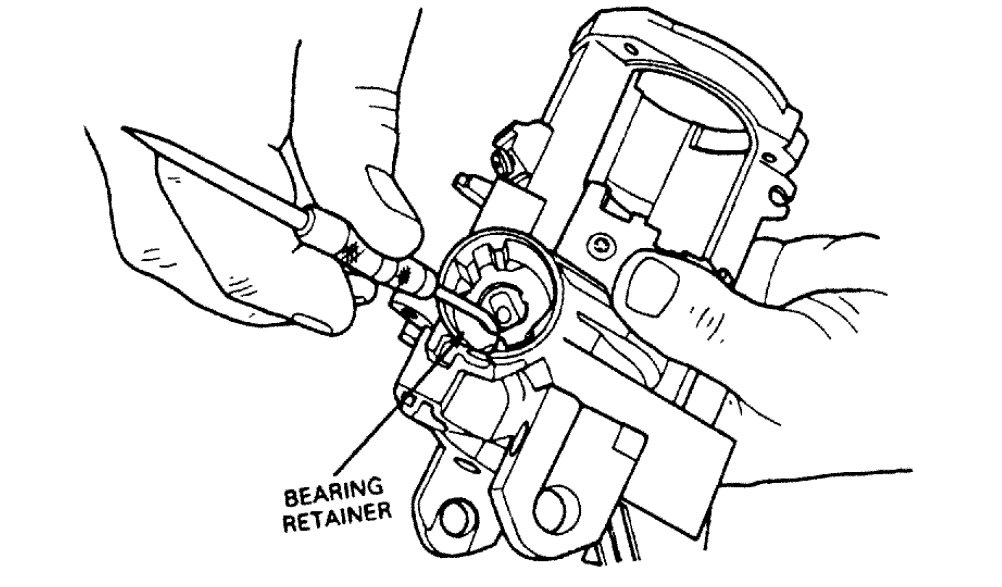

Fig. 3 Ignition Lock Bearing Retainer Removal (Less Key)
9. Remove white plastic bearing retainer by inserting a suitable tool with a 90 degrees bend on tip between bearing retainer and bearing and prying upward, Fig. 3. Note position of bearing retainer prior to removal.
Fig. 4 Ignition Lock Bearing Removal (Less Key)
10. Insert tip of a suitable screwdriver into double-D slot of bearing, Fig. 4, rotate 90°, then remove bearing.

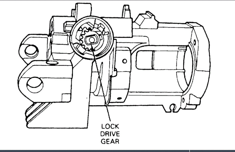

Fig. 5 Ignition Lock Drive Gear (Less Key)
11. Remove lock drive gear, Fig. 5, noting relationship of lock drive gear to rack teeth.
