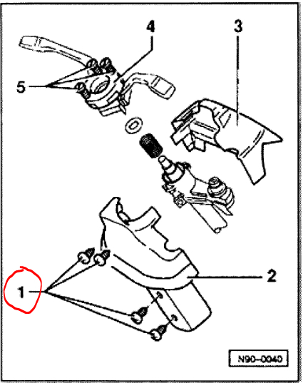

Unable to get lower cover from steering wheel.

If the upper cover is removed, it should come off. Did you remove all screws that hold it in place? I attached a pic below. Take a look at it and let me know if that is what your column looks like and if all screws are removed.
See pic below.
