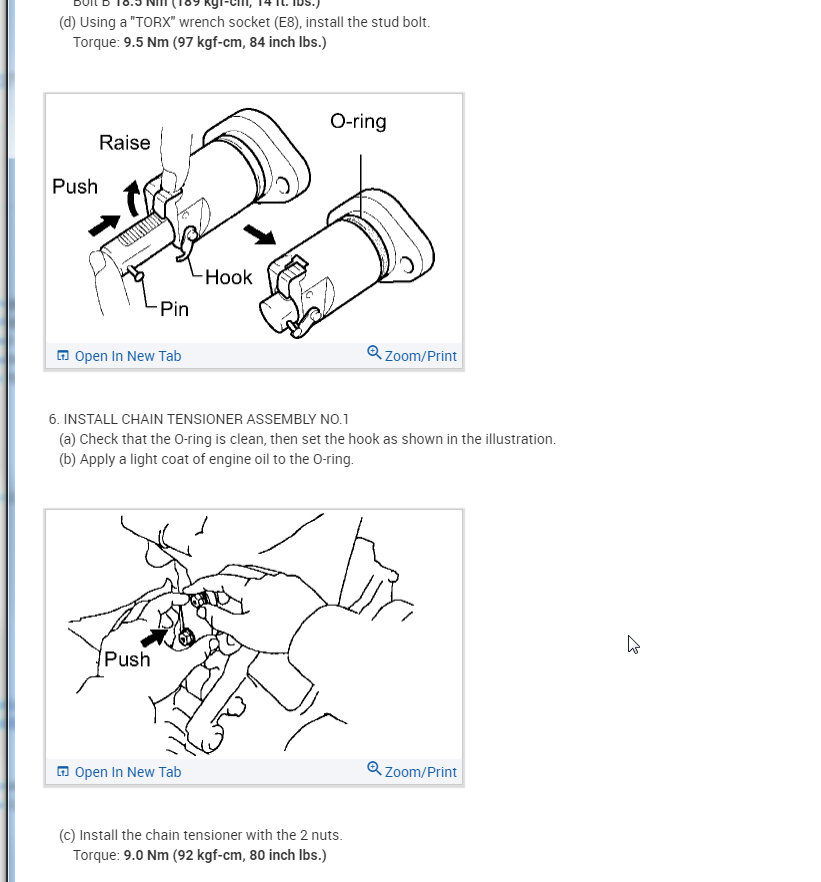

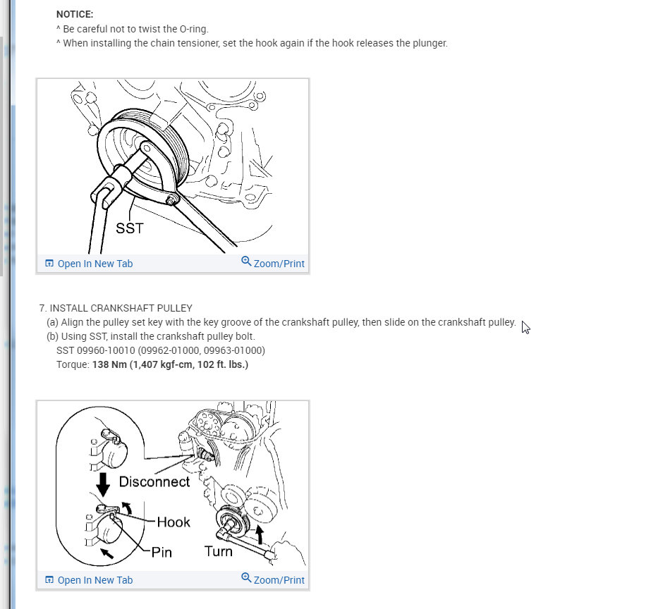

can you please give instructions how to reseal chain cover for engine 1ZZFE and what kind a sealer i need to use?
May 9, 2020 at 7:08 AM
I attached the process to reseal the cover and it includes the sealing pack needed. Let me know if you have more questions. Thanks
May 9, 2020 at 11:39 AM
LASTMOH
  • 26 POSTS

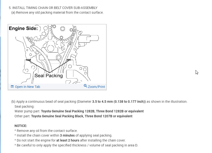

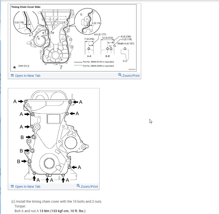

so there is no gasket . i need to use silicone right?
May 11, 2020 at 7:24 AM
That is correct. There is seal for this one. It is a continuous bead of silicone. Don't worry if you get a skip in it. Just go back and fill in any points you missed. They say continuous but it doesn't need to be done in a continuous manner. It just needs to be a continuous bead when you are going to install it. Let me know if that doesn't make sense. Thanks
