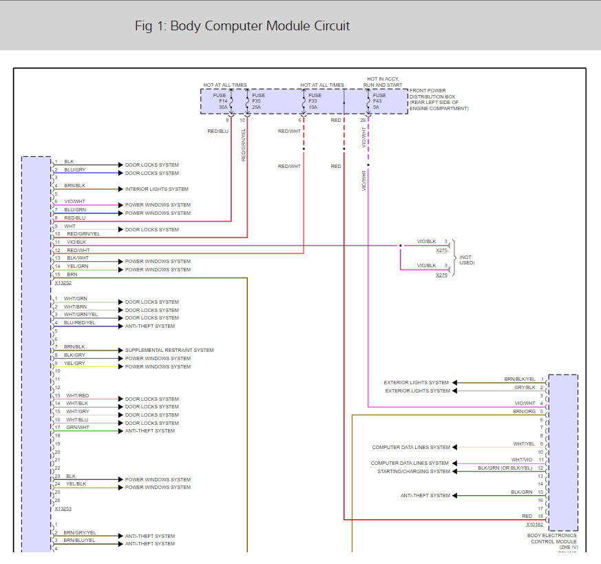

My car was parked for about four days. Went to use it today and multiple items will not work. Power windows, radio, fuel gauge. I checked the individual fuses and they all look good. Is there one fuse or relay that would control those items?
Sep 19, 2018 at 10:02 AM
  • 55,224 POSTS

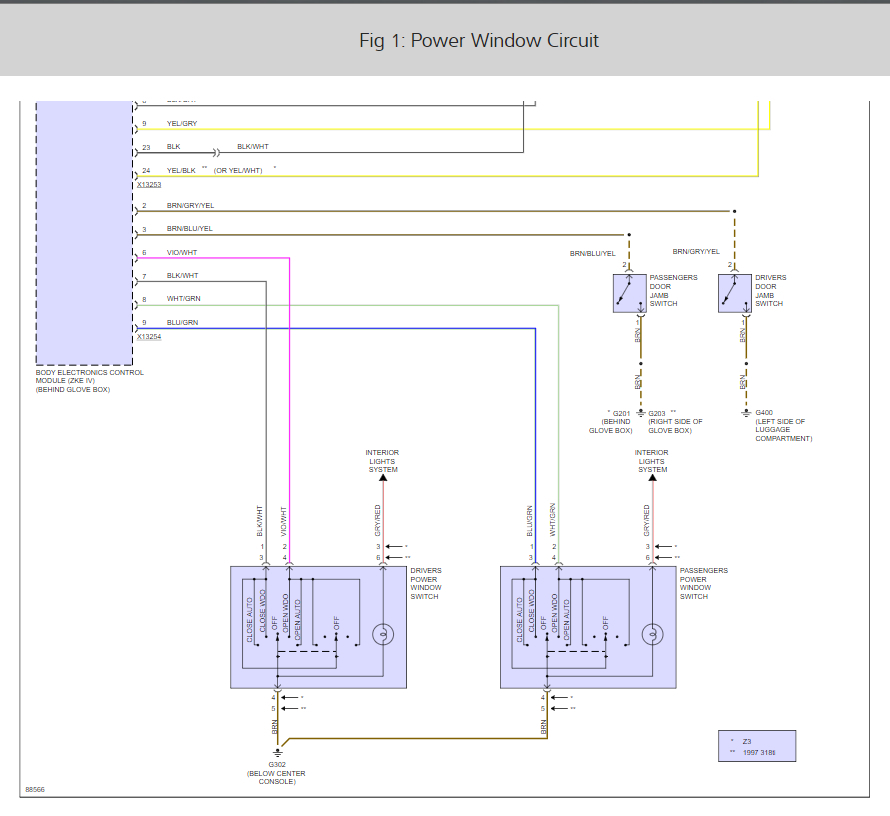

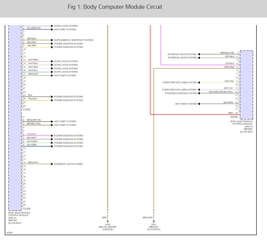

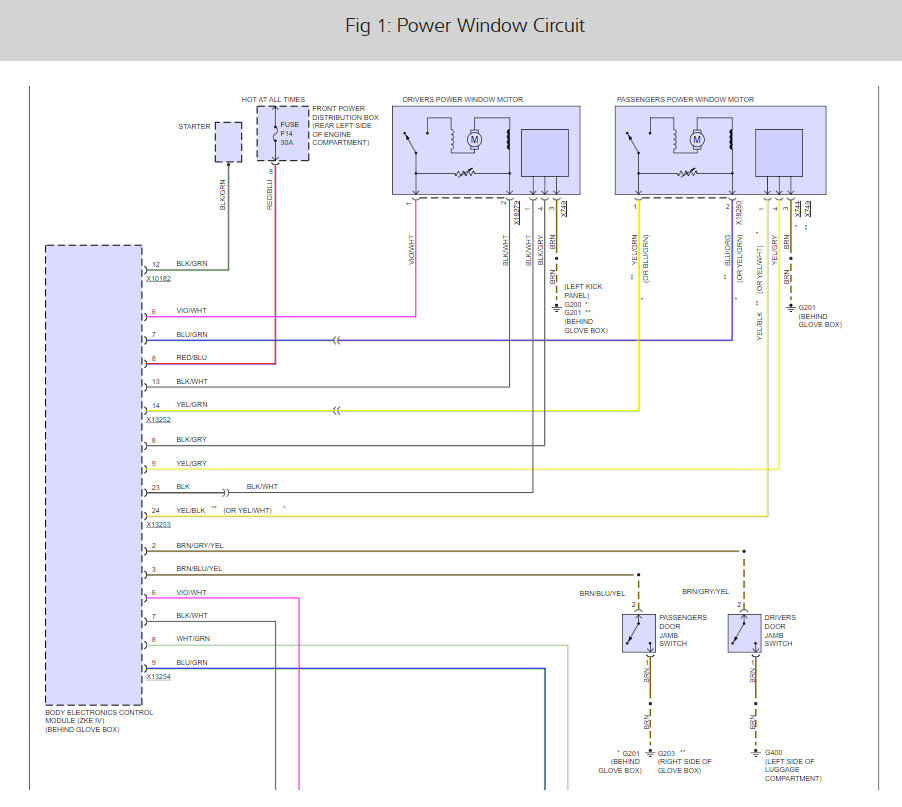

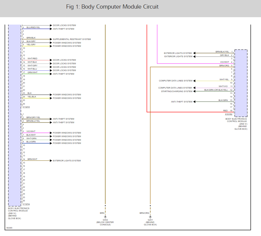

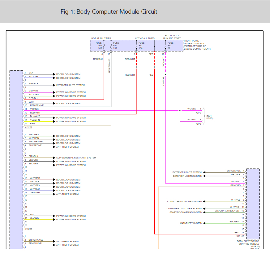

It sounds like the BCM behind the glove box has gone out. Here are the wiring diagrams so you can see how the system works. I would get a used one and plug it in to see what happens. You might need to get it initialized at the shop which should run about $130.00.
Component ID A104, Body Electronics Control Module (ZKE IV)
Location Behind Glove Box
