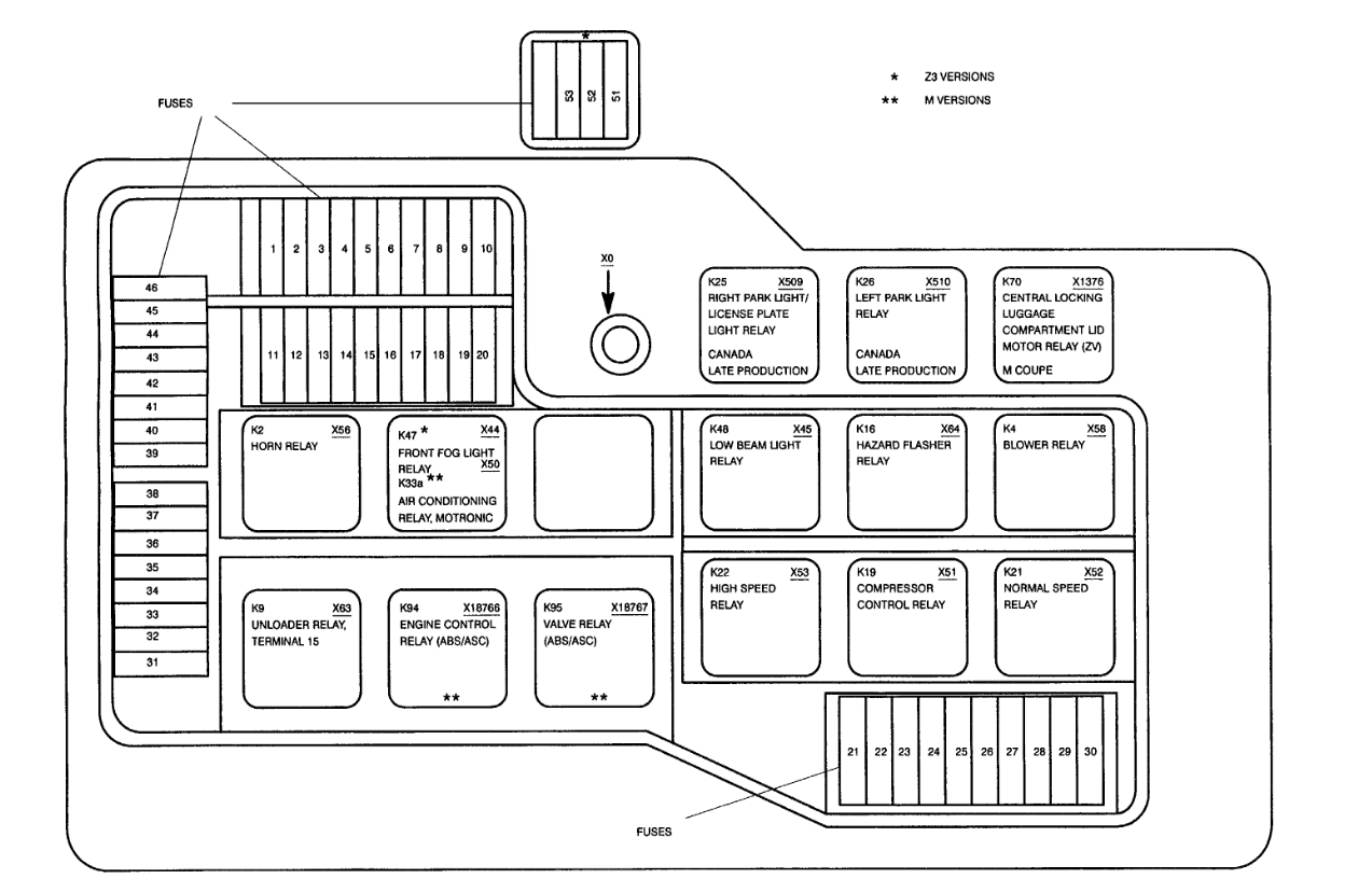

In a morning the rev / temp / fuel gauges do not work everything else is fine !! drive 3 - miles with the car now warmed up stop and restart all gauges work as normal any ideas please.
Oct 18, 2010 at 1:36 AM
DOCHAGERTY
  • 9,606 POSTS

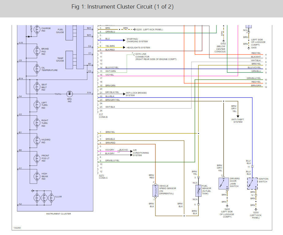

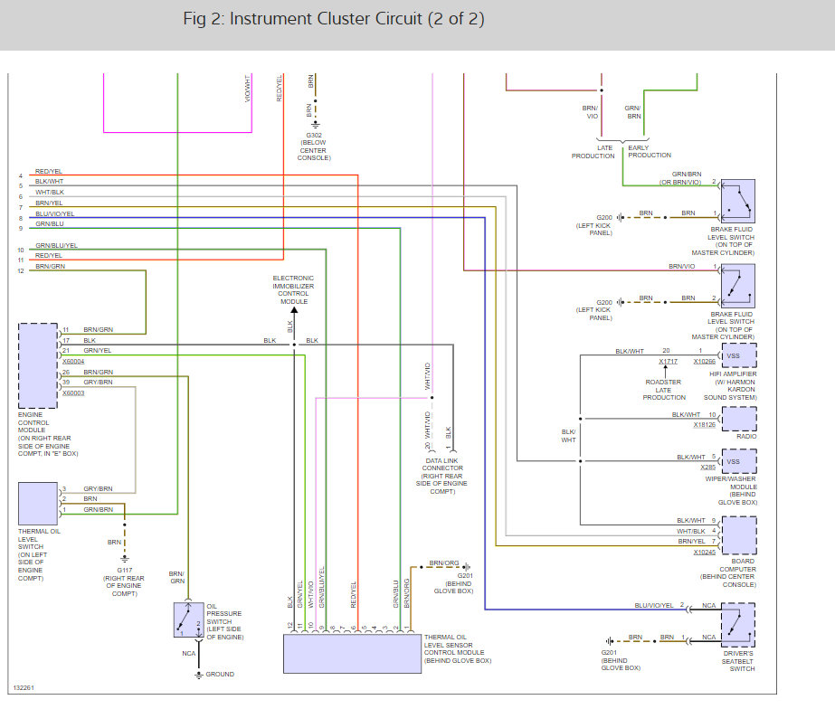

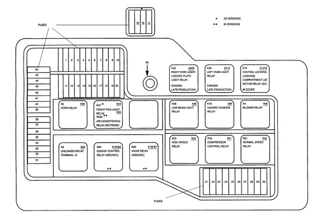

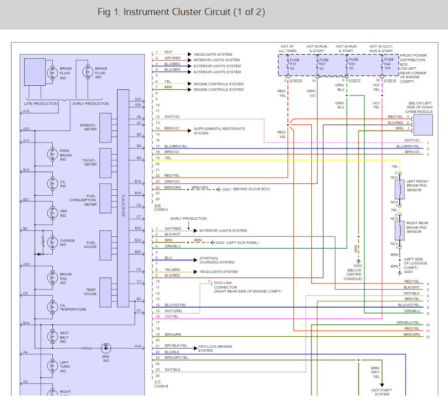

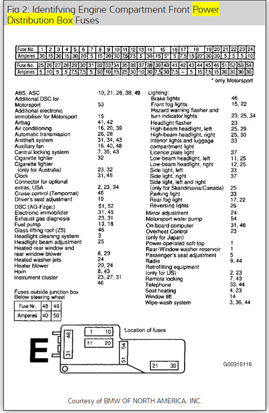

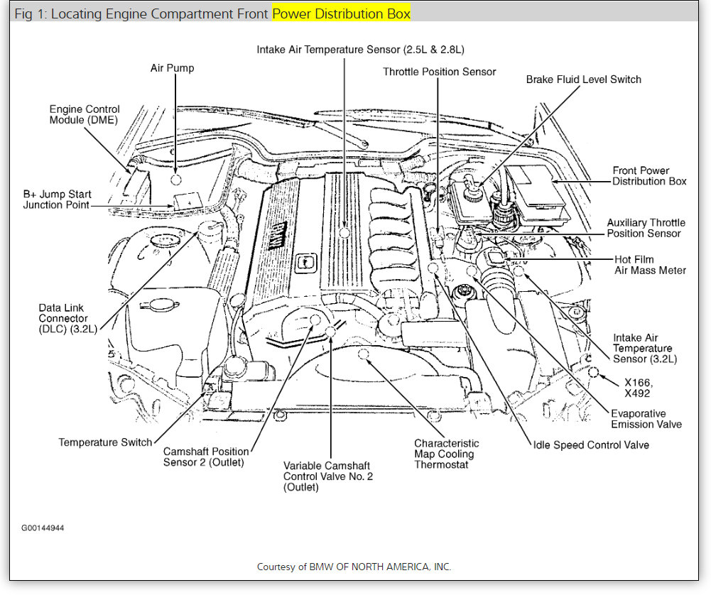

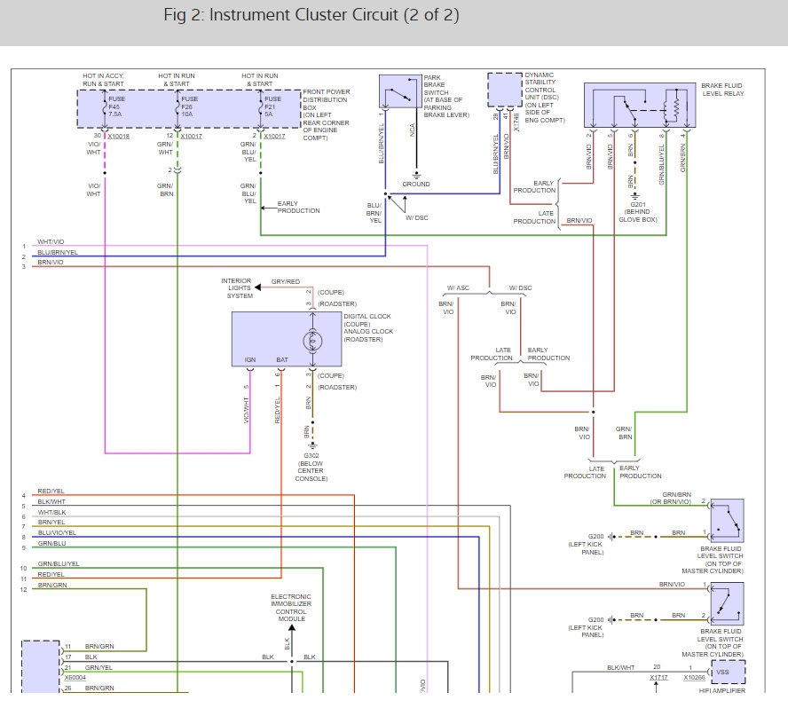

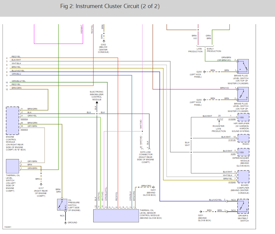

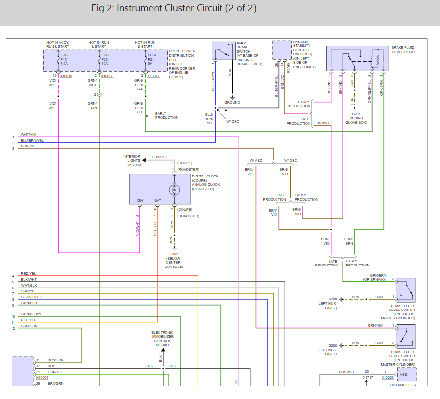

There are 7 fuses that run the cluster here is a guide to help you check them and the fuse locations with the instrument cluster wiring diagrams so you can see which fuses to check and how the system works.
Oct 18, 2010 at 2:18 AM
HELIPIL0T
I have tried that the fuel gauge gives a little movement then goes back to zero, Once i have run for a few miles and the interior of the car is warm on a restart all works fine, i know it sounds stupid but it appears to be temperature related.
