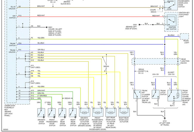

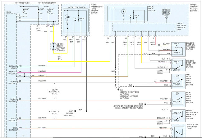

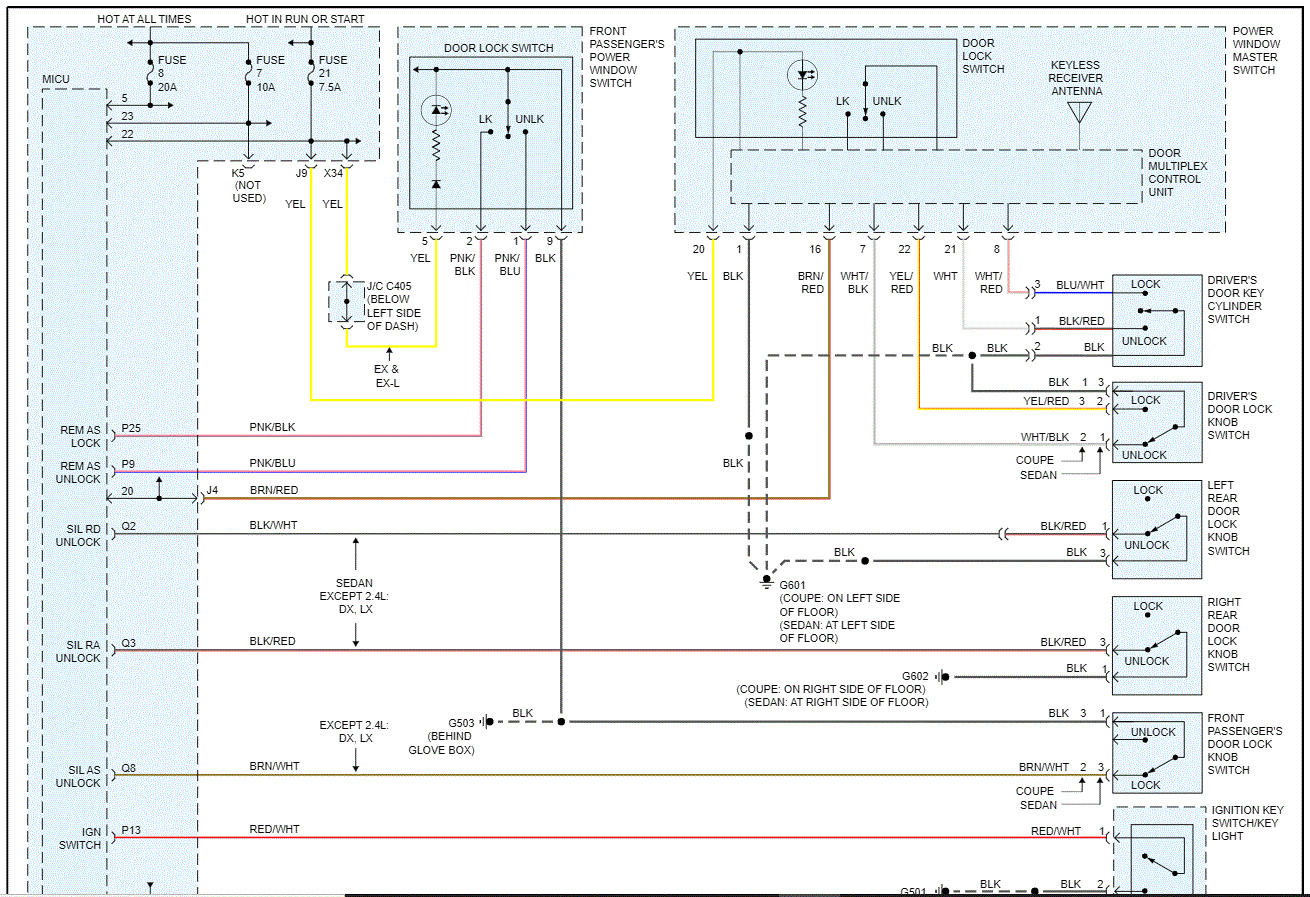

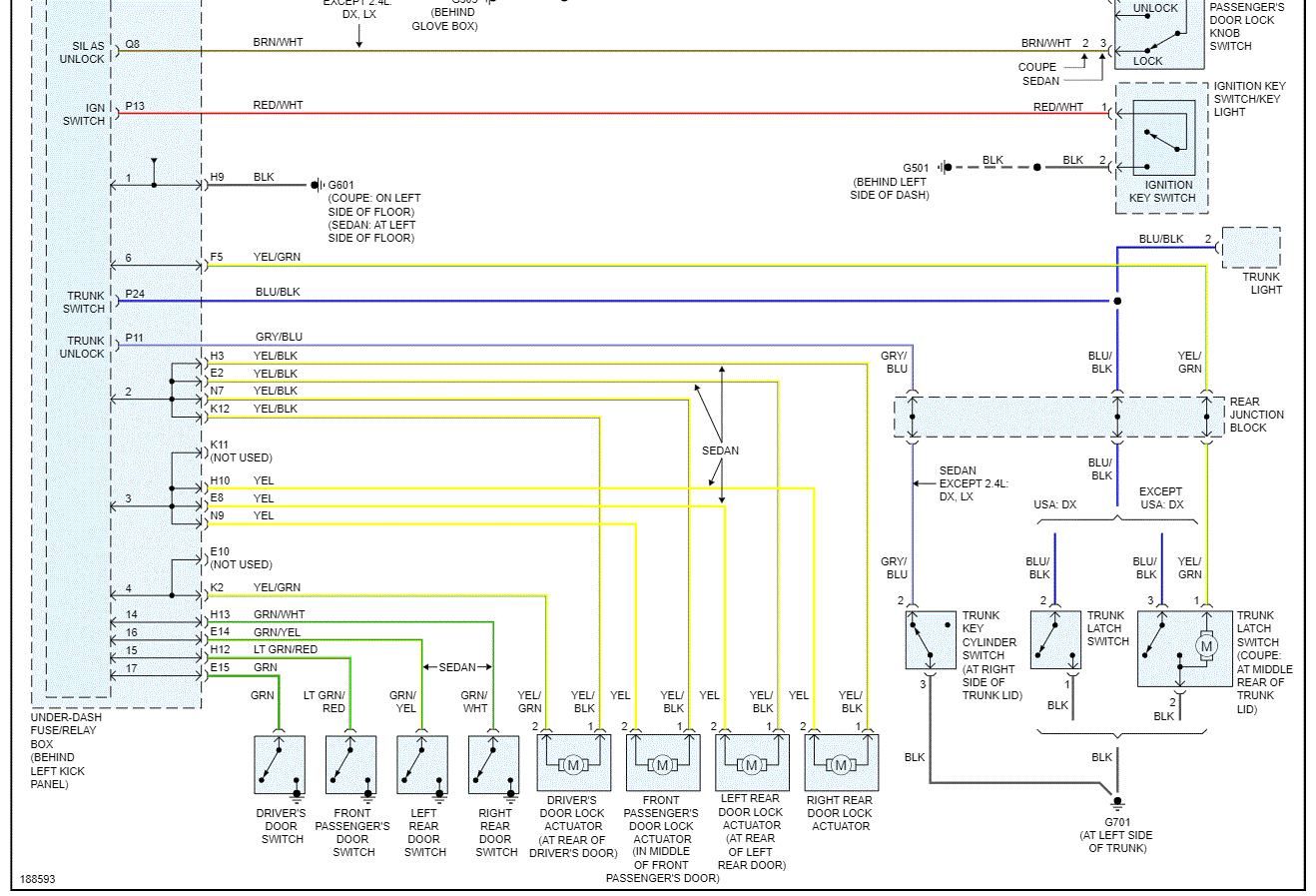

Central locking system sounds like unlocking or locking, lights flick but not unlocking.
Jan 4, 2022 at 4:49 AM
  • 110,240 POSTS
Is this happening at all doors or just the driver's door? If it is all of them and it happened all at once, let me know that as well. There could be something preventing enough voltage from reaching the actuators.
For your reference, I attached a wiring schematic showing the circuits involved. If this happened to all of the locks at once, go to one of the actuators and see if there is 12v+when you request lock or unlock.
take care,
See pics below. Note: I had to cut the schematic in half to make it readable for you. I did overlap them so you can follow from one to the next.
