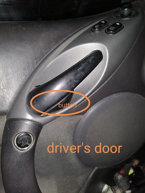

Tonight, I noticed a malfunction, or maybe some misunderstanding from my side. When you sit inside the car and push the knob under the opening handle on the driver's door, both doors are locking at the same time. But then when I try to pull back the knob, the doors do not unlock. Even the handle does not help. I must turn off the car and pull out the key and press the remote unlock button to unlock the doors. Thanks for your instructions.

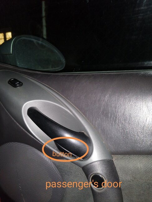

1. Unlocked the car with remote and entered inside. Push passenger's button, that door locks (just mechanically, not heard electromotor noise) pull it back, door unlocked.
2. Key not in, engine not started, push driver's button, both doors lock. Pull the button back, it makes tension and backs in lock position. Pull passenger's button, the same. Push unlock remote key button once, driver's door unlocks, push once more, passenger's door unlocks too.
3. Started the engine and push driver's button, both doors locked. Tried pull back, it moved back with tension.
4. Press unlock remote button while engine still running, nothing happens.
5. Turn off engine, key still in, pressing unlock button, driver's door unlocks, press again, passenger's door unlocks too.
Monday, February 13th, 2023 AT 3:10 PM

When I lock only passenger door by its button, it is locked and when pull back that button it unlocks (in that case, electrical actions are not heard, like buzzing from electromagnetic actuators on the central, just a mechanical click).
But when pressed driver's door button, electrical action is heard and lock both doors. Then passenger door can also be not unlocked by pulling back it's button, because it goes back in locked position after pulling backward.
In that case, a remote button must be used to unlock.
Also tonight, when I sit in the car to go out, I tried once more, and everything worked (but just only for once). Push the driver's button, both doors locked, pulled it back, both doors unlocked. In my second try, the problem existed again.
