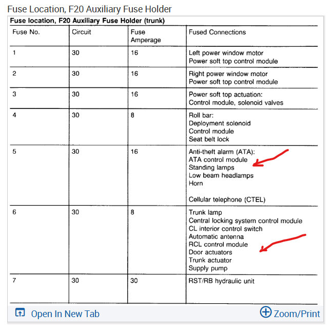

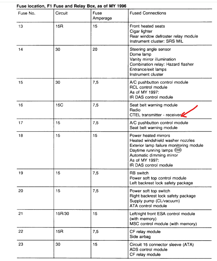

I can't Central Lock and set the Alarm using the remote control key. I have charged the batteries (Engine and Consumer) and replaced the remote key batteries also, but nothing happens when I press the remote any of the 3 buttons. the remote light (red) does come on, on the remote.

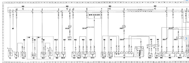

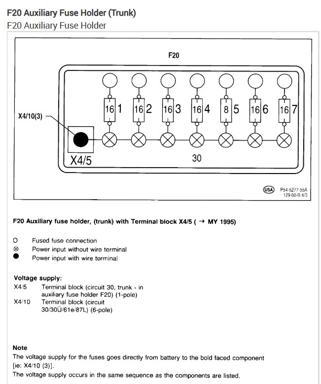

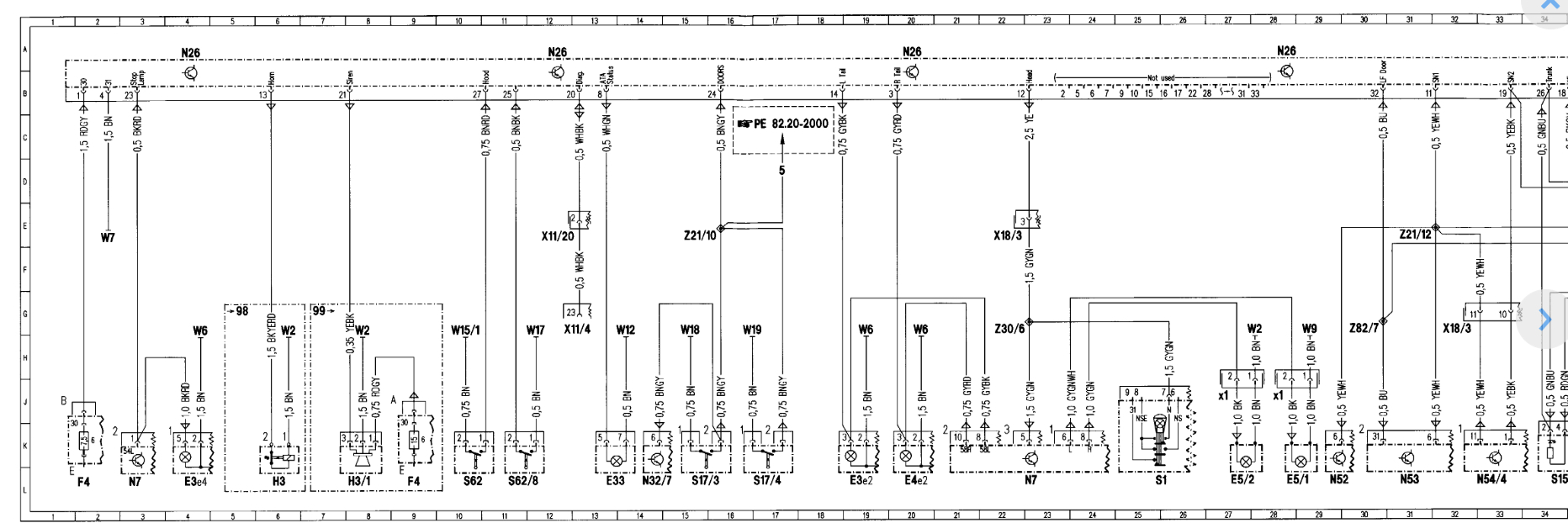

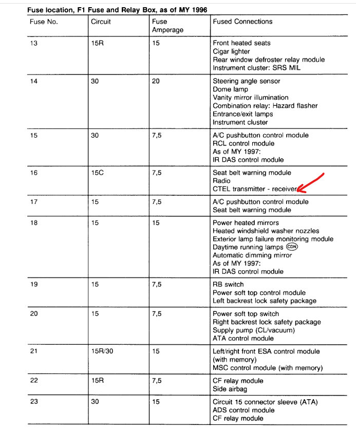

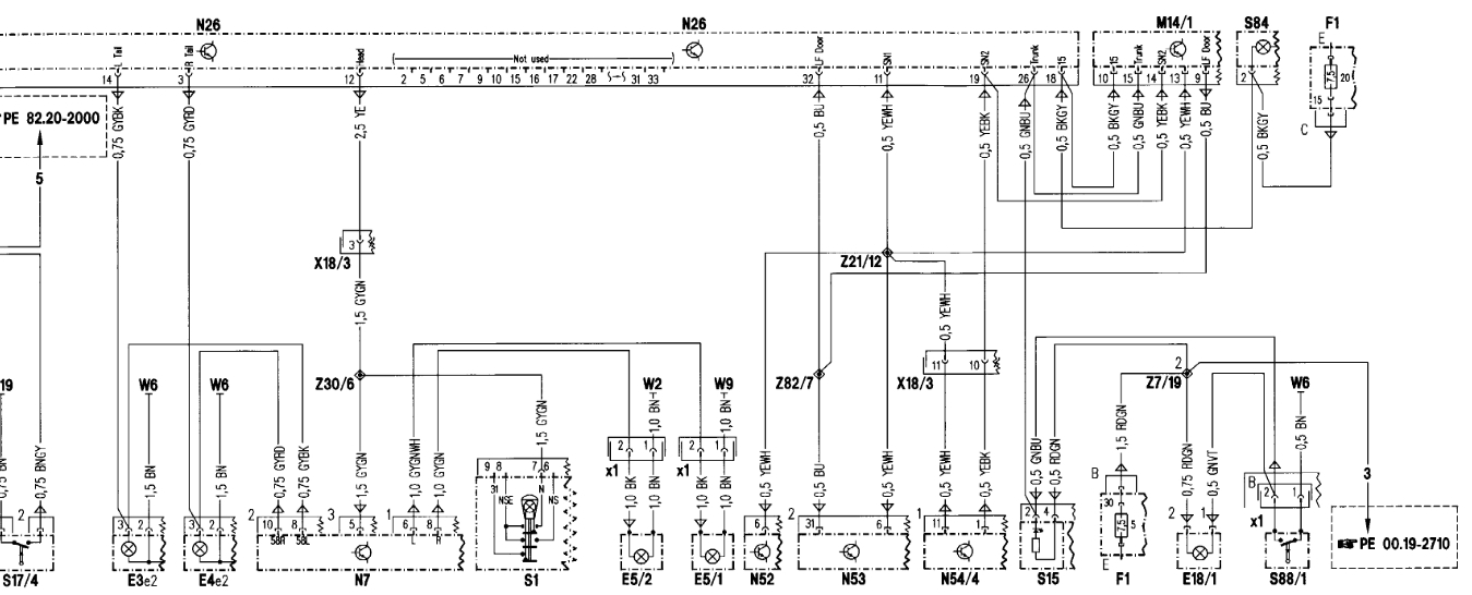

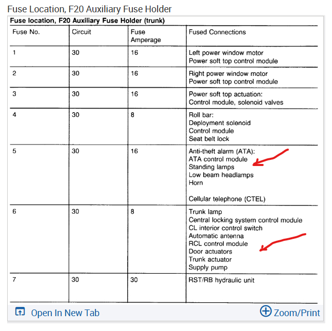

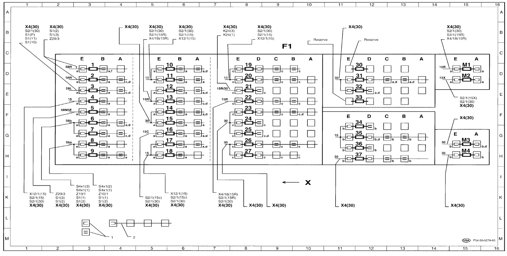

Opps, sorry read it too fast. I would check the fuses #16, # 5 and #6 in the trunk for the security system and if they are okay let's do a CAN scan, this video will help:
https://youtu.be/u-4syLc-ifQ
Here are the wiring diagrams for the system. Here are the fuse locations. Check out the images (below). Please let us know what happens.
