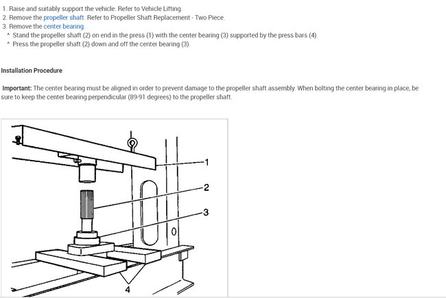

I’m trying to find out which size center support bearing I need to get for my truck listed above 1500 based off a VIN search. Where can I go to look up the VIN information?

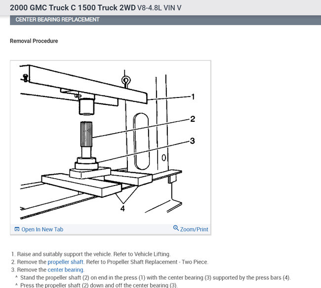

Yep, they don't show it, you will need to call the dealer for the part number. here is how you can press the bearing out though. Check out the images (below). Please let us know if you need anything else to get the problem fixed.

I eventually was able to pull up and get you when I believed to be the correct dimensions will find out tomorrow when I swap them out. i will update and let you know.
