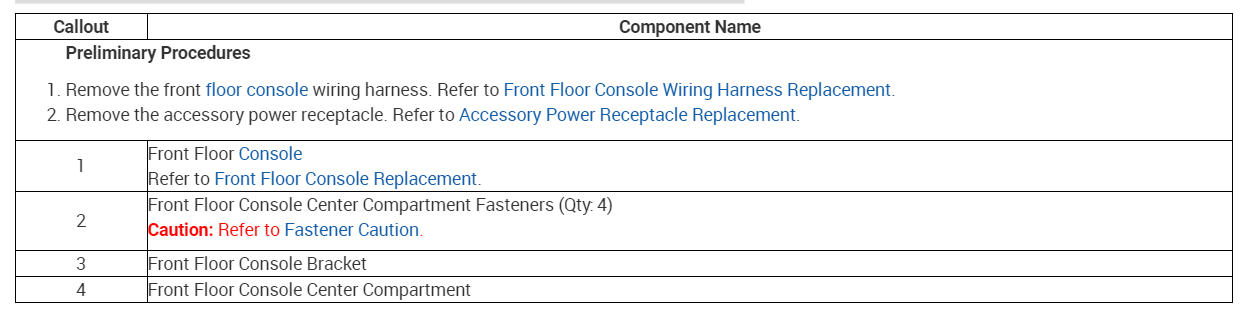

Lost phone behind center glovebox of the car listed above, is there any way to get it out?
2018 BUICK ENCORE
70,000 MILES • 4 CYL • TURBO • 2WD • AUTOMATIC
BWELUC26
Lost phone behind center glovebox of the car listed above.
Jun 18, 2023 at 10:23 AM
  • 55,423 POSTS

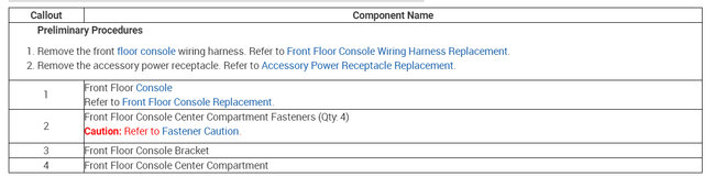

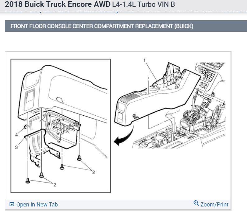

Yep, it happens, the only way to retrieve the phone is to remove the center glove box. here is how in the images below. Let us know what happens and please upload pictures or videos of the problem so we can see what's going on.
