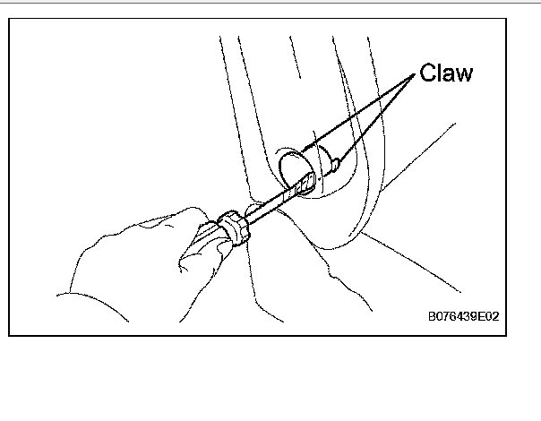

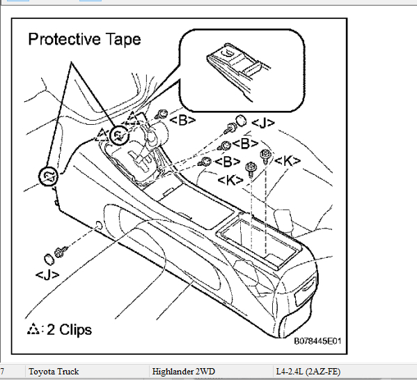

Last month I had to swap a SIM card to another phone, and unfortunately it fell by accident on the part between the cupholder lid and the frame. seems that I have to remove the entire center console to take the SIM card out. Any tips on it? Pictures would be greatly appreciated. Thanks in advance.

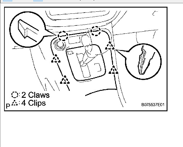

Remove instrument cluster finish panel assembly center.
A. using a moulding remover, disengage the 4 clips and the 2 claws (check the picture 1 bellow).
set the shift lever in the N position.
B. disconnect the connector ,then remove the instrument cluster finish panel assembly center.
C. remove floor carpet cover center LH
remove the 2 clips and the floor carpet cover center LH check picture 2 below.
remove floor carpet cover center RH.

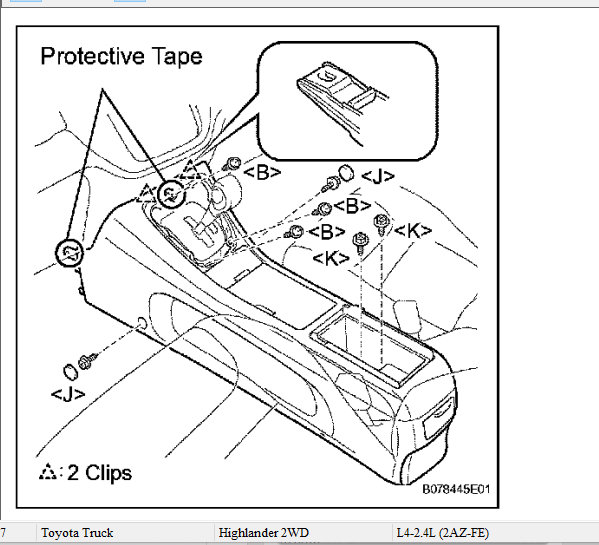

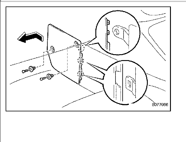

D. remove front seat armrest assembly center
using a screwdriver, disengage the 2 claws and remove the seat armrest cover LH. check picture 3 below.
Hint: tape the screwdriver tip, before use.
remove the bolt and the front seat armrest assembly center.

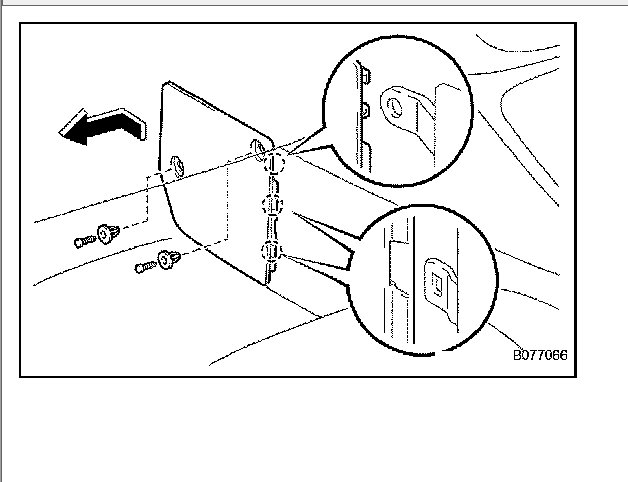

E. remove console box assembly. check picture 4 below.
cover the parts indicated in the illustration with protective tape to prevent them from being damaged.
Remove the 3 screws(B)
Remove the 2 console caps and the 2 screws (J)
Remove the 2 bolts (K)
Pull the console box assembly towards the rear of the vehicle and disengage the 2 clips, and then remove the console box assembly.
Note: be careful not to damage the bottom of the instrument panel safety pad when removing the console box assembly.
