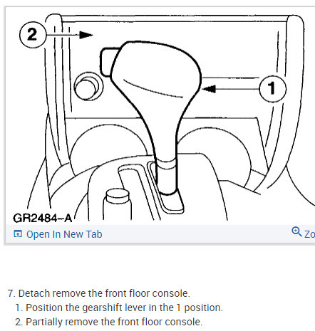

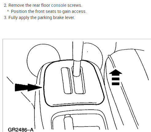

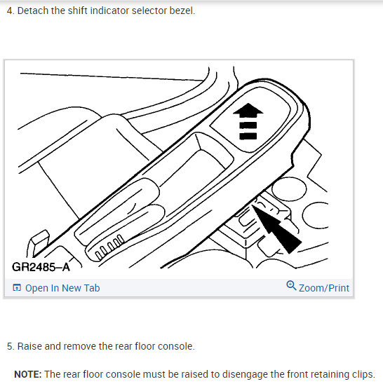

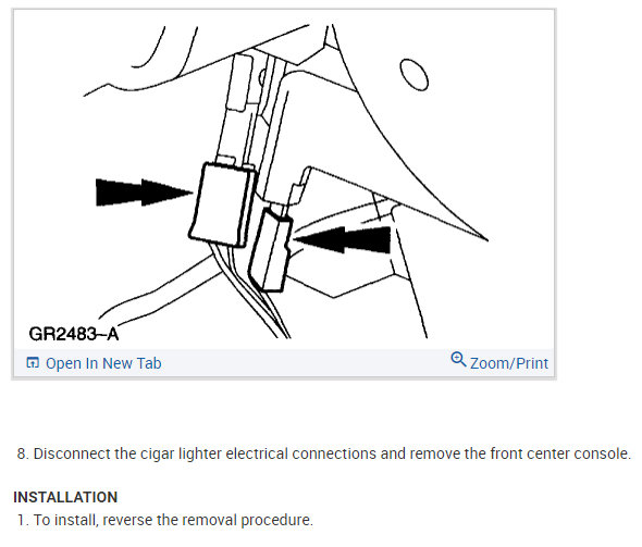

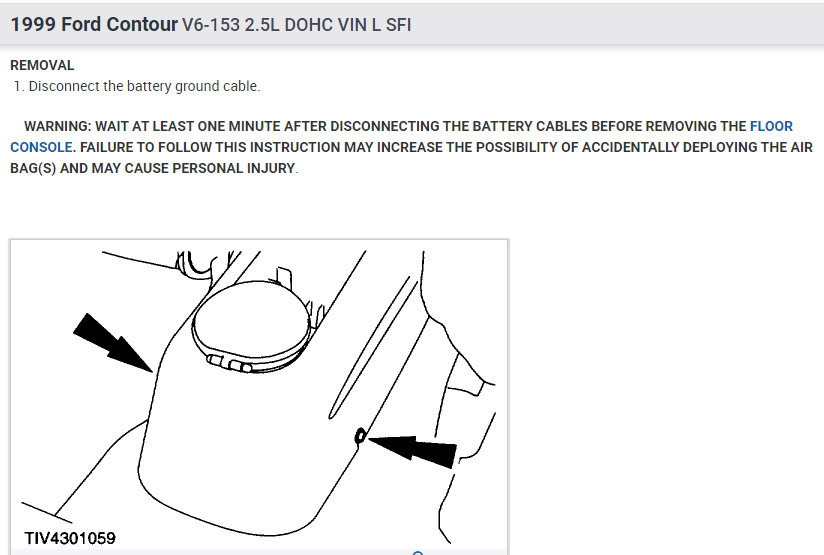

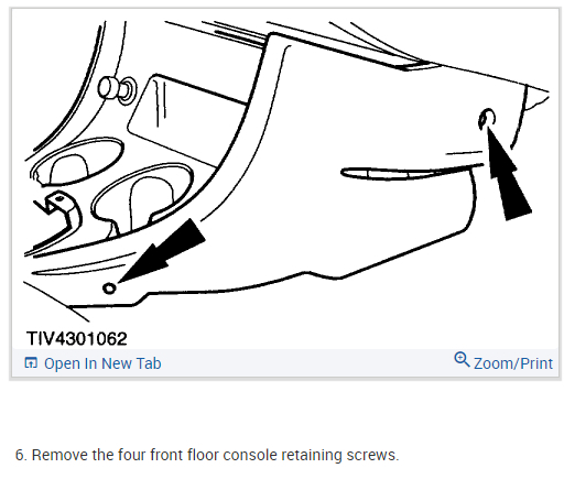

Looking for an exploded view of a center console.
Mar 18, 2021 at 11:48 AM
DANNY L
Experienced Mechanic
5,648 POSTS
Hello, I'm Danny.
This is what I found for a center console. It shows pictures on how to remove and replace. I've attached picture steps below for you. Hope this helps and thanks for using 2CarPros.
