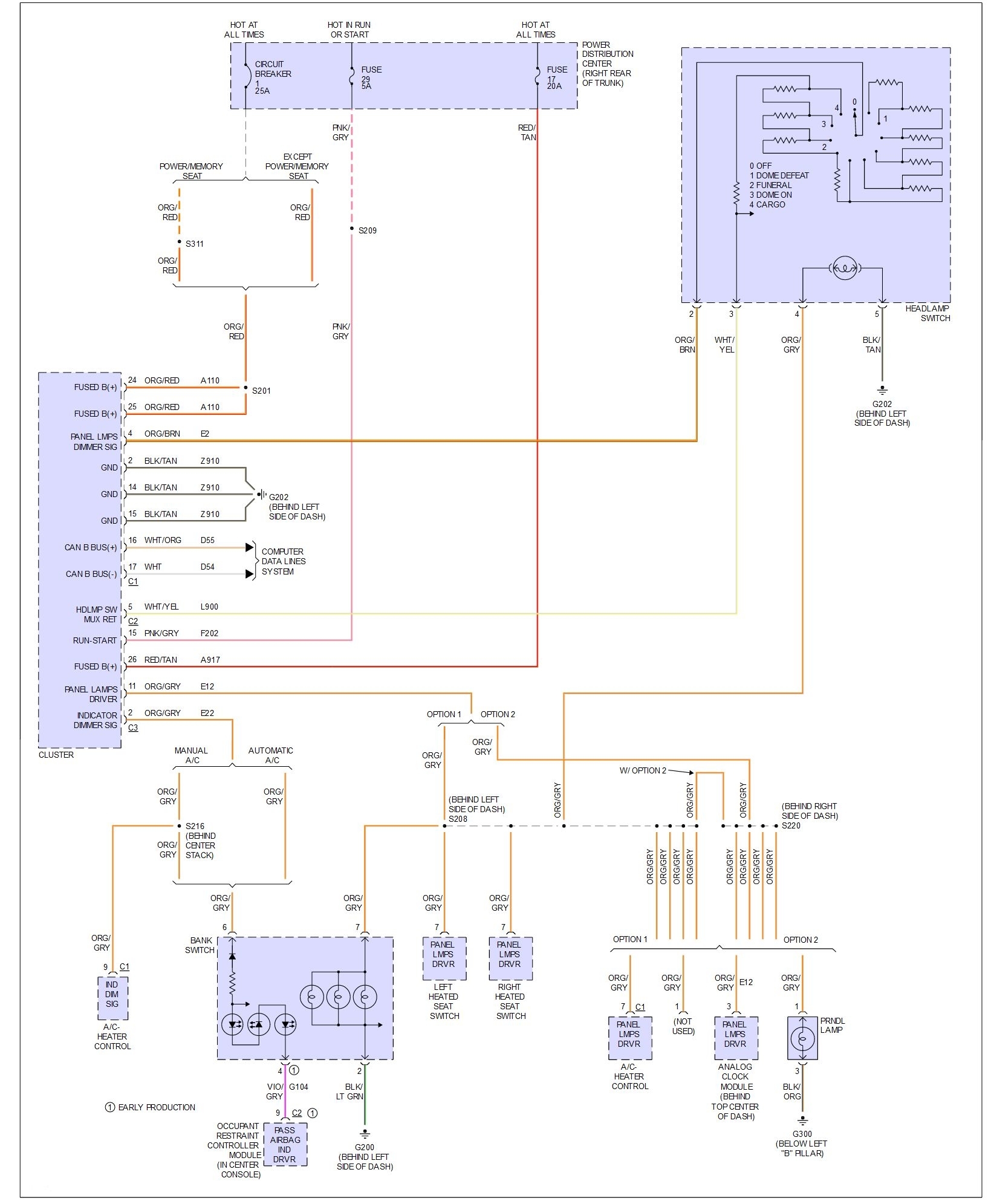

my center console lights went out including analog clock, heated seat lights and prndl shifter light. they all work so what fuse will it be? I checked all the recommended ones in the rear fuse box they all seem fine.
May 16, 2017 at 12:07 AM
STEVE W.
  • 15,345 POSTS
Looking at the wiring diagram if fuses 17 and 29 in the right rear fuse panel test okay (use a test light connected to ground and touch the probe to both of the pins on top of the fuses) then the actual cluster in the dash is the most likely culprit. It feeds those lamps off a different lamp driver.
To see if there is power at the cluster requires the cluster be removed to get to the wiring, then test the orange/gray wire at pin E12 for power.

Hey so i tested those fuses as well again and also the wire test for the orange/grey wire and my tester light came on so meaning it has power. I just don't understand why i have no lights on anything in the center console
May 16, 2017 at 10:24 AM
STEVE W.
  • 15,345 POSTS
If there is power there you either have a failed inline splice or there is a ground issue. The attached is the wiring for those lights. Trace the power and grounds. Note that there are 2 wires of the same color that feed the lights from the console.

Yeah, it's either a ground issue or there is a connection point in the power feed that isn't shown on the diagram. You could test them easier though. As they are all 12V lights run a wire from the battery positive down to one of the lights and feed 12v into the orange/gray power side. If they all light up you have a broken power feed. I suspect it's someplace in the power side because the seat switches and prindl don't share a ground.

So what wire so for he lighting on these? Im guessing the orange/grey is the power source right? Because this started I believe when i unplugged my hvac control switch and plugged it back in the whole interior light dimmed while plugged and starter smoking a bit so i unplugged it waited and since then the lights are out but can't figure out what happened.
May 18, 2017 at 8:10 AM
STEVE W.
  • 15,345 POSTS
OK, you will want to check that a pin didn't get bent and fry the power feed wire.

There are multiple pins in that connector, if the light power feed pin was bent and then grounded out and stayed that way you would have no lights because of that. The smoke means something shorted and burned. You need to determine what.

It has to be somewhere on the power feed side. The problem is finding it. I'm betting that the smoke you saw was a driver circuit burning out. It will probably take a new dash cluster to repair it, that will need to be programmed to match the vehicle.

The cluster has the light driver in it which controls the lights you are missing. If the other items check out it's about the only thing if the wire itself isn't burnt out. Have you tried putting 12 volts on one of the "bad" lights power feed and seeing if they all light up? If they light then you have a good ground and the wiring to the lights is good, it almost has to be the light driver in the gauge cluster then, or the trace that feeds the lights burnt.
