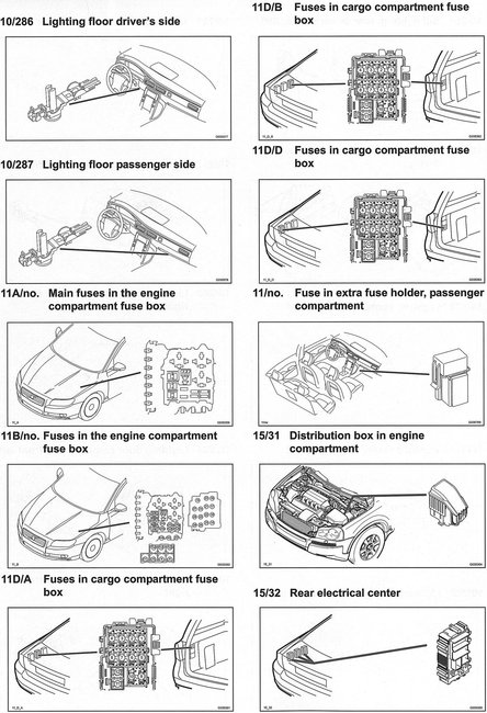

AL514
  • 5,639 POSTS
Heres the location of all the fuse panels, looks like you have fuse panels in the rear of the vehicle and in the engine compartment. You can check these fuses with the key ON engine off with a test light (check for power on both sides of the fuse) or take them out and manually check them. Hopes this helps. Let us know what you find and we will go from there.
Sep 18, 2016 at 11:02 AM

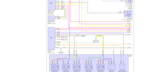

Which fuses did you find bad? #'s? I'm looking at the wiring diagrams and there is a climate control system relay as well.
Sep 20, 2016 at 5:20 AM

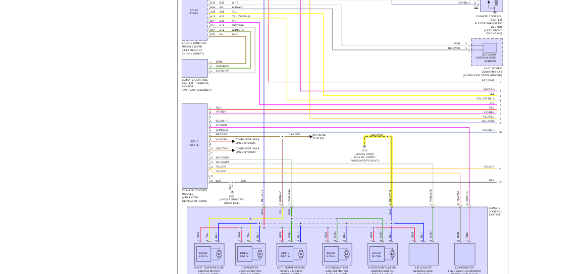

AL514
  • 5,639 POSTS
also there is a shared ground wired under the right side of the pass seat, it is a black and white wire. It is highlighted in yellow on this diagram. make sure this wire is grounded properly under the seat. There seems to be few different relays controlling this unit and the HVAC control unit is a solid state, it wouldn't be a good thing if they got any liquids into this.
Sep 20, 2016 at 5:41 AM

AL514
  • 5,639 POSTS
ok, after looking over the wiring diagram and power distribution boxes, I see these fuses appear to be inside the car, these fuse boxes are powered by another fuse box which is located in the engine compartment on the left side forward of the strut tower. So basically another fuse box in the engine compartment is most likely going to have a fuse blown also, I'm not sure if you have checked these or not yet.
Sep 20, 2016 at 10:23 AM
AL514
  • 5,639 POSTS
This is a list of what those aux fuses control, and they all lead back to the fuse panel under the hood. Check these fuses next
Fuses: #26 right rear seat heater control module
#17 High Level front display, multimedia module, remote digital audio
receiver & digital audio broadcast module
This fuse #14 has 2, as do many others in this car. C14 fuse is Power Passenger seat switch unit. F14 Fuse is Climate Control Module
#19 Phone Module & Bluetooth phone module
So go under the hood and start checking all those fuses also, everyone. some may be bigger circuits, ie 40amp and some may be smaller, ie 5 amp. let us know what you find from there.

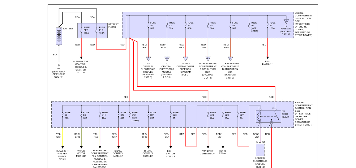

AL514
  • 5,639 POSTS
Heres the diagram for under the hood.
Sep 20, 2016 at 10:52 AM

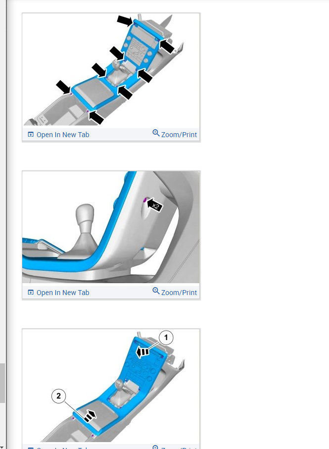

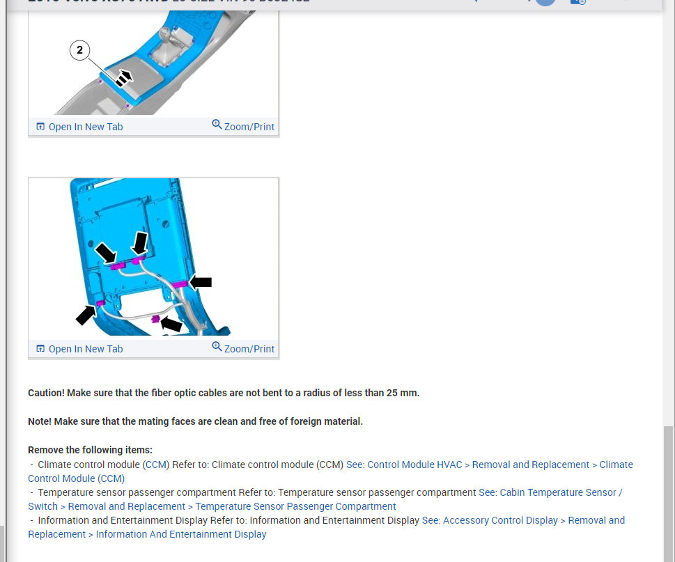

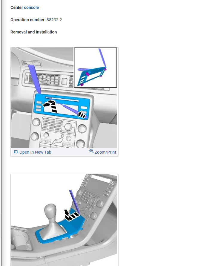

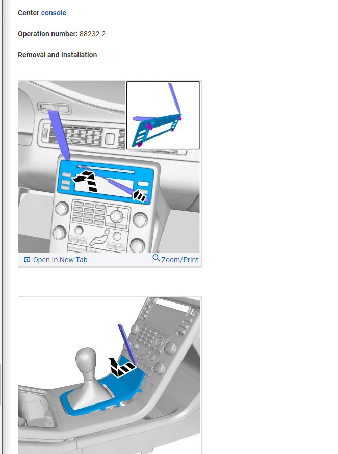

Just to jump in on this because it seems like there are a number of people that have a similar issue after a drink spill.
This commonly happens on a lot of different vehicles and unfortunately most car makers find that the space under a console (which always contains cup holders) to put some pretty important modules.
So when you spill a drink, the module can actually short out and cause different issues.
So what I would do is check the fuse boxes with a test light as AL514 talks about above using this guide to help.
If all the fuses in both panels check ok, then you need to remove the console and check the modules for signs of fluid in the connectors or that appear if it got inside the module.
Please run through this info and let us know what questions you have.
Thanks
