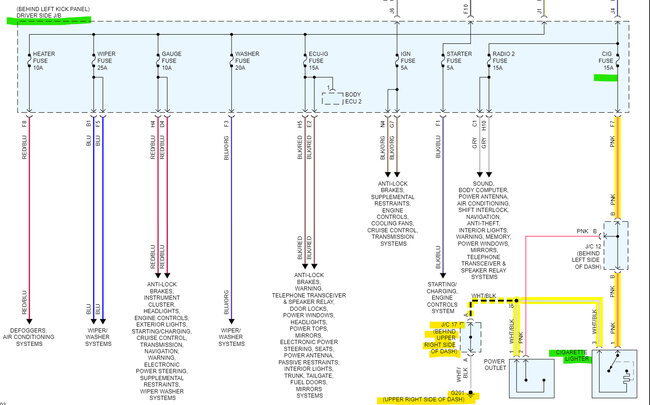

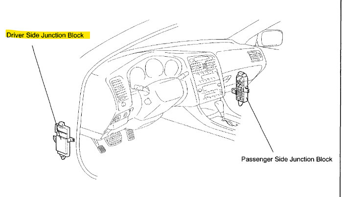

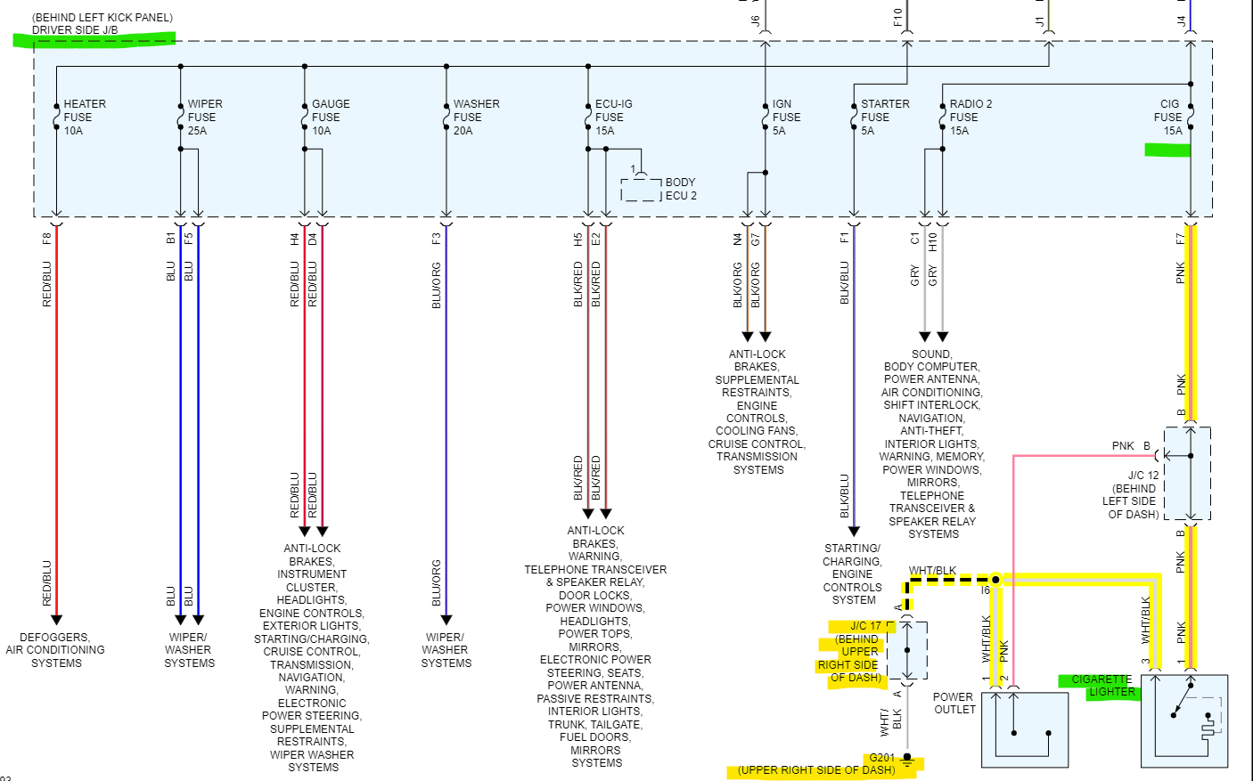

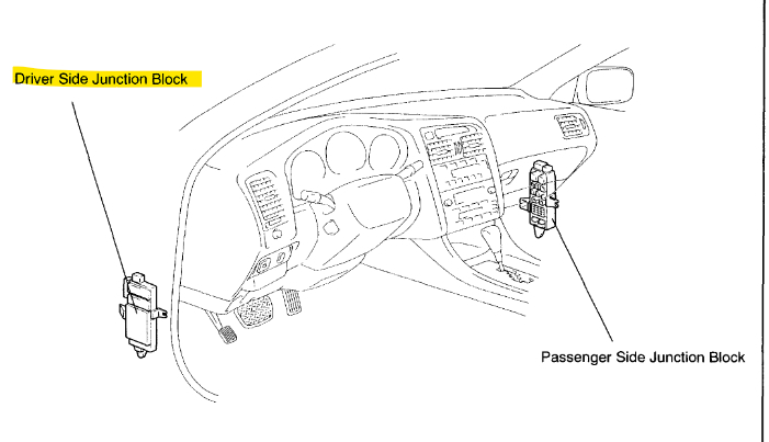

What fuse do I need for my center console cigarette lighter?
2001 LEXUS GS 300
150,000 MILES • 3.0L • 6 CYL • AUTOMATIC
LUEY707
Center console cigarette lighter.
Dec 1, 2022 at 1:55 AM
AL514
  • 5,668 POSTS
Hello, the fuse panel is located on the driver side down by where your left foot would be, it's behind the kick panel.
