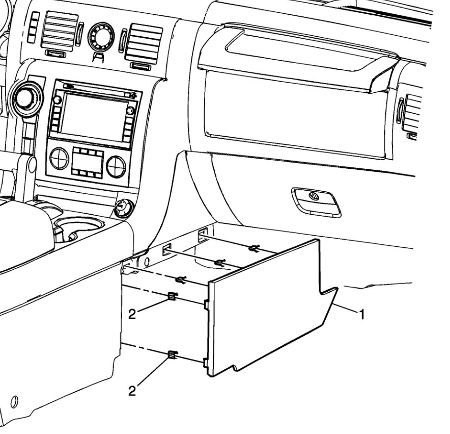

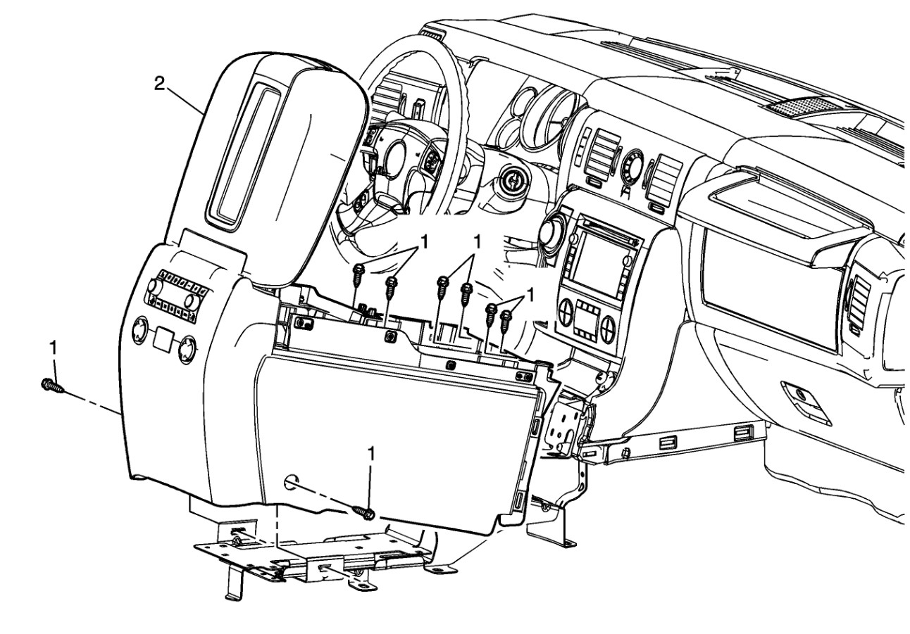

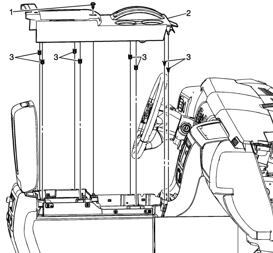

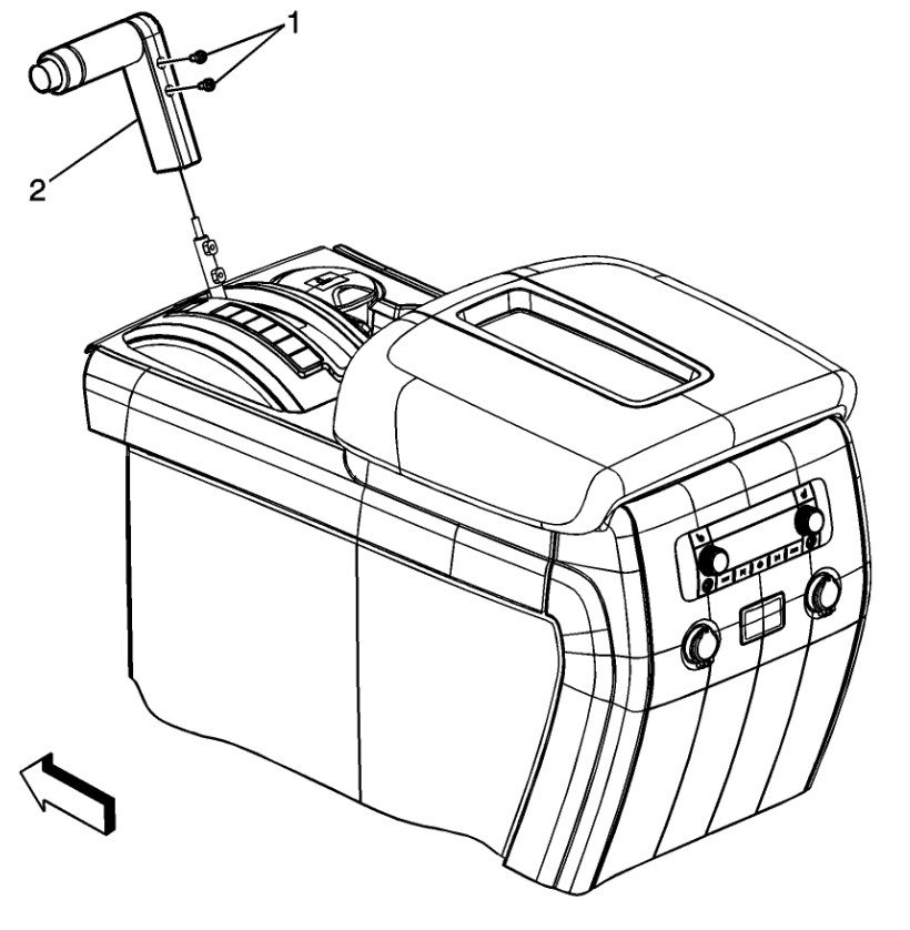

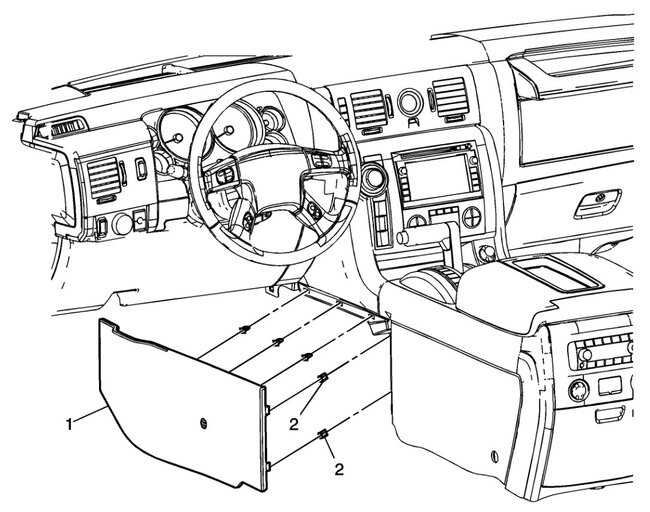

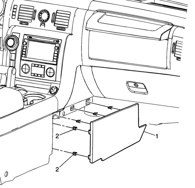

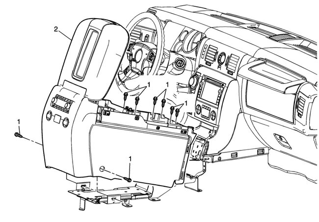

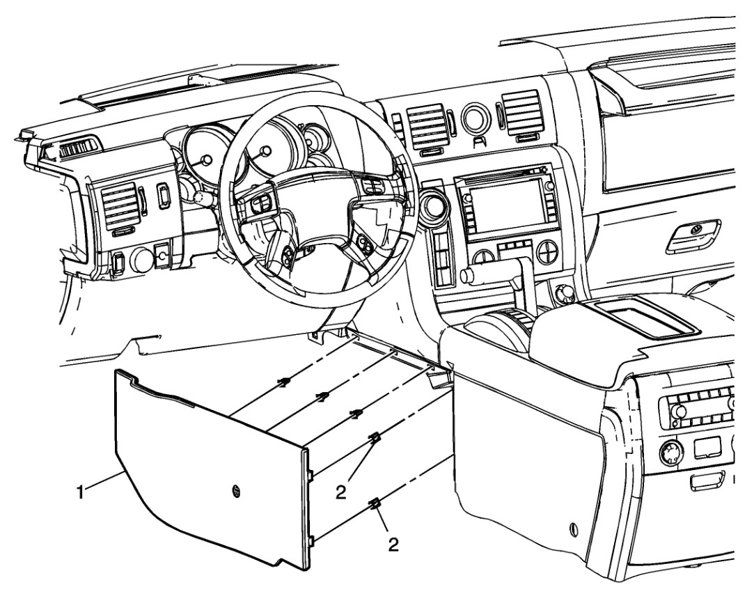

need to know to remove the center console to replace the amplifier that is underneath the console. Could you please send a video on how to remove it, with minimal damage to truck.
Thank you
Julie Sawyers
Jun 29, 2026 at 10:26 PM
STEVE W.
  • 15,413 POSTS
We don't have a video of the removal, however it isn't that hard to do without damage. You need to remove the shifter bezel, then the left and right lower instrument panel closeouts. Then you can access the screws and clips that retain the console to remove it. Those steps are all in the attached images. Use a plastic trim stick to deal with the clips. Also be advised that there are two different amplifiers used in the H2. One has no network connection to the vehicle while the other is connected and requires programming using a scan tool and interface to be replaced so it will work. The difference is in the option, the LAN connected one is capable of surround sound effects. I would determine which you have as they do not interchange, also it is not real easy if you intend to replace it with a generic amp in either case as there are a lot of speaker and modules connected.

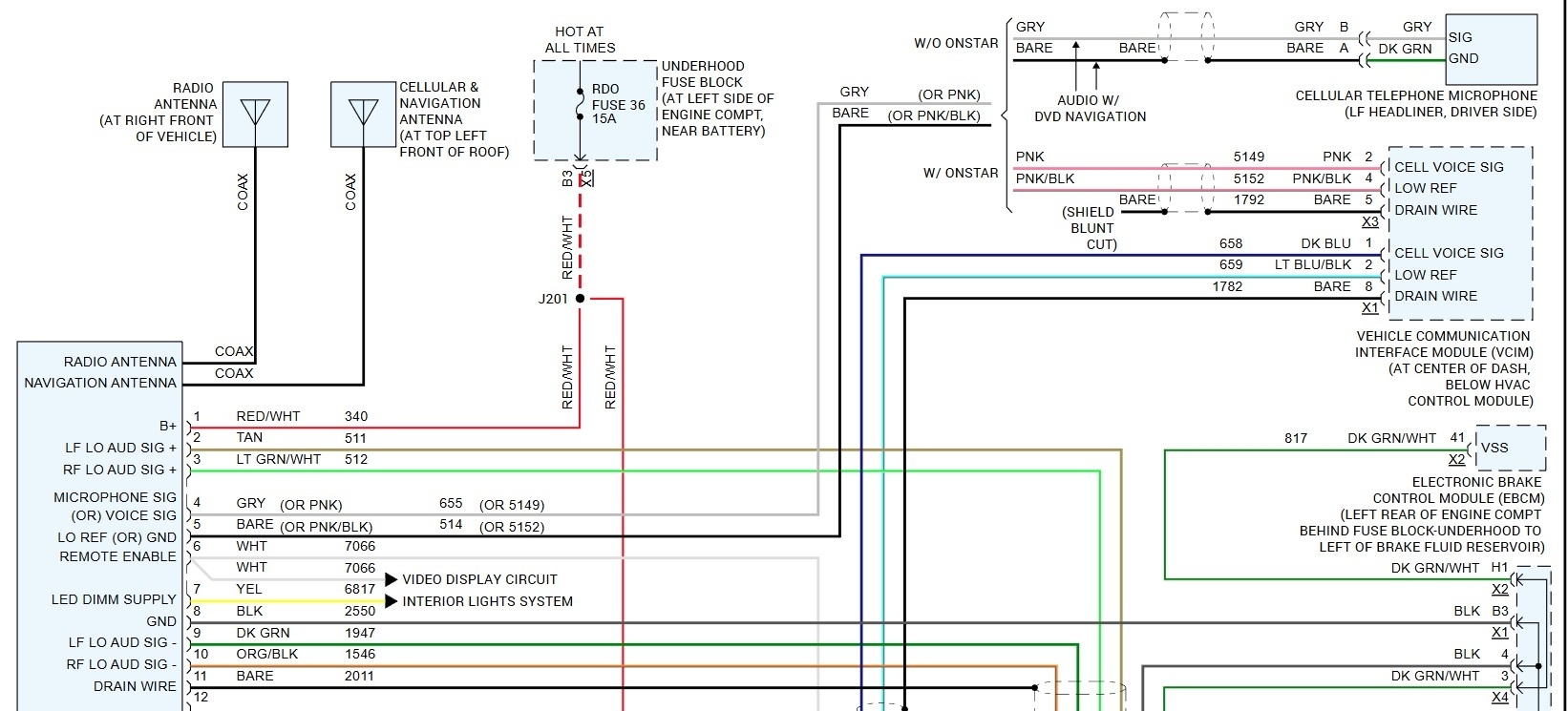

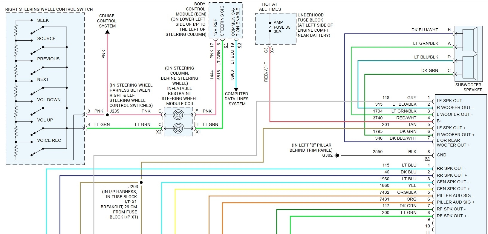

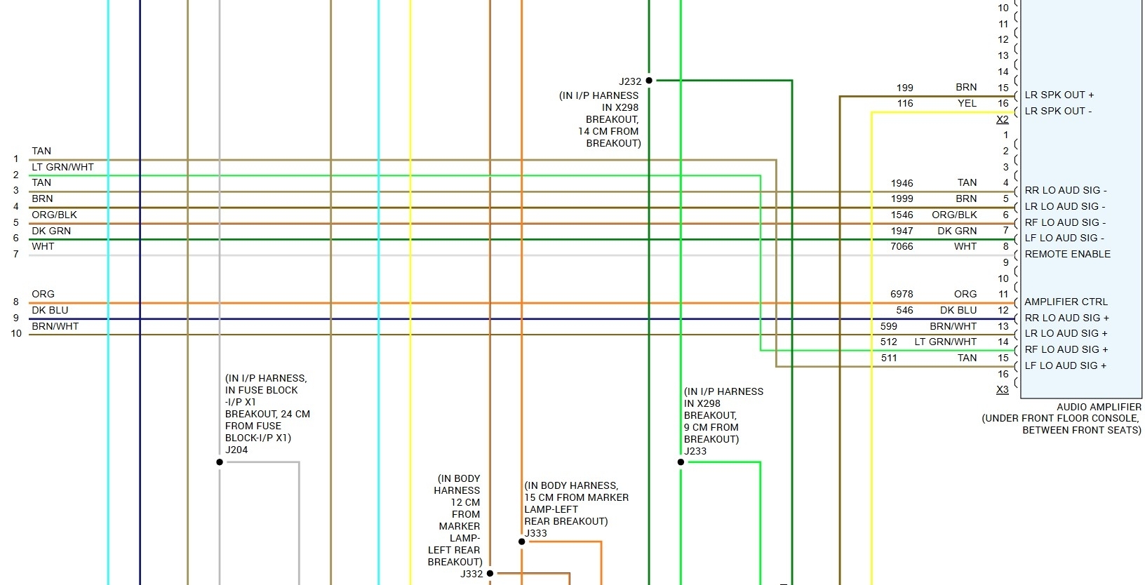

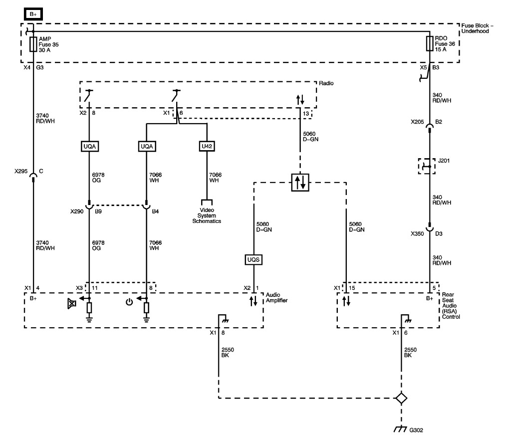

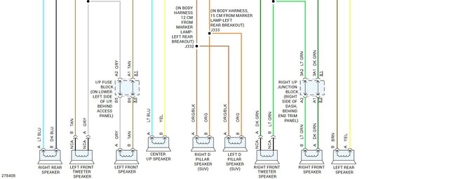

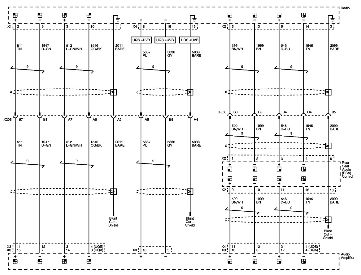

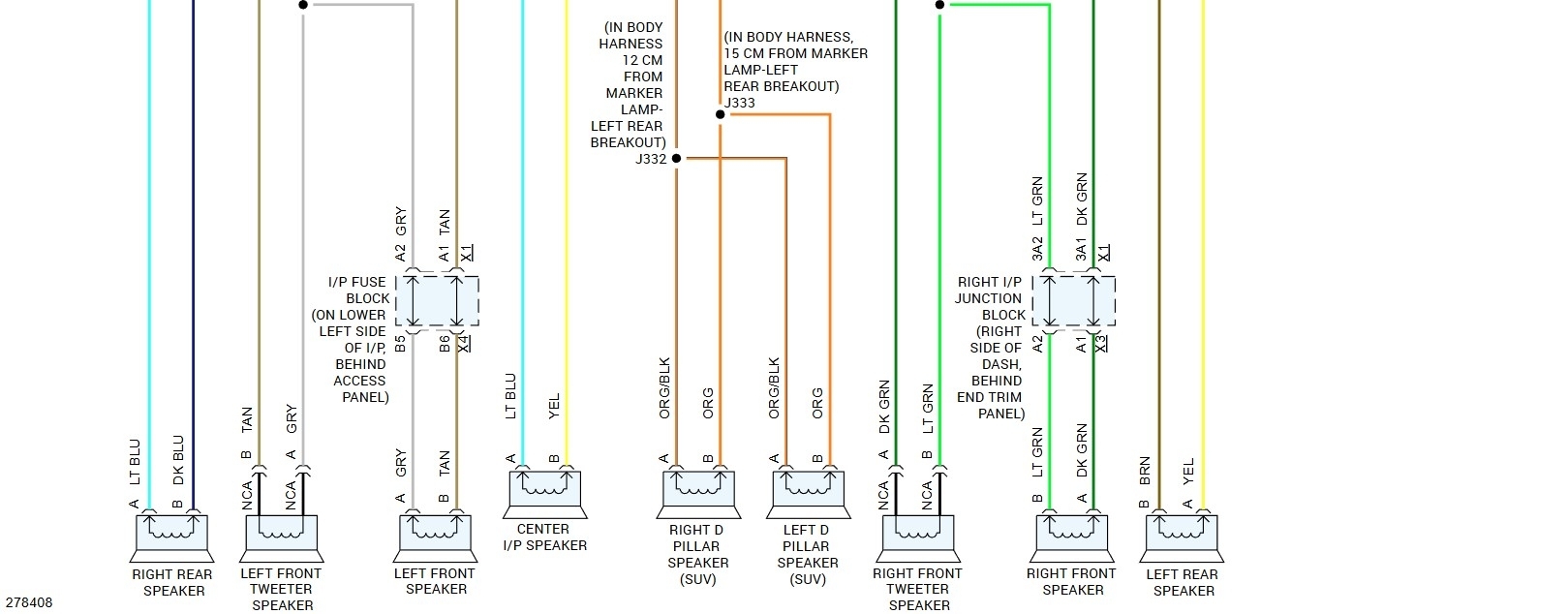

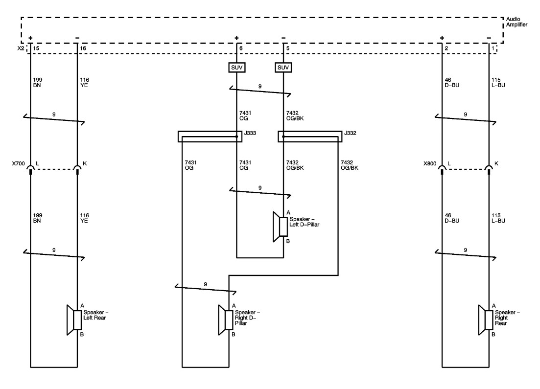

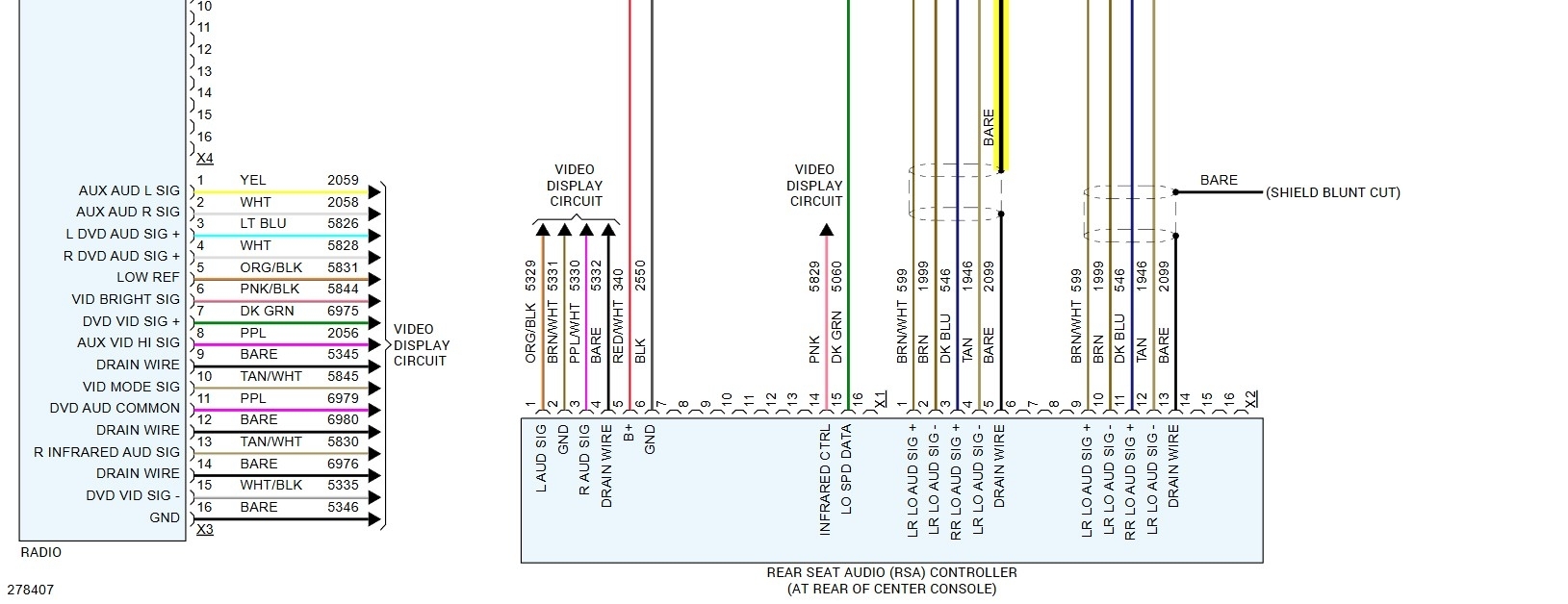

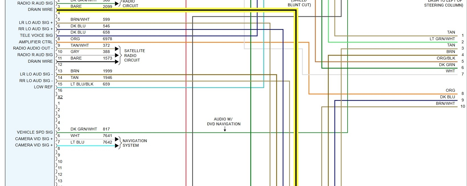

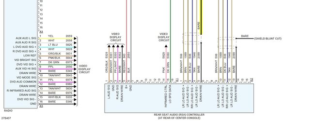

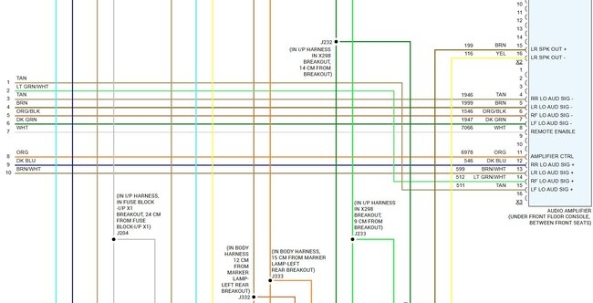

I tried the Tech 2 and it couldn't connect to the module. I would imagine the module is not powered up, thus no sound. I did hear that the UQA modules are all analog and no CAN bus connection. If that is the case, how does the chime work?
Do you have the wiring diagram for the UQA module. The wire colors and function of the radio in and amp out connections?
On the UQA models, are the speakers still 2 ohm and 10 ohm vise standard 10 ohm?
Jul 7, 2026 at 9:46 AM
STEVE W.
  • 15,413 POSTS
These are the OE diagrams for the amp and the color version. Note that they have both versions of the amp on the OE diagram with the pin numbers and any colors changed called out by option code. The speakers list the same part numbers for both systems, just the UQS has different units in the rear to handle the surround function. The color are in 6 pages, just to make them easier to read as they include the other modules instead of just the interconnects like the OE.
