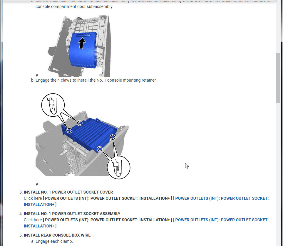

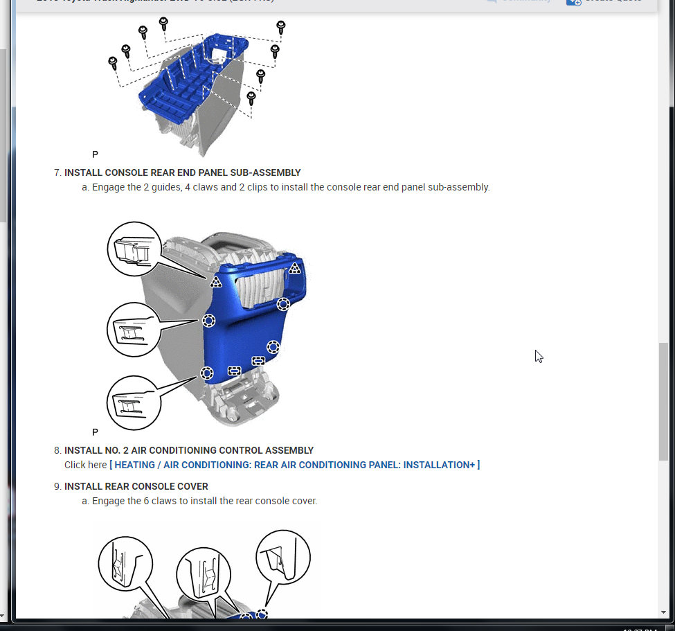

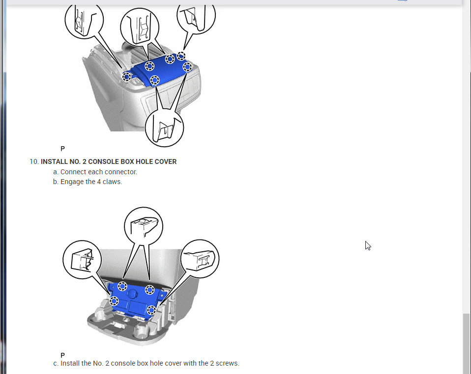

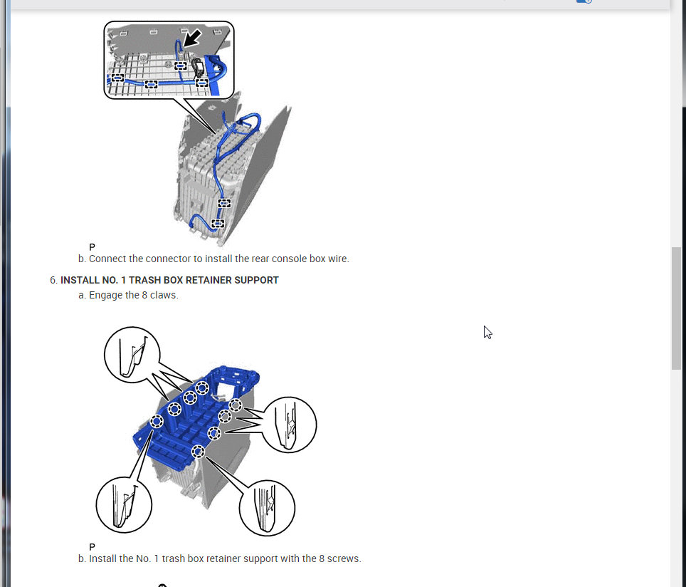

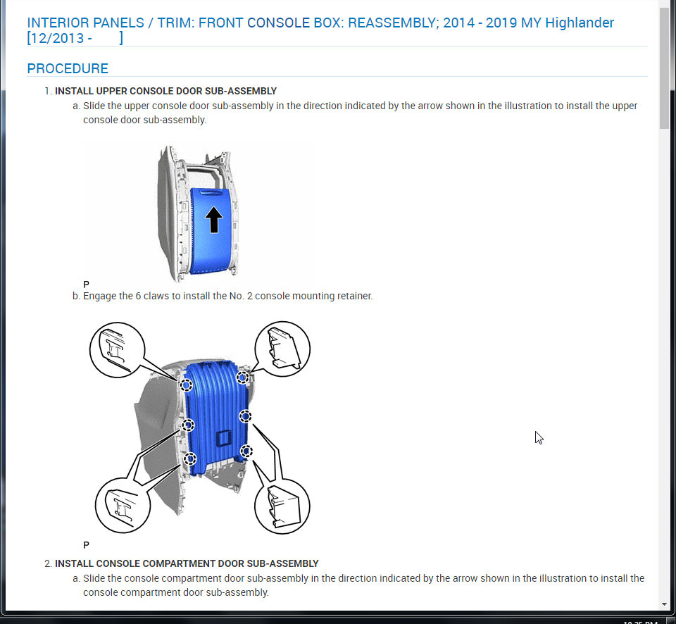

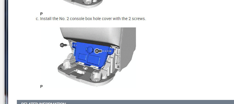

I put my credit card in the center console and it got caught in the bottom rolling lid and fell down to the bottom of console. I took it apart and was able to get the card out but now I can't get the lid back on.
Jan 12, 2020 at 5:43 PM
I am attaching the entire process below on this console. Please review this material and let us know if there are questions. Check out the diagrams (below). Please let us know if you need anything else to get the problem fixed.
Thanks
