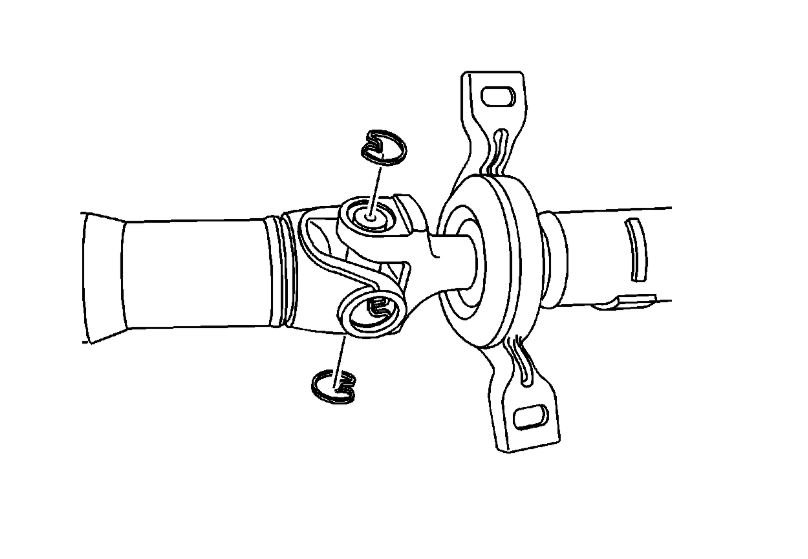

Center carrier bearing replaced
2005 CHEVROLET EQUINOX
180,000 MILES • 4WD
DLANDRUM
I replaced the center carrier bearing and now there is a knocking coming from it. I had the bearing itself pressed on but not sure if the u-joint needs to be pressed on and if that is causing the noise?
Jun 13, 2018 at 5:10 AM
Good afternoon.
If the bearing was pressed on correctly and the flange installed and torqued correctly, the only other thing is the u joint. Was that replaced as well?
Jun 13, 2018 at 6:21 AM
DLANDRUM
Yes, that was replaced also, but was not machine pressed.
Jun 13, 2018 at 6:32 AM
It is possible that it is the issue. Did you return to the shop and have them recheck there work?
There are two more u joints as well. They will need to be checked.
Jun 13, 2018 at 6:49 AM
DLANDRUM
No I have not, but will remove the drive shaft and have the u-joints machined on and then replace it as one piece and then I will let you know. Thanks
Jun 13, 2018 at 7:19 AM
Sounds like a plan. Keep us updated.
