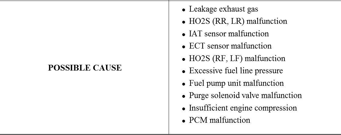

KHLOW2008
  • 41,812 POSTS
The chart shows possible causes for the codes concerned and since the problem started after replacement of the air filter, I would start rechecking all those aroubnd the area first.
