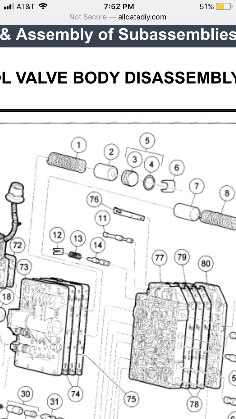

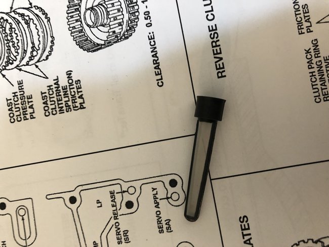

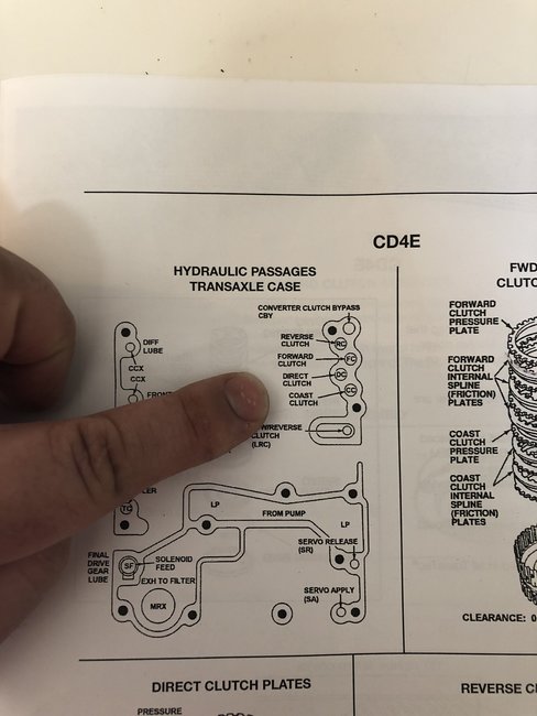

First two pictures I’m trying to find which port this filter (in second picture) went into? It fell out upper right of where my finger is pointing. is it necessary for this cone filter to go back in?
Another thing I need help identifying a part # in third picture (#4 seal) for accumulator main control. I’ve had hard time matching up the o-ring for correct size.

The part is a inline filter. can you look for wear marks inside the ports? it should have left a mark inside the port it fell out of. We don't have anything that shows that filter. is it in the case or valve body?
May 26, 2019 at 6:46 AM
MR.HONDA24
  • 39 POSTS
I think it may have fell out of the converter clutch bypass, not from valve body.
