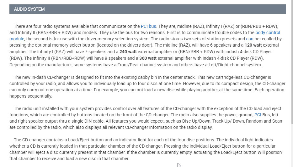

I just bought the car listed above ES model. The lights for my 4 disc CD player constantly flashes and accepts the CD's but doesn't play them and would not eject them. Can anyone tell me what to do please.
Apr 22, 2020 at 12:22 PM

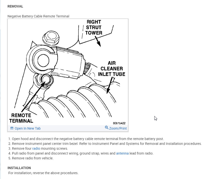

I attached the info about this system. Basically the CD changer only controls the loading and ejecting of the CDs. The radio controls all other functions. This means you may have an issue with both the radio and CD changer if it will not play them or eject them.
If it were me, I would replace the CD changer due to them not ejecting and then see if it fixes the not playing issue as well. If not, then you will need a radio as well.
Let me know if you have questions. Thanks
