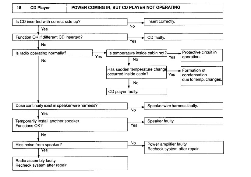

There's a little piece of metal blocking the inside of the CD player I can push it up with a card but it tells me loader is full and when I push eject I can hear the motor trying to eject so it does work.

In the diagrams down below I have included a factory diagnostic troubleshooting flowchart for your vehicle's CD Player. Please go through this guide and get back to us with what you are able to find out.
