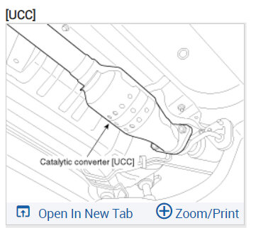

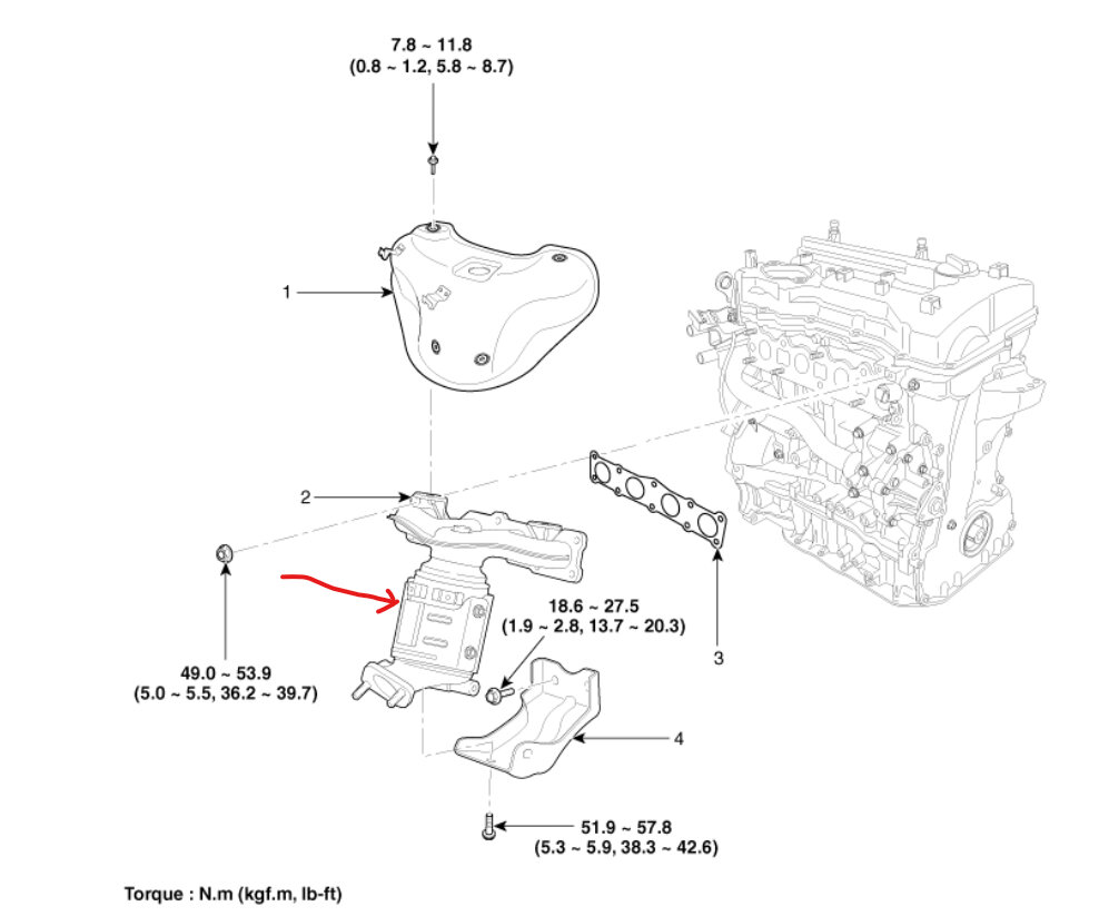

How many catalytic converters do i have and where are they?
Mar 4, 2024 at 11:34 PM
  • 55,721 POSTS
Sure, there are two catalytic converters on your car. One is in the exhaust manifold and the other is under the car about in the middle. Here are images of them so you can see. Check out the images (below). Please let us know what happens.
